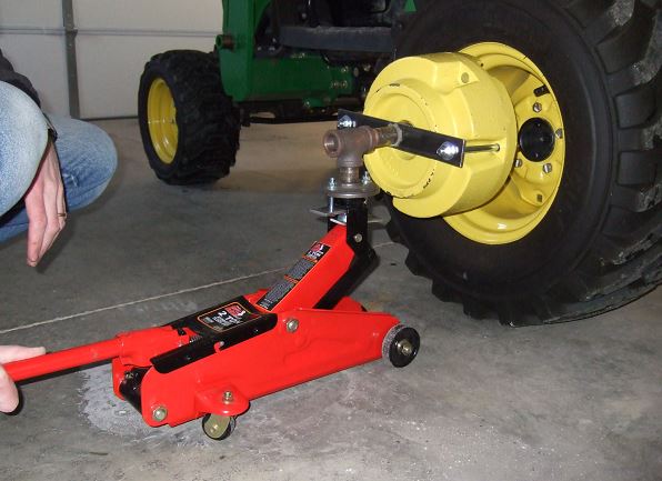

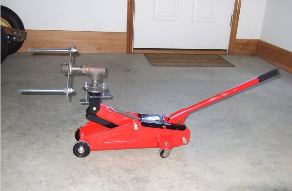

Found this thread when doing an image search: https://www.tractorbynet.com/forums/attachments/133283-installing-wheel-weights-conveniently.html
If you put down some plywood it would work on your raw land.
