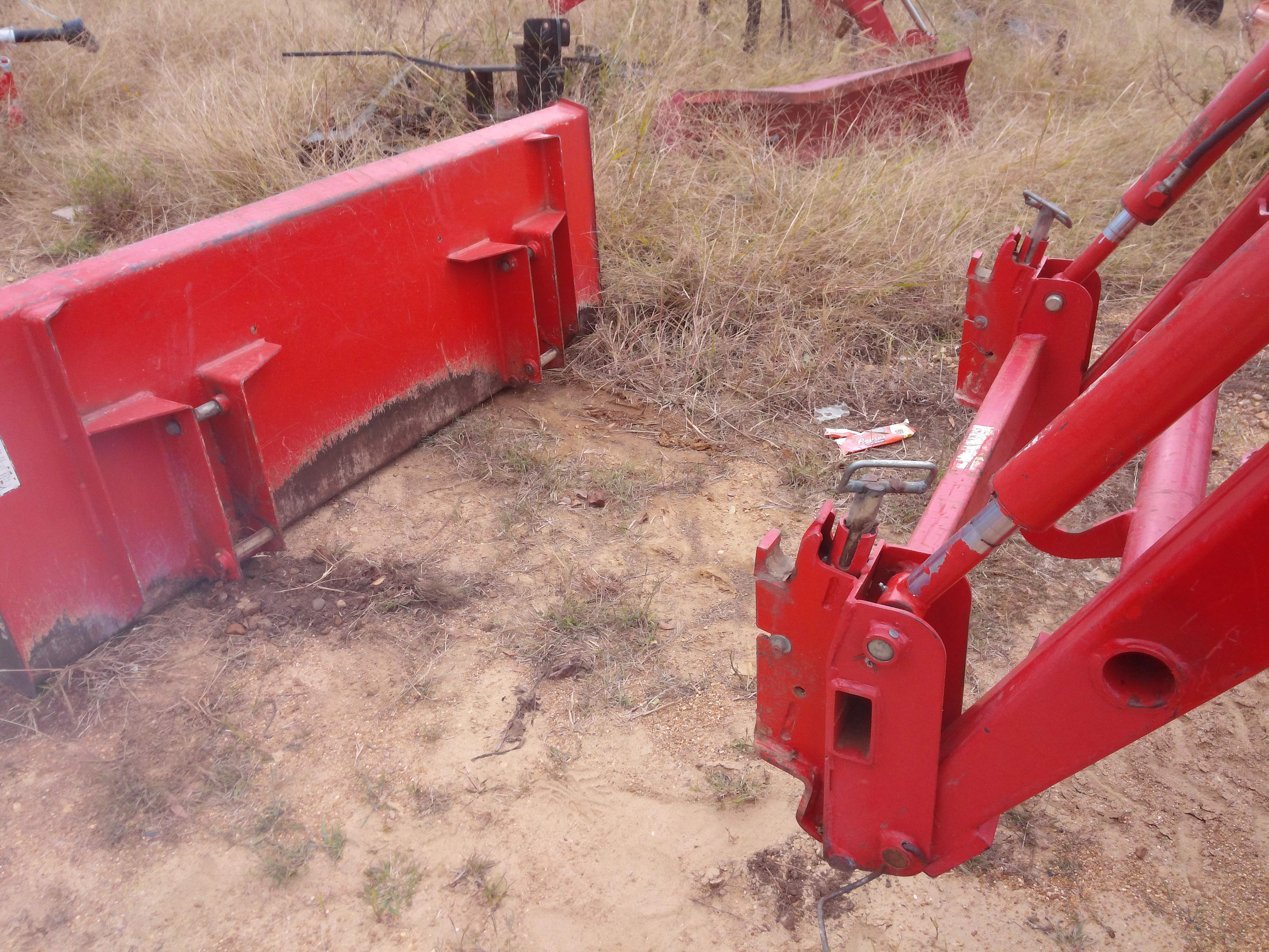

I want to replace my pin on bucket with a skid steer quick attach adapter. I have the Great Bend ML264 loader. Tractor is a 5500 4wd.
Where did you get yours and how much?

The 5500 I just bought has the Mahindra QA instead of the SSQA The dealer has some forks and hay spears he bought from Mahindra at a discount on his lot. Lot of it is for 265 loader. My Great Bend is a 264.
Not much out there will fit up to the Mahindra QA that is not universal (adjustable to different widths and pin spacing) as the SSQA is the new standard.
Lots of SSQA that are universal that will fit the Great Bend. Bushog is not going to help you much with the older GB Loaders. I would get a universal and then you are SSQA ready.

The 5500 I just bought has the Mahindra QA instead of the SSQA. The dealer has some forks and hay spears he bought from Mahindra at a discount on his lot. Most of it is for 265 loader. My Great Bend is a 264.
Lots of SSQA that are universal that will fit the Great Bend. Bushog is not going to help you much with the older GB Loaders (I asked!!). I would get a universal and then you are SSQA ready.
Did you purchase one? I see a few available for close to a grand, some over that. Seems like a high price to pay for an adapter.
