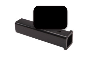

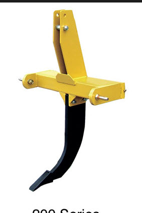

I have a heavy duty single shank subsoiler/ripper that has a removable shank. Im thinking of removing the shank when not needed, and on the top of a reciever, weld up the same thickness of steel as the shank and bolt it in, thus giving me a way to have a 3 point receiver. This should work... Right? Any downsides?

What is the brand on your subsoil plow, I like it from what I see.

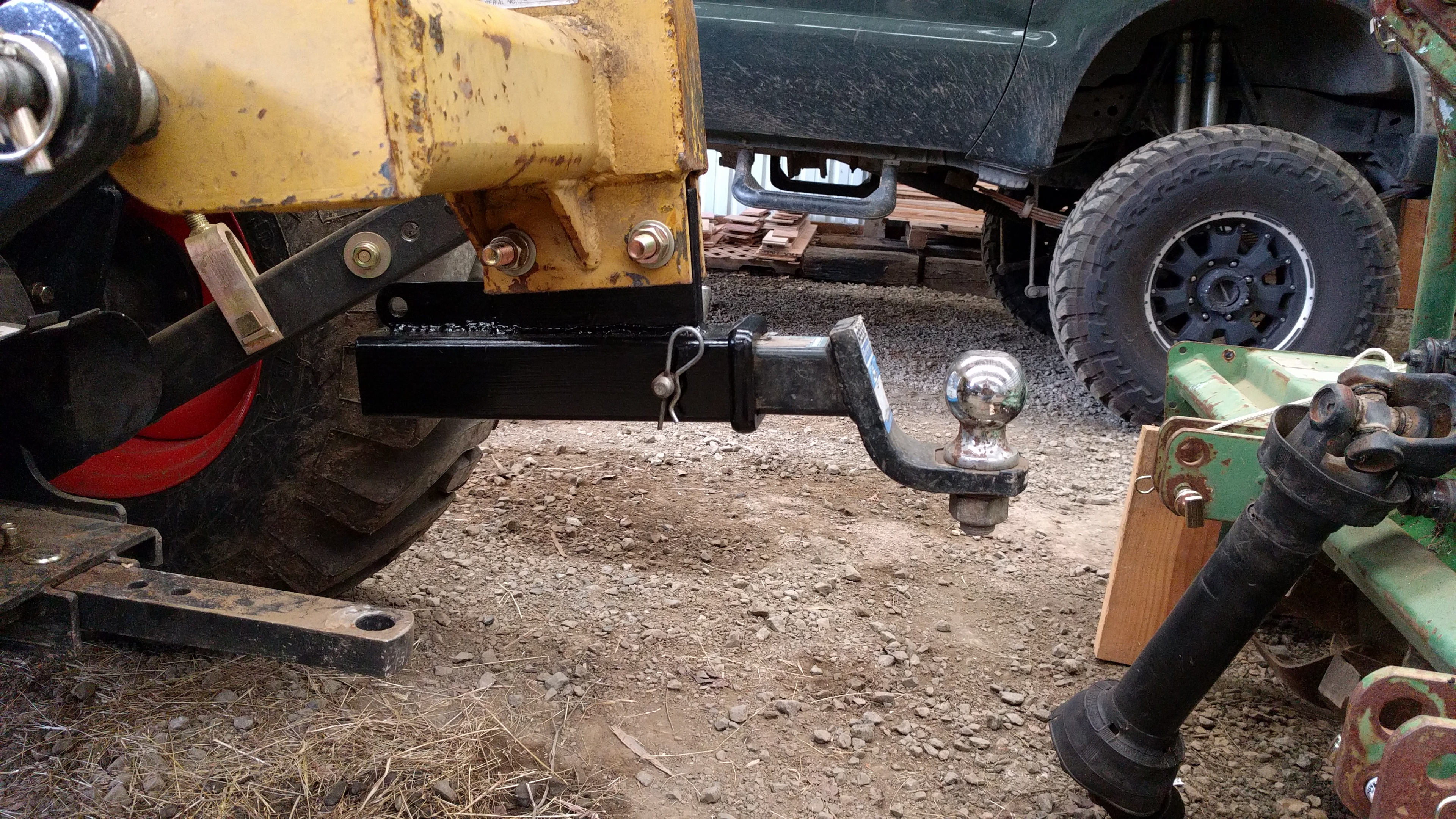

I got this little project complete. Very happy with it, I purchased the receiver and used some 1" scrap. Maybe would work well for others with a ripper that have a removable shank.
