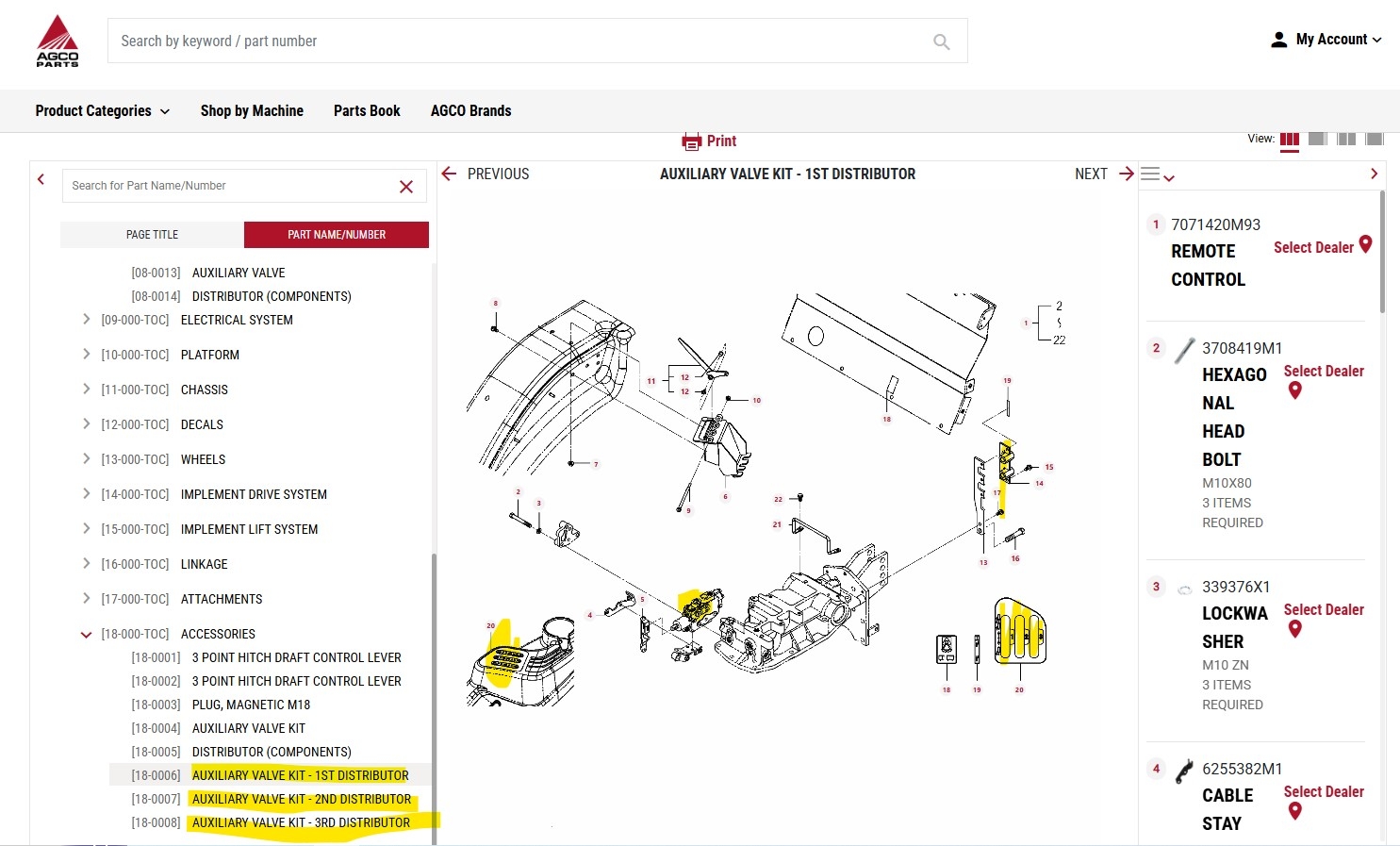

I have a 2860e with a FEL. I would like to add rear remotes which it does not have. Any suggestions about the process and thoughts on the cost? Thank you!

A number of theories on that subject, and you're sure to hear a few. Suggestions will follow, but the decision is yours. It will depend on what's available for that model OEM wise, your skills and abilities, what you expect the finished product to look like, (aesthetics vs function) and of course, budget. Factory remote packages can run $500 to $800 on up to $2500 to $2800. Not familiar with a 2860e so I have no price quotes to share. I can state that if I were doing it, it would not be OEM parts, and would probably come in around $500 to $700 for a single double acting valve with a pair of breakaway couplers. I would not go with any solenoid valves, but again, your choice.
   / Add Rear Remotes #4
I hope you didn't buy it new, try to save money and now decide you want them. That is an expensive mistake. Looking at others it seems 1 remote is about standard so where they are plumbed in on the tractor is your starting point. Your going to need the parts diagram as the starting point. From there build to suit.

So the parts book shows that up to 3 OEM remotes can be installed on this tractor. Cleanest way to go. Looks like it may be relatively cheaper way to go too. From the parts book:
This kit on Amazon may be the kit for your tractor: Amazon.com
Best to ask the dealer
