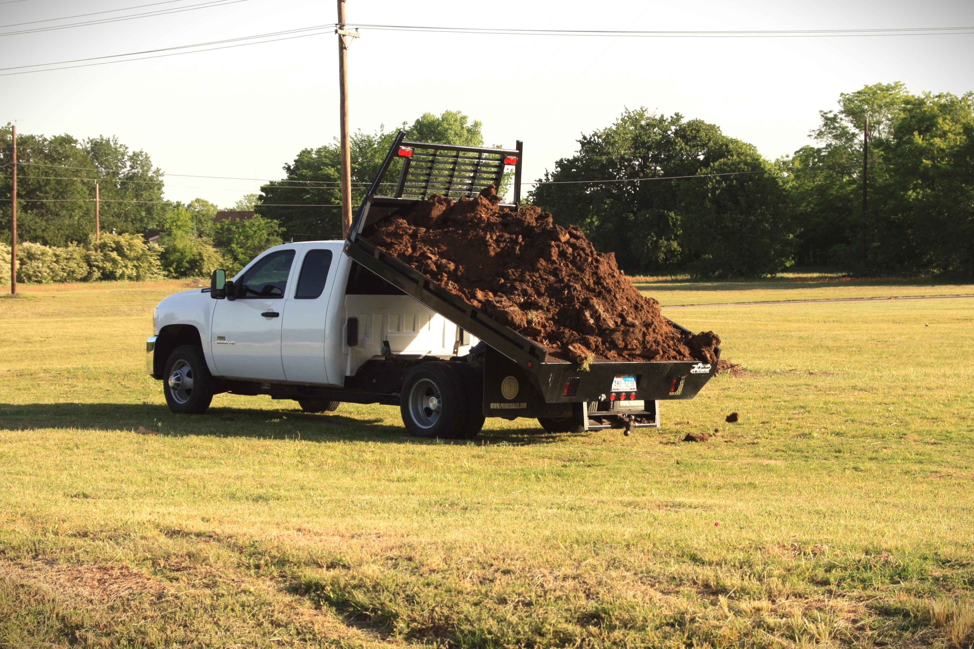

You might find some ideas looking at insert dump beds for pickups.
Here's one:
...and look at pickup dump bed conversion hardware and framing, ignoring the parts that don't fit your project.
