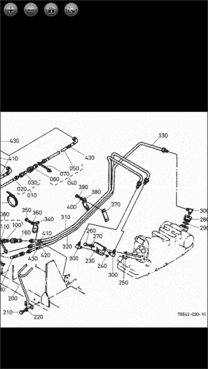

I'm adding a aftermarket loader to a kubota l2350 the loader vavle has three lines. On the parts breakdown the return goes to the rearend/tank. But the other go to a block on the rearend ontop the pump pressuree feed. My tractor has power steering with a priority vavle. My concern is since the kubota block ties in in front of the priority vavle wont I lose steering when running the loader? Parts arnt cheap and I dont wanta do it twice

I dont think you will loose steering...rather you may loose some of the hydraulic power that assist you in steering.
You say aftermarket loader, is this an aftermarket valve and plumbing kit too?
   / Add loader to kubota l2350
Yes it's a prince vavle. The pluming kit is what is shown on the breakdown I beleave is a kubota part. I haven't got the block yet I assume it directs all the fluid to the loader vavle and back to the tractor. I don't think it's just a t
