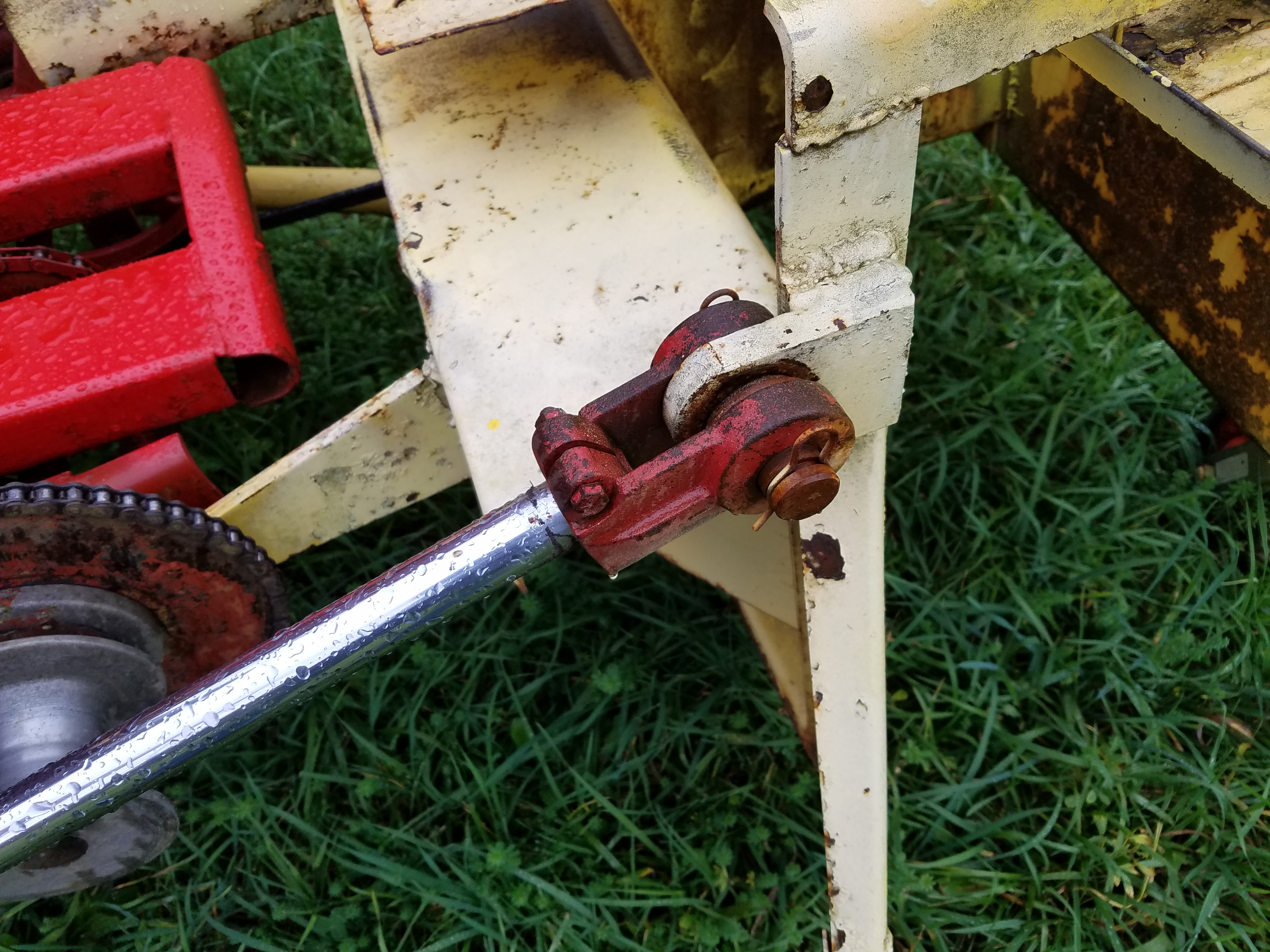

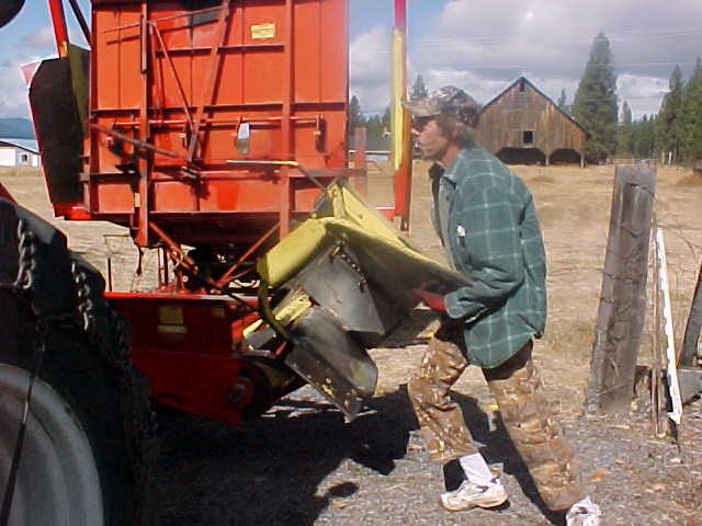

anyway, just acquired a small balewagon, with a broken pulley to
lift and lower the balewagons feed head.. Was wondering if i could
mount a cylinder to raise and lower the feed head from my 5610 ford
tractors hyd controls..i attached a couple of pics..
I currently have to manually do it..getting to heavy after 1 season
thanks if you could help. not sure what to get .. looks like a 24 inch arch swing
can a cylinder make an arc ?
thanks

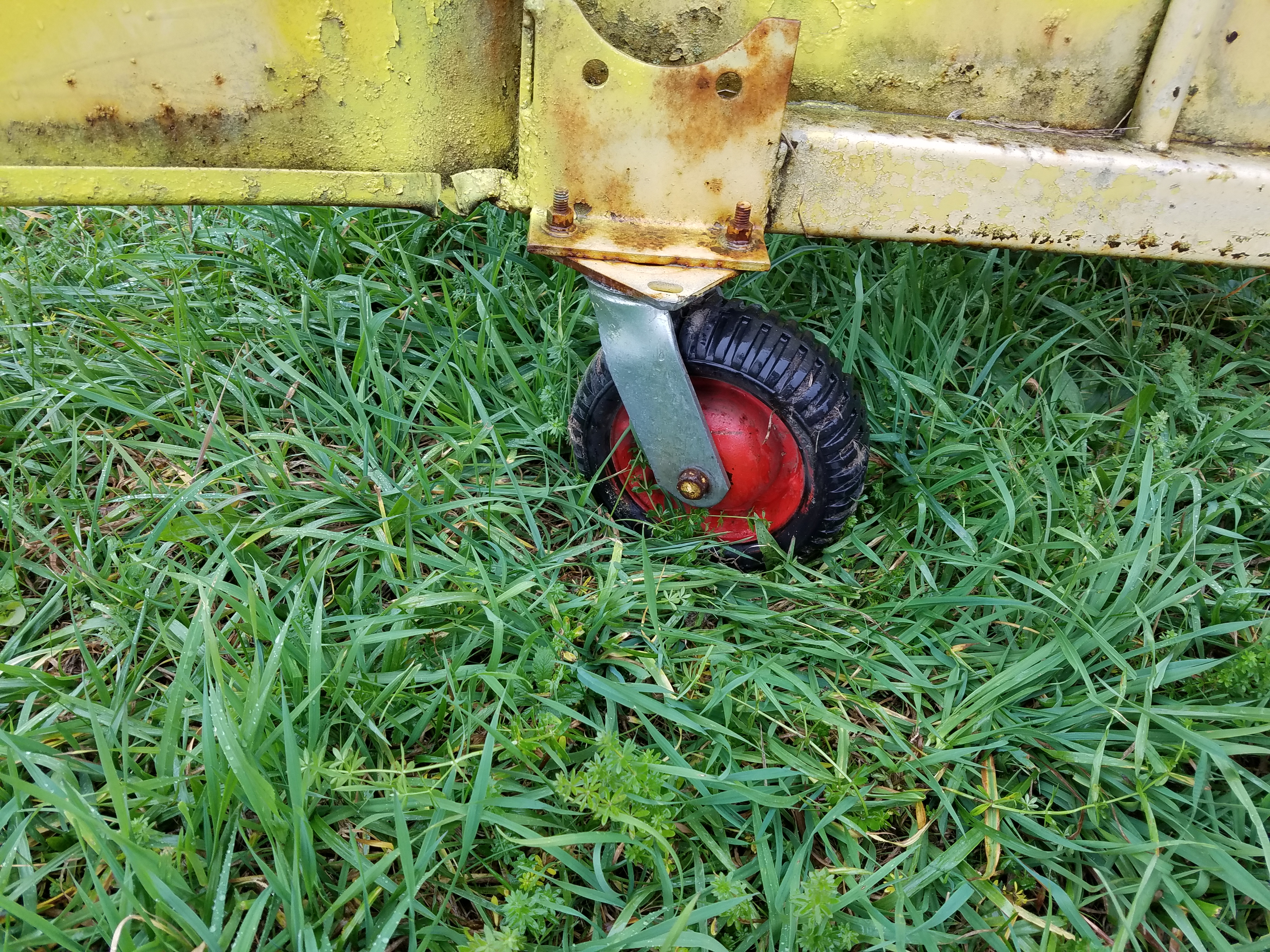

Not a problem. I added a 1 way cylinder to my 1012 and could not live without it. I run it with one of my loader outlets. I also put a caster wheel on the pickup chute so it floats with the ground instead of drop-hanging from the frame.

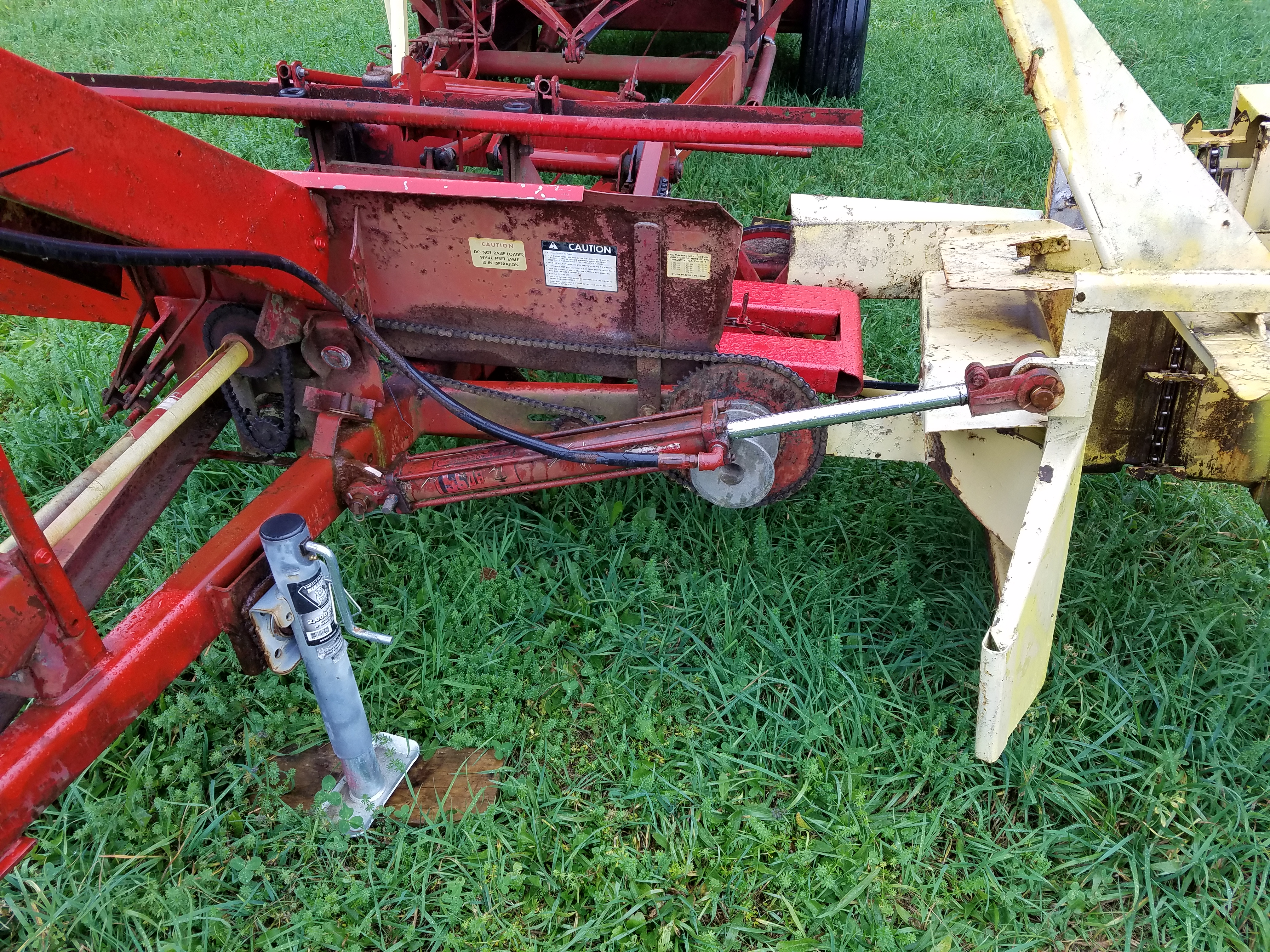

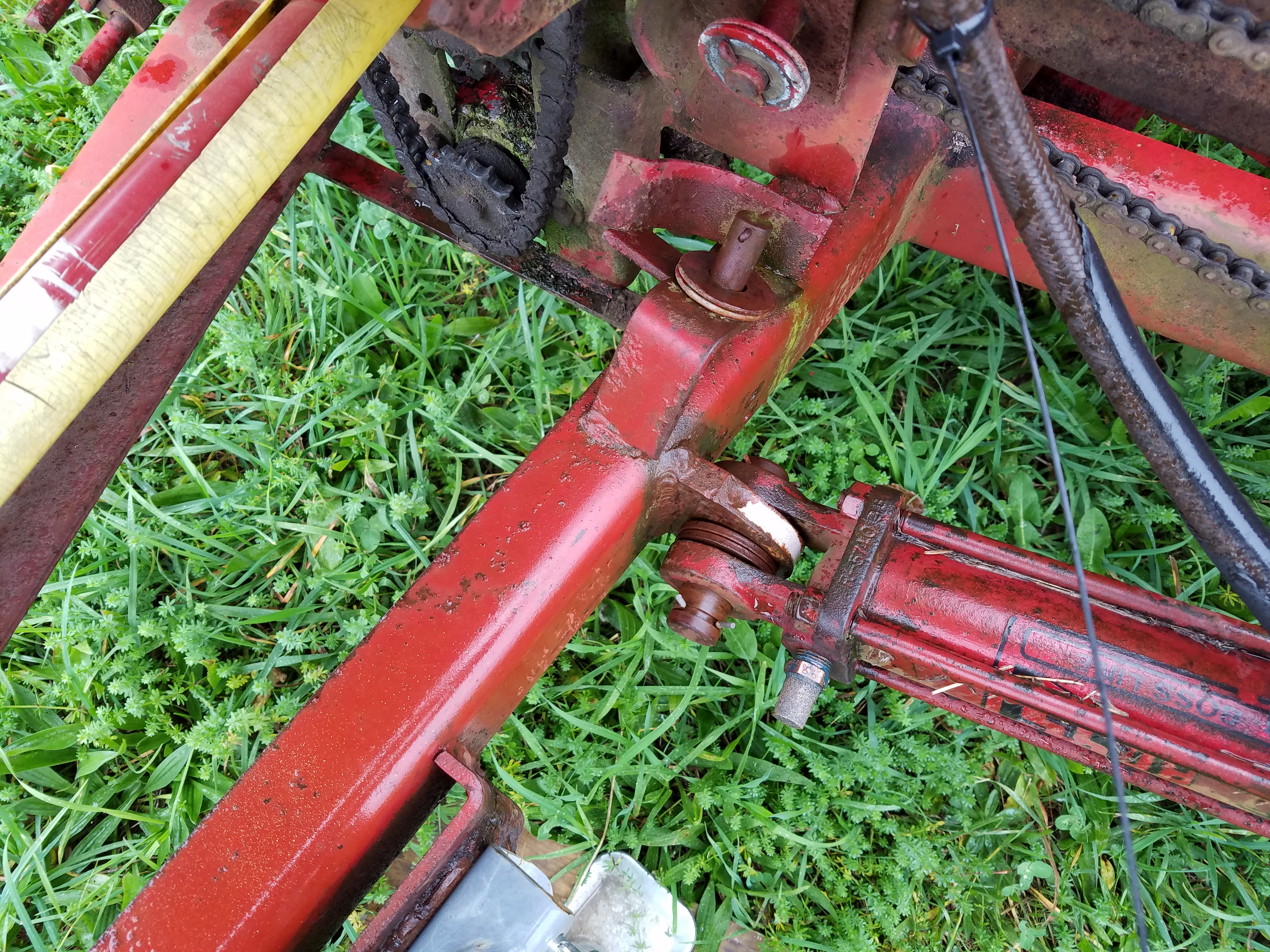

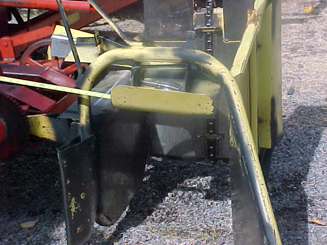

Heres my setup. Lust a plain old 2" cylinder. 1-way (pull). Gravity does the return, so you only need one outlet line.
The caster is also just a simple machinery part. Keep it large enough to keep from digging in and also to keep the chute at a working space off the ground.

I'll have to look to see what stroke the cylinder is. It was a garage sale special. Pressurize the retract side. Ad a breather to the unused opposite end (Don't plug it). I use the 'UP' loader circuit to raise the chute and leave the valve/joystck in float to let the chute ride the ground profile. Gravity is fast. The caster is mounted wherever you can get some structure to hold it. Mine is at the front of the chute just behide the gathering fence.
And words of caution: Don't raise it up and disconnect the cylinder. You will never get the connection back because of the pressure in the line. If you want to store it fully raised to clear gates or keep the cylinder retracted, used a ratchet strap to hold it up, then disconnect the line. Also, don't get caught with the chute up while the first table is cycling, you are gonna bend stuff and break the shear pin in the table lift gear (or worse).
The other use for this feature is to jostle those finicky bales that just don't want to ride the chain onto the first table. Give them a jolt and they free up, all without leaving your seat.
