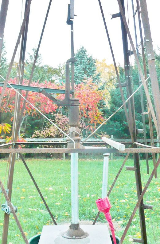

I have a good well on my property run off 220 submerged pump. With all the "attack the grid" talk I was wondering what would it take to add a hand pump.
I think the depth is about 200 feet, and very good water. The pipe and pump wire are in probably a four inch pvc pipe.
How can I do it?
   / Add hand pump to Well #3

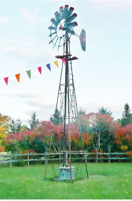

Put a windmill up near it. All you would need is a cylinder, but it depends on how much water you want or need, plus how much wind you have, to avoid a Capture1.JPGCapture3.JPG hand pumping chore.
   / Add hand pump to Well #8
Not much room beside a well pump in 4" casing to put in a hand pump. As was said, hand pumping from 200' is not an easy job. Takes a pretty good size fan on a windmill to turn it. Windmills are good, but expensive and require lots of maintenance. Generator is the way to go, as long as you can find fuel. Thinking about trying to run a generator on wood gas just in case regular gas is not available. Also keep a long rope and a bucket made from a short piece of 3" pipe, in case everything else fails. Been prepping all my life and never had to use any of it. But I sleep well knowing a country boy can survive. :)
