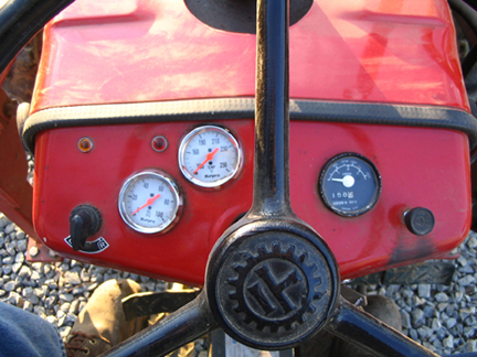

Here is a set of Sunpro gauges that I installed on my 1500D. I had both the oil and temp sending units go bad on me, so I switched over to gauges. Since I do not have a water pump I feel the temp gauge is the way to go. It also lets you know when your tractor has "warmed up". The oil gauge gives you some piece of mine. If you know your tractor runs in a certain range and then drops low, then there is something wrong and needs to be looked at. Basically gives you a heads up verses having an idiot like come on and resulting in you immediately parking the tractor. It is really a matter of preference I guess, if I had a new tractor I would not care, but with a 30 year old recon any forwarning of a problem is well taken. On an important note, the Sunpro gauges that I picked up at advance auto were not water proof. Usually I keep the tractor in the barn, but had it over at a friends moving mulch and it rained on the tractor a couple of times. Gauges still worked but had condensation on the inside of the glass. The other thing is that you will need the metric adapters. Strange thing is that AA does not sell them and the only guy in the area that does charges $14 for the insert! Of course they can be ordered from various suppliers that may be cheaper....
