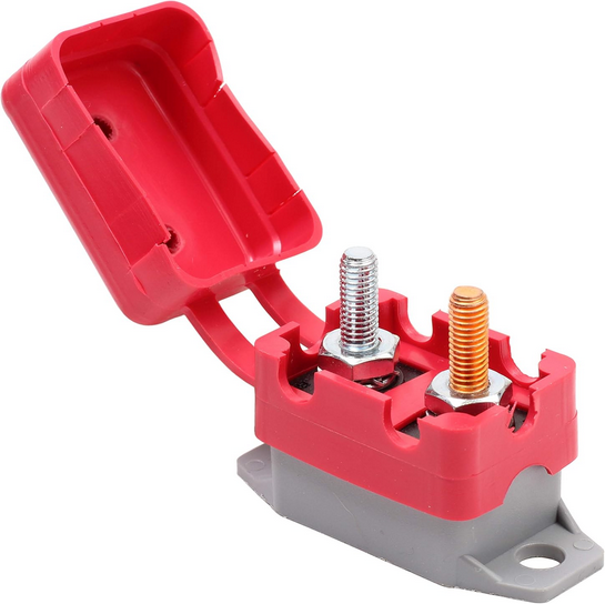

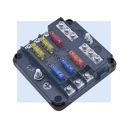

I prefer an additional fuse block fed a main circuit breaker.
