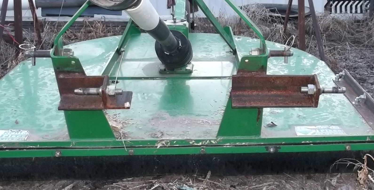

Needless to say the results of my purchase hasn't been what I've wanted. I have a mx6 bushhog and really need to offset it at least 6" and 1' would be better. Does anybody have an idea how to go about this? I've been racking my brain and keep coming up short. I figure on haveing to use a 2nd gearbox

This is what I have done to my mower... I'm not sure if it will work for you... Maybe it will give you some ideas as to what could be done.. The reason for my offset was to have the mower cut outside the right rear tire to get closer to sprinklers and fences etc... Keep in mind the PTO shaft when doing the modification.... Notice the original pins are still useable... something you might consider, if possible..

Do you not have to do anything for the pto shaft? I was thinking going past 5 inches would strain the pto.
Dave that looks good what you did. Yea that should work for me as I'm doing it for the same reason you are. Does your unijoints not bind up?

Now I understand the offset ... I don't believe you have to concern yourself with the pto shaft ... my hay cutters set straight behind the tractor but the pto shaft itself is a good 8-10" offset ... keep those u-joints greased.

I had a small 5 foot mower, I off set so it would mow even with one wheel of the tractor,
I reversed one of the three point pins, (the up rights were flat iron), and then made a extended shaft for the other side, and then made a small bracket to support the rod, it was simple and did not permanently alter the mower in any way, I could mow up to my trees and not leave a unmowed strip where the tire was wider, worked well, I do not think I did any thing with the top link,
