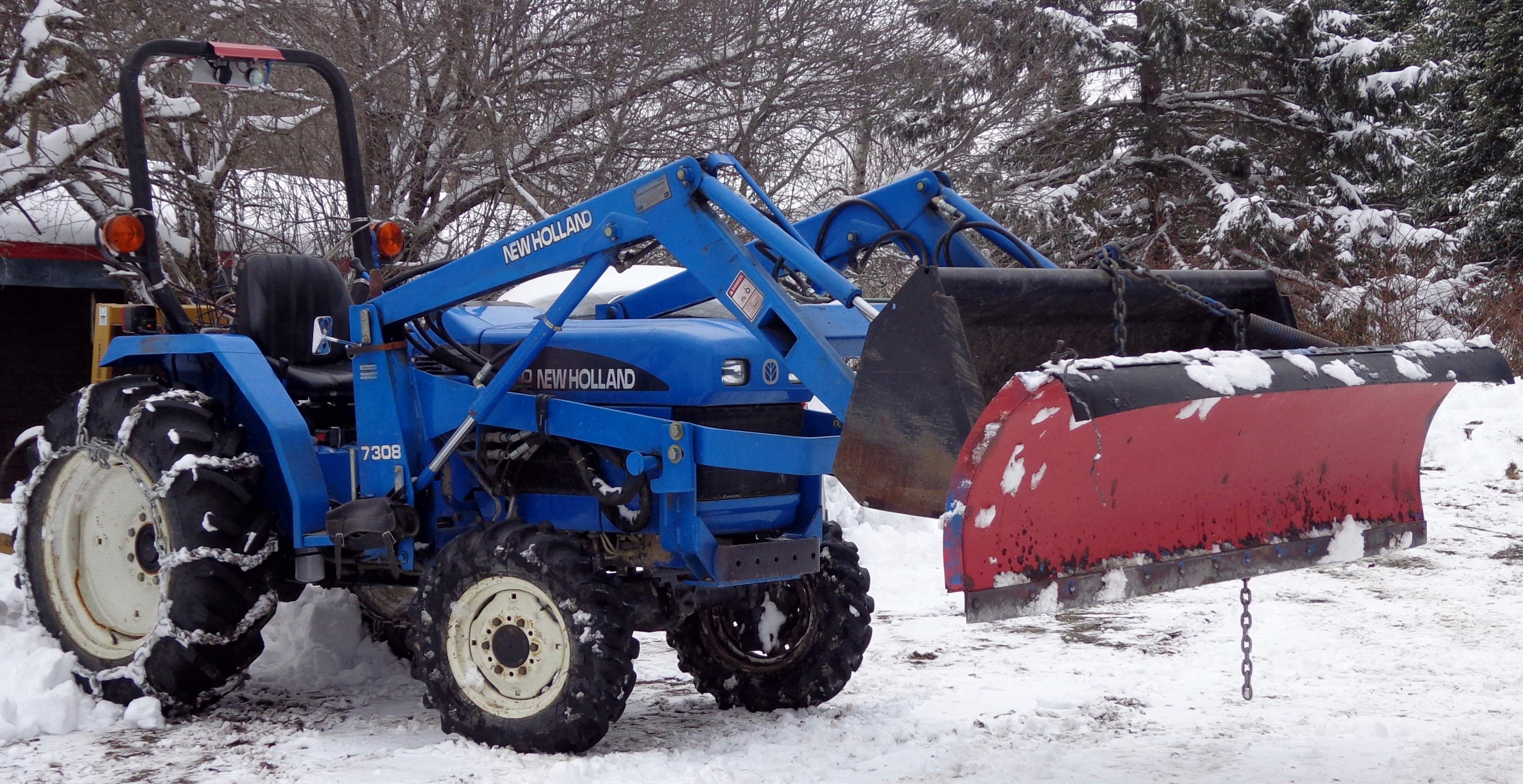

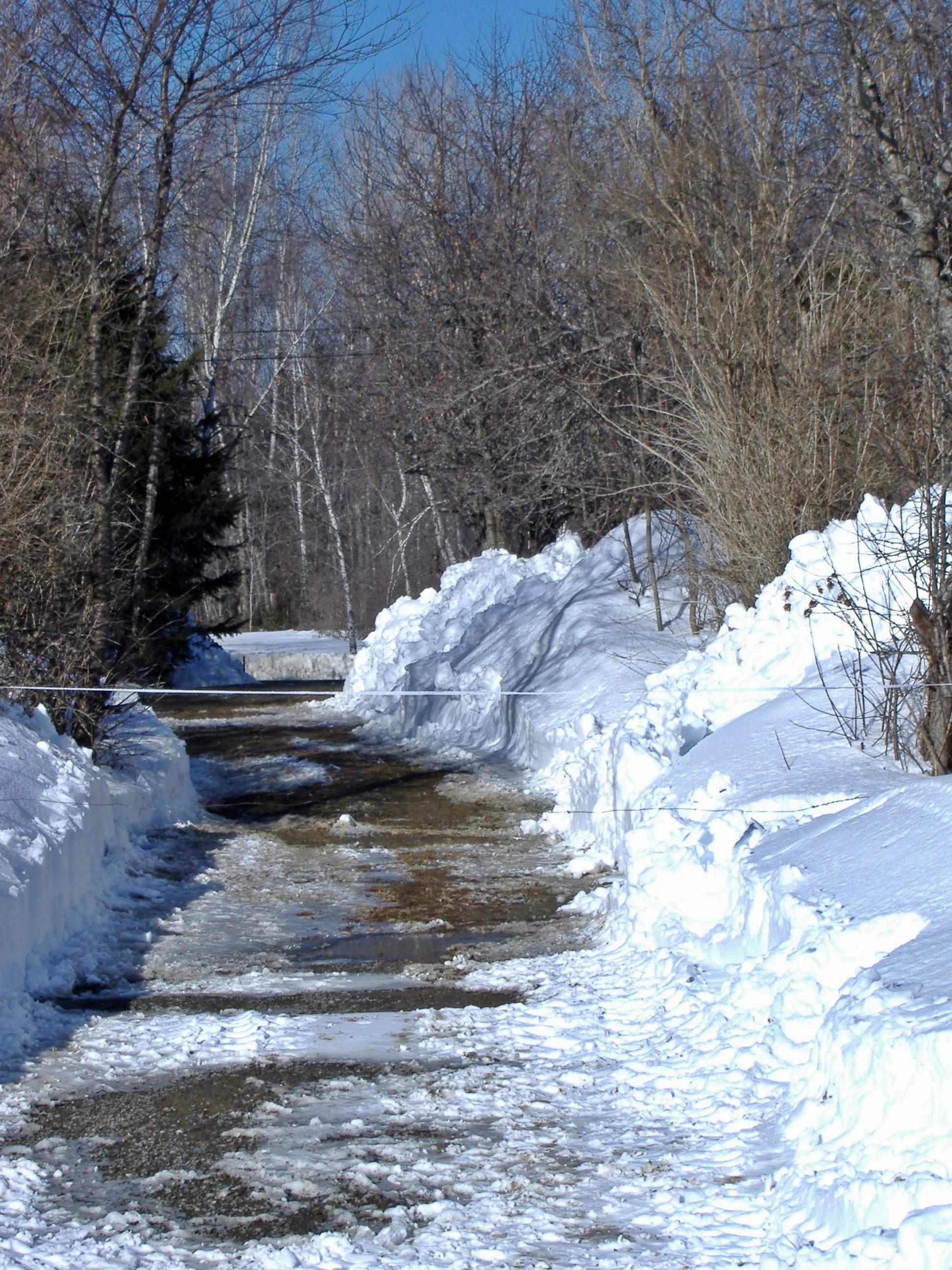

25hp? Maybe a little light to handle pushing a 7.5'blade in deep snow, but that is when you chip away at it! I have a 7' steel plow I mounted straight on to the bucket on my NH TC30. I like it, but I stopped using it and just use the 5' bucket now.
The hassle was that I liked to use the bucket for cleaning stalls and couldn't do it with a plow mounted.
I like the idea of a quick attach plow mount- easier than taking the loader off, and you can push the banks higher at the end of a run. I think you would get more push power the closer your plow was to your tractor, and it would hold the line better. Simple is sometimes the best way to go- and change as you want to.
Chains on the rear and loaded rear tires help a whole lot when the ground gets icy.
