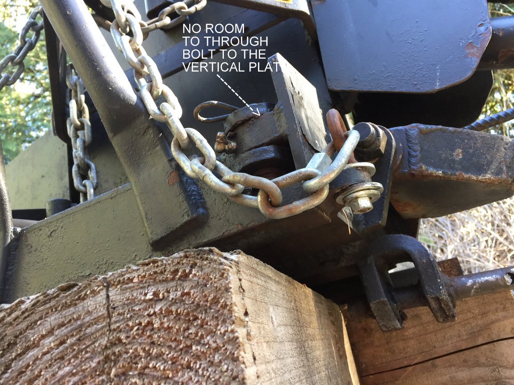

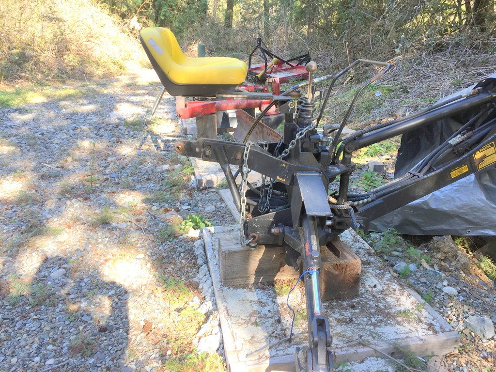

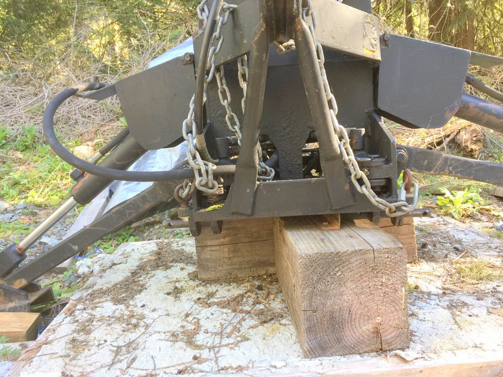

This post will probably come across as vague and foolish, but I hope you will bear with me. I have a history of buying stuff, not dealing with it immediately, and when the time comes it won't work or is defective and already out of warranty. Granted, sounds like a personal problem, which it is. I don't see getting to this effort for a while. Anyway, all I'm asking for is a high-level input as to integrating the BMC three-point backhoe to the Kioti subframe. If it won't work, I want to cancel buying the subframe and sell the backhoe, and figure it out from there (rent, most likely).

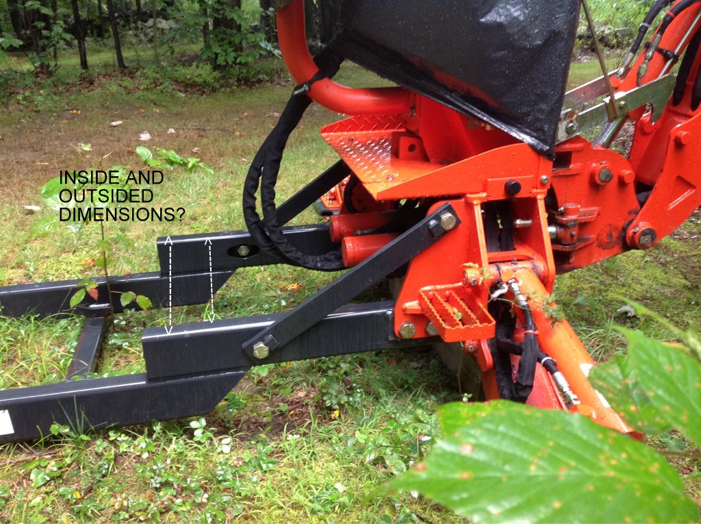

I've purchased the new tractor Kioti CK2610HST and subframe, but they are yet to be delivered. One dealer stated it should be possible to build an adapter to couple the subframe to the backhoe. The white boxes drawn in the photo with the stick are to represent the dimensions requested in the other photo showing the Kioti subframe/backhoe, which the dealer provided. The horizontal dimensions are correct, the vertical are approximations of the box steel cross section. I hope to use the top link connection as well.
I have a Lincoln 175 Plus welder, horizontal cut-off bandsaw, and basic skills. I have a feeling the steel thickness needed for the adapter may exceed my welder's capabilities. If so, I'll have those parts welded by others.

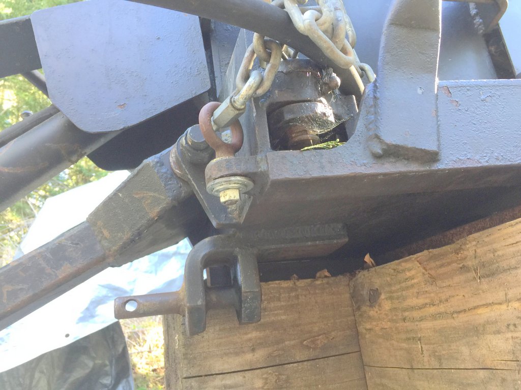

I infer I'll have to cutoff the lifting eyes, and perhaps the three point mounting pins as well. One concern I have is noted in one of the photos. It is that the hydraulic piston mounting bracket prevents through bolting the adapter to the vertical steel plate as is done on the Kioti backhoe.
Question: Do you see issues from what you see that would prevent you from fabricating an adapter to make this work?
