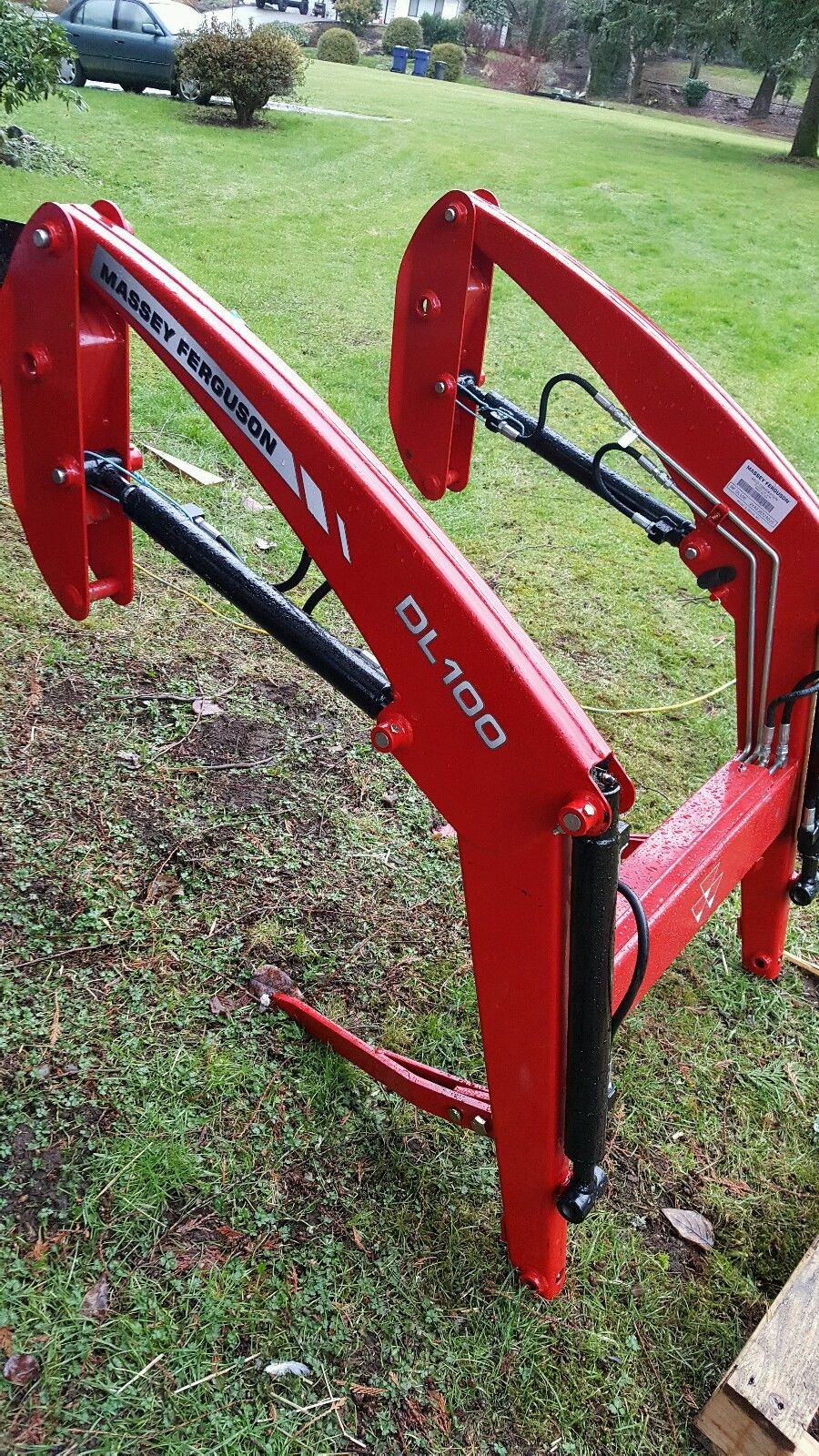

Hey guys I have an Old 1994 B7100HST 4x4 runs and works great just no FEL so after searching high and low for one built specifically for it I finally gave up, but came across a set of D100 loader arms that are brand new just no mount. joystick or bucket.
I went ahead and bought them and they are the right width for my tractor but I need to fab some mounts and a bucket for it so I am looking for plans for a bucket that is 48" wide like the oem bucket does anyone have one the can give me the specs for or a idea of the length to depth to height ratio if there is one? here is a pic of the arms.
Thanks

I also just realized I identified the loader arms wrong they are massey dl100 Arms

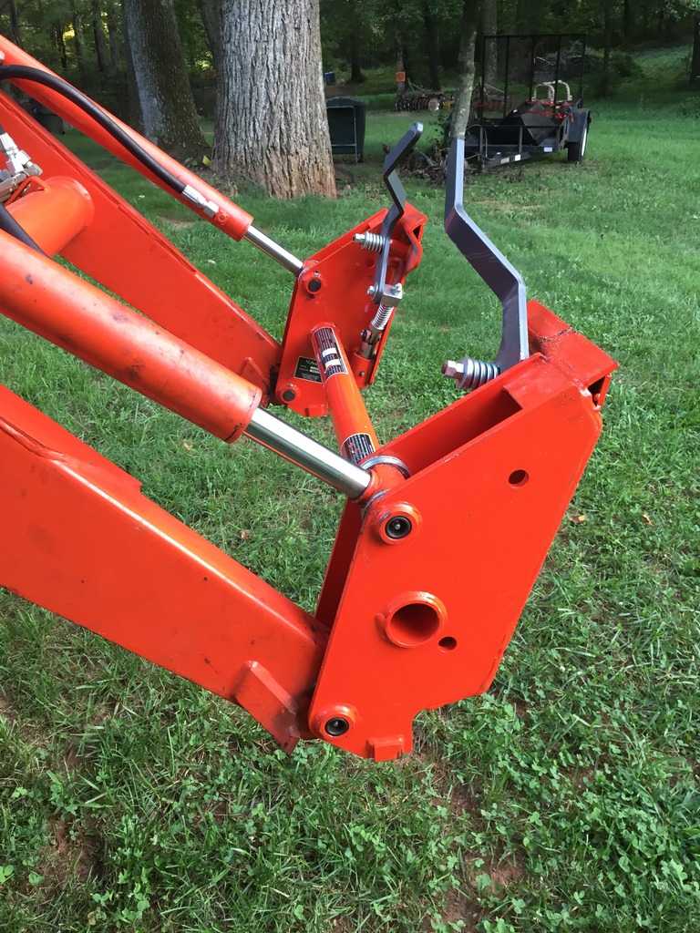

I've got a B7100 with a Kubota B219 loader in Bellingham. You're welcome to come have a look and measure it up or pattern from it.
The subframe is pretty straightforward. It attaches to a couple of the the rear axle housing bolts and to the engine block.

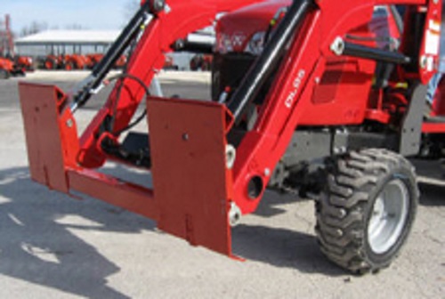

Now is the time to put a Quick Attach on the loader arms. Call Wiko and Everything Attachments
Then a bucket, pallet forks and a grapple will be easy to find. :thumbsup:

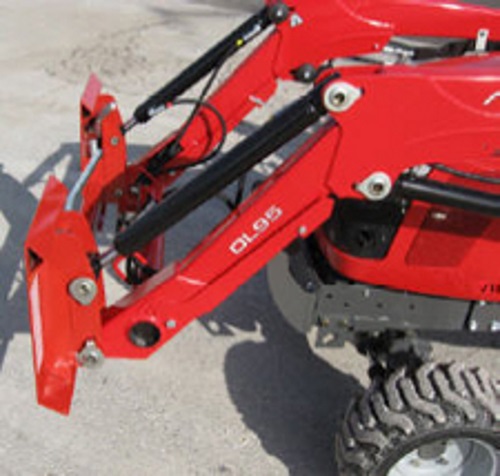

From the Wiko Website:
Model 835125: Adapter plate to connect to Massey Ferguson model DL95 loaders, back side of plate pins to loader arms (use your pins, does not include new pins), and the front side of the plate connects to buckets and implments with the skid steer universal quick attach connection, maximum lift capacity of the plate is 1200 lbs., all steel construction, wt. is 83 lbs. and ships by UPS - Price is $610.00 delivered (price includes shipping to locations with normal delivery access in the U.S. continental 48 states; locations in Alaska, Hawaii, and outside the U.S. require additional shipping cost, e-mail us for a freight quotation if needed), item ships by UPS
Don't know if it will fit the DL100.
