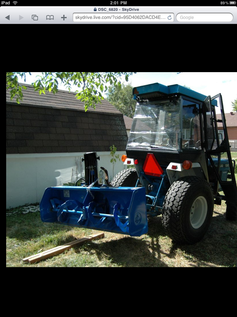

Adapting 836GS SB to NH 1320, need bracket mount points.
The almost new 836GS snowblower arrived and had some fun moving it around
with my "Beetleboom" repurpose of a trailer hitch for '70s VW, but that's another story. *
My current dilemma is fitting the subframe to a NH 1320 frame. *I've mounted the front quick hitch *bracket to the front bumper but I'm unsure at this point if the height is correct as this will undoubtedly affect blower angle of attack.
A front bracket mounting hole height from the ground on a Boomer series (1030 I believe) would be appreciated, but can probably determine once I hang the quick hitch and check the foot angles.
The bolt-on rear frame brackets (long "T" pin receivers) are formed to fit a frame
15 plus inches wide. *The frame (1320) is a little more than 10 inches wide,
so I've surrendered to fabing 2 custom cut 3/8" flat *plates, with shouldered bushings (for the "T" pin) held in place with shaft locking collars. The link tube is only 9" wide so, *no bending required.
Where to mount my custom brackets *to the frame is my next concern.
I'm eyeing the four(x2 L&R) M16 bolts that are spaced approximately*
1-1/2"H X 4-1/4"W. *They appear to be factory installed, and after removing
one, I see the holes are threaded completely, so they must be for mounting
things. *They appear on what looks like a flat boss that is directly above the
steering tie rod, both sides. *I was all over the online parts illustrations and didn't*
see them used or referenced anywhere so I would like some confirmation that my plan to use them is good. *

Mounted subframe to set foot (when level) at 2.5 inches. The 4 Bolts (2 on each side) for the rear subframe brackets
are the 4 rear most engine mount bolts. I'm now on the hunt for four 55mm to replace the 45mm. The drive line extension on the
subframe is the next phase. I have decided to use the last 8 inches of a stainless propeller shaft from a 5 litre race hydroplane.
A pair of chain/sprocket hubs (1" ,1.5") utilizing a 15Tx1"x3" spline coupler in the bigger hub. The prop shat stub will
be keyed to the smaller hub. I'm going to ask my machinist friend to set the coupler up with a shear pin.
   / Adapting 836GS SB to NH 1320, need bracket mount points.
The driveline is complete, and running. A final loctite of the set screws and the chain bolts.
Using three chain segments (3 links each) bolted to the the hubs with six 5/16" bolts, locks
and flats. The chain I used is 423 lbs rated, so I'm confident that the three will together will
hold the 540 in/lbs torque available at full load. In working out what I need for strength noticed
Good designs for fail on couplers is 1.7-1.8 x torque load to handle shock loads. I hope that
It stays together when the going gets tough, but if it doesn't then I'll reassess what the load was
when it failed and determine if chain should be a higher proof or did I overload it with too
big a bite. As long as it all comes apart if ever something gives up and jams up front.
I don't ever want to have to do mid PTO shaft (or worse) replacement of anything in the transmission/diff. Pics to follow.
