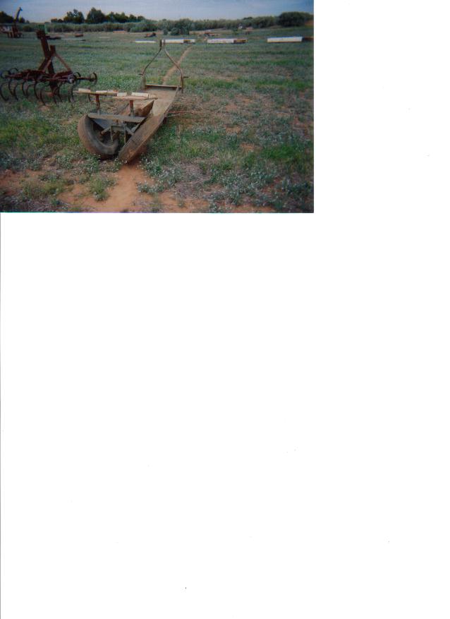

I have spent many days this fall planting acorns, hickory, and walnuts. Doing it like the squirrels do, one at a time. But there must be a mechanical method. I've got about 60 acres of old farm fields that I would like to "replant."
Could a single row corn planter or grain drill be used for this? Ideally, I would like to do this without plowing and discing. I'm thinking of a large coulter wheel and shoe to slit open the soil, deposit the seed, then a wheel to roll over and pack back down. How big of a "seed" can some of these planters handle?
The other idea was to use a subsoiler with a metal elbow. This would require someone walking behind, or to fabricate a seat to ride on, while dropping the "seeds" down a tube to the elbow and into the soil.
Any thoughts or comments are greatly appreciated.

Many years ago i made a 3pl planter. This was used for planting seedlings but there would be no reason why you could not make something based on the same design, basically it is V cutting the ground with press wheels to close the opening maybe add a coulter to the front.

Even if a planter or drill would handle the large seeds (which I don't think they would), I don't think I would do it that way. With that many acres, I would think you would be planting them many feet apart. And not in straight lines.
The subsoiler sounds like a good idea. With a rigid 90 degree tube attached to the rear of the subsoiler and a long flexible tube up to the tractor seat, you could ride around the area periodically lowering the subsoiler, dropping an acorn, hickory, or walnut down the tube, and raising the subsoiler back up. You would not need another person. You could drive in random patterns so that you got a more natural planting.
You probably don't want to plant too deep. I have 3 oaks in my back yard that I planted acorns by just dropping them in cracks in the ground and stepping on them to mash them in. That was in early fall about 10 years ago when the ground was still cracked from a dry summer. Now they are about 12 feet tall. The first 4 or 5 years they don't do too much, but then they take off.

Drills or corn planters won't plant THAT big of seed.
Subsoiler w/ tube would be one way.
A middle buster to open trench up,drop seeds in, then make
something like a V to pull along and pull dirt back into trench.
I've got an extra rear blade now and thought about cutting in 2 pcs.
then make V shape w/ center open to fill trenches back in after
trencher work.
