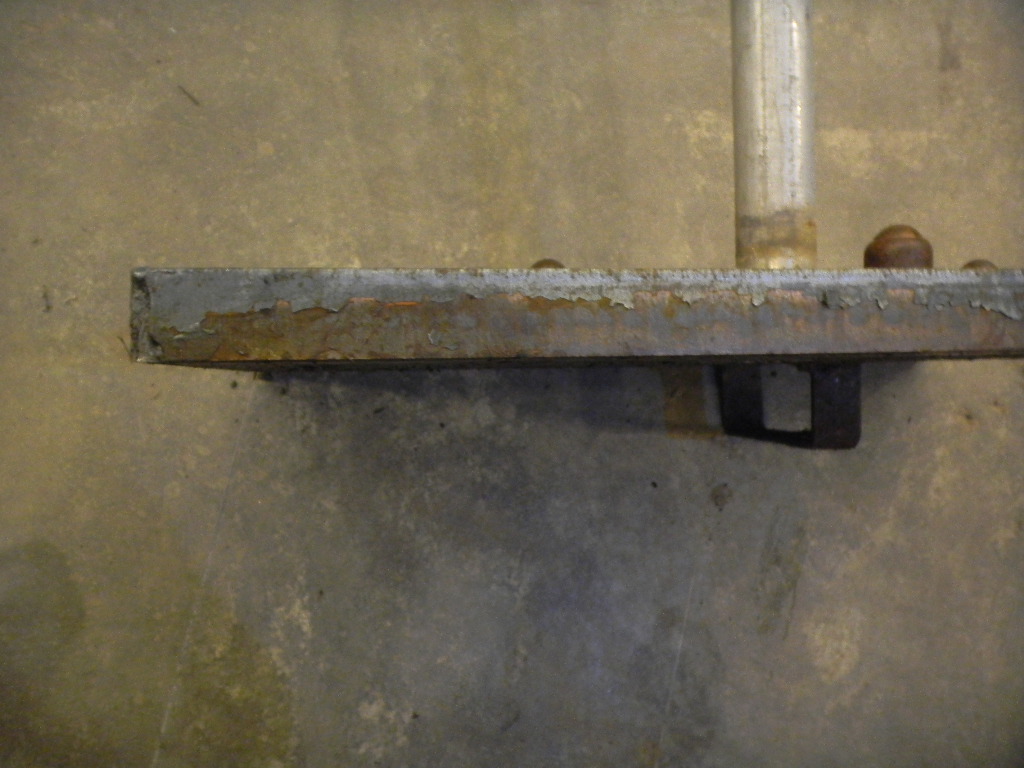

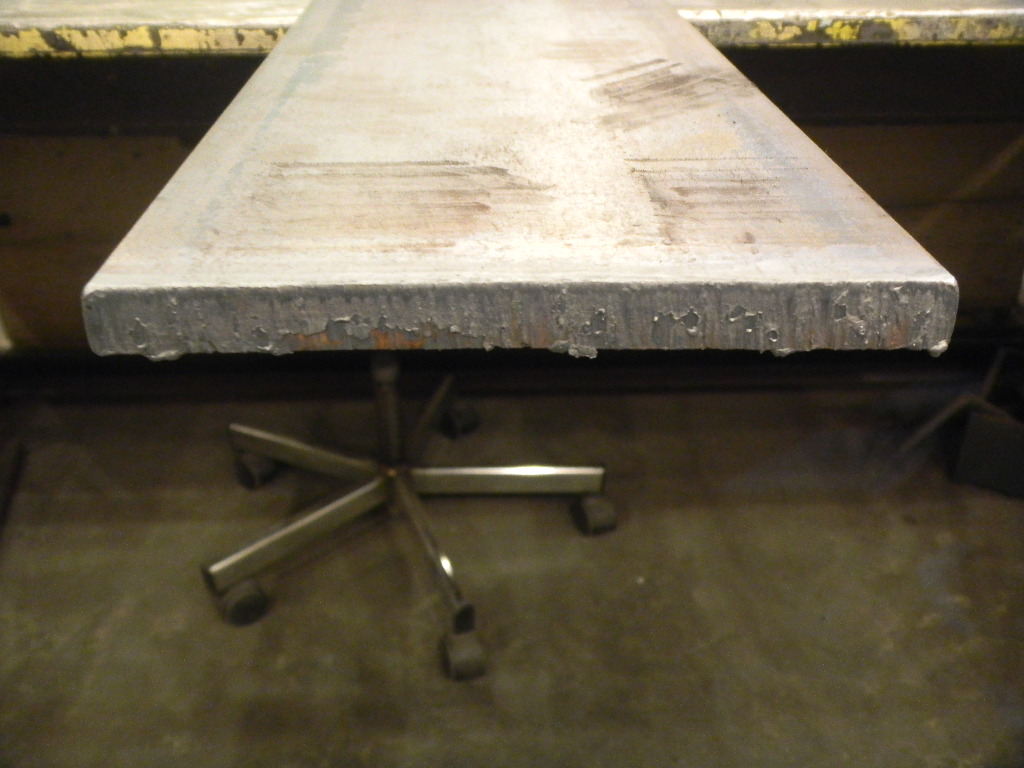

I just switched over to propane last summer. I hadn't used it since the mid 1980s working on a joint venture project where the other contractor was the sponsor. In my opinion it cuts just a little slower, and takes just a few seconds longer to pre heat. But it does make for some nice cuts.
Here is a great video about cutting with propane.
A picture of a cut I made on 3/8-inch flatbar, and 1-inch plate.

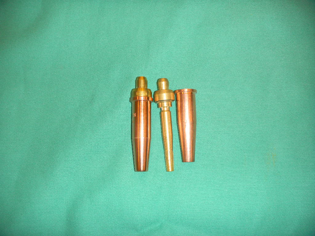

Here's what the propane tips look like that I use on my Victor torch.

Victor makes anice 1pc propane tip too. I cut with Propane or Propylene and save my acetylene for brazing. Usually with Propane or Propylene, They cost the same as Acetylene but last 3 X longer. Big savings if all you do is heat and cut. I will say, of all the alternate fuel gas conversions I have done over the years, For some reason all those folks end up back with Acetylene. It's one of the welding worlds greates mysteries..

So I got that set (Smiths Toughcut lower level line). The guy said that the only real difference was the type T hose (You can use type R in a pinch but it supposedly breaks down in a shortish time) and the tips were made from brass instead of copper (ont he acet rigs) as the flame threw more BTUs near the tip, so they needed to be brass for a bit more heat resistance. He might have been full of it on that last one, but, they were indeed brass vs copper on the same set that was spec'd for acetylene.
