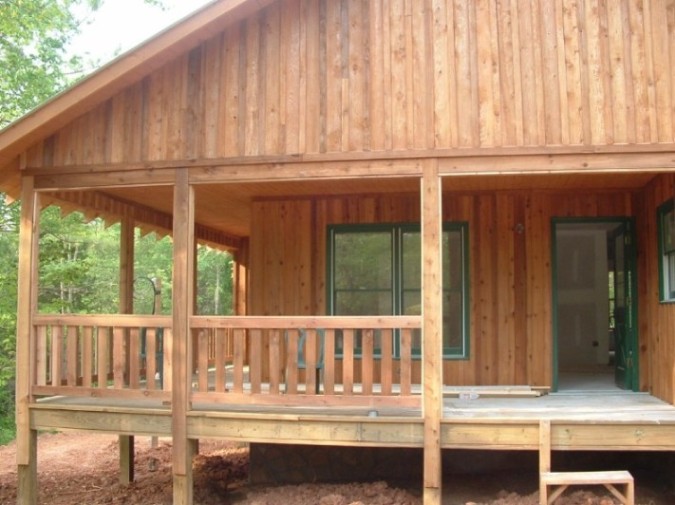

I would also nail it with 6d ring shank stainless nails. Galvinized has some kind of chemical reaction to Cedar and causes some staining around some of the nail heads. I don't know enough about that to give any advise, but someone on here can. Here is a pic of the current house, built in 2006, that has WR Cedar siding. HTH, Later, Nat
