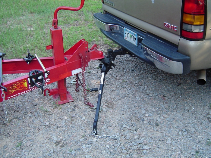

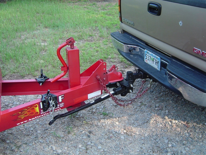

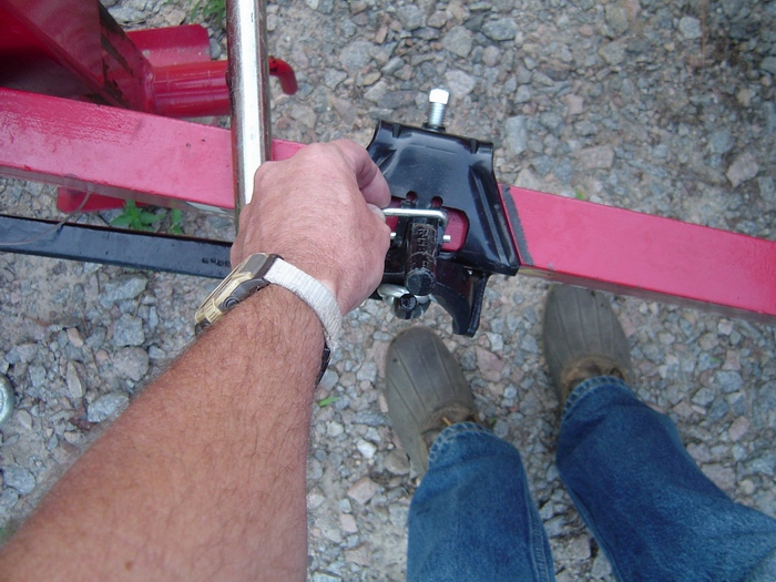

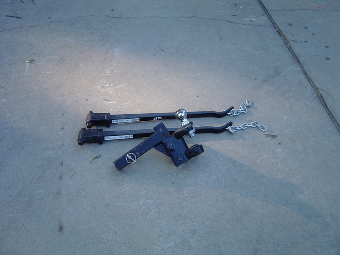

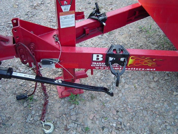

I thought I would post some information about weight distribution hitches. A WDH will allow you to carry a heavier tongue load by spreading the trailer weight more evenly on the truck's frame. The front axle gets more weight, and the truck does not sag in the back. The WDH arms, (with chains), flex and keep the load from sagging from the tongue weight.
1st pic shows most of the parts which goes on the truck.
Ball, shank, WD head, spring arms with chain.
2nd pic shows parts which stays on the trailer tongue.
It just stays there permanent, with light loads I use a regular hitch without the WD shank, head etc.
3rd pic shows getting things assembled on the truck.
4th and 5th pics shows getting things hooked up.
You use a short length of pipe to lift the spring arm chains which attach to the trailer tongue clamps. A lot of tension is on those arms and chains when the trailer jack is cranked off the ground. The chain length is adjustable, and so is the angle of the WD head, (shims), depending on your load and how much weight you want deflected to the front axle.
6th pic, all hooked up.
I hope a few pictures will help in understanding the concept. Questions? Comments? Do any other folks also use a WDH? These things make a world of difference in towing. The RV bunch uses them a lot.

The part that clamps on each of the arms of the trailer tongue should be snug/tight...by tightning a bolt which holds each on the tongue arms. (The parts shown on picture #2 in my pics). Besides, if they are loose and you want to use your trailer without using the WD hitch arrangement they would fall off! I just leave mine on all the time...and tight.
One thing to be aware when figuring your adjustments on your WD hitch, is to make sure your spring arms are lower than your trailer tongue. When you make a sharp turn, the WD spring arms turn also with the trailer. Too short of a chain length on the spring arms will cause the arms to hit the trailer tongue. When I got mine, I played around with it trying different adjustments to figure things out. The instructions don't tell you everything.
