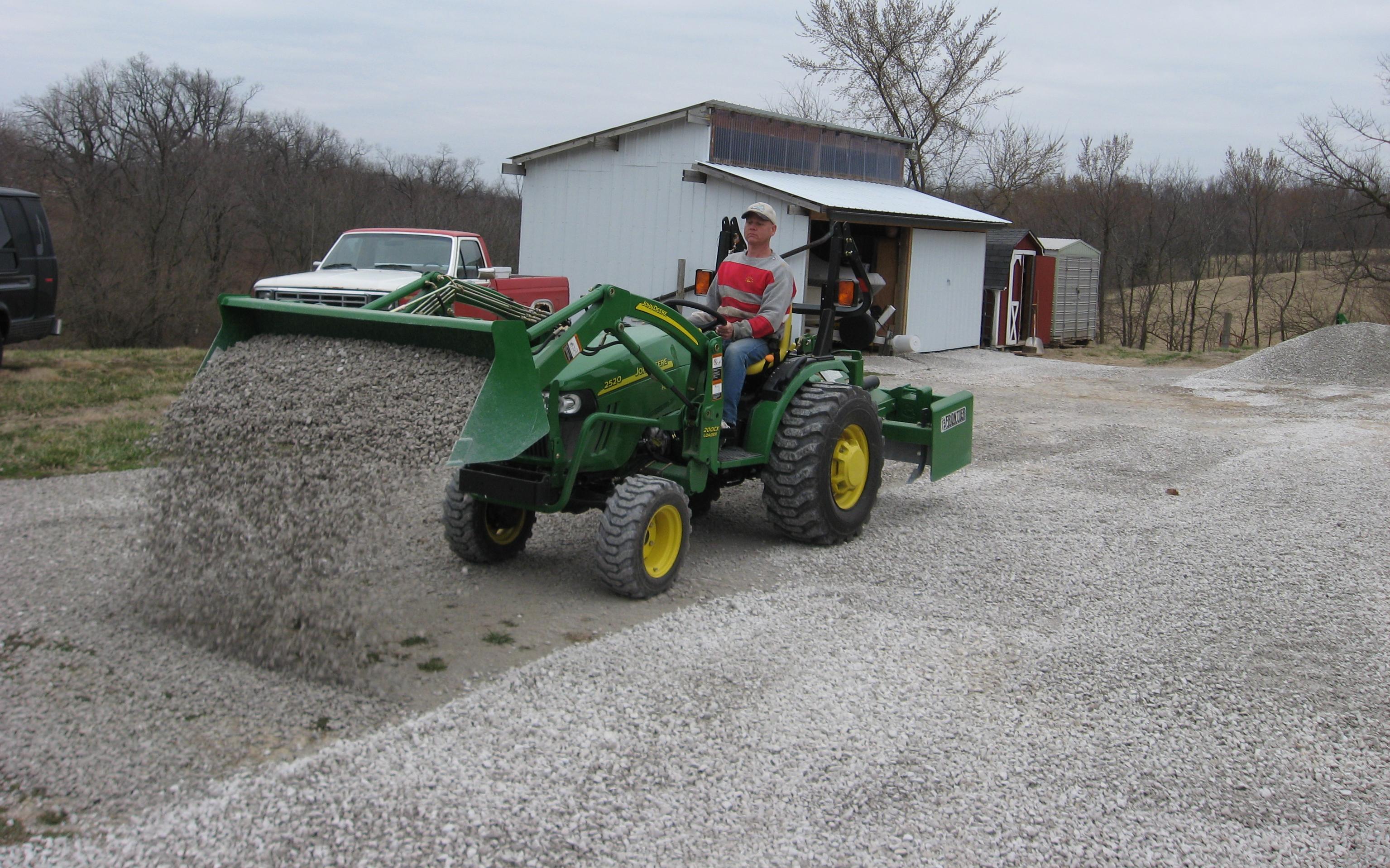

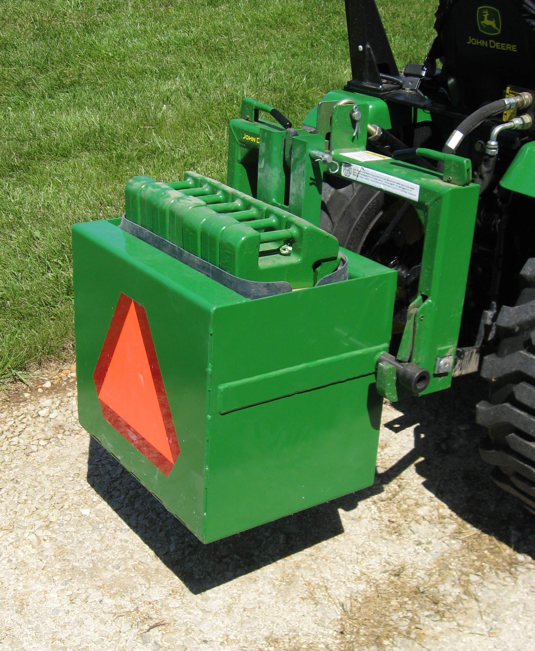

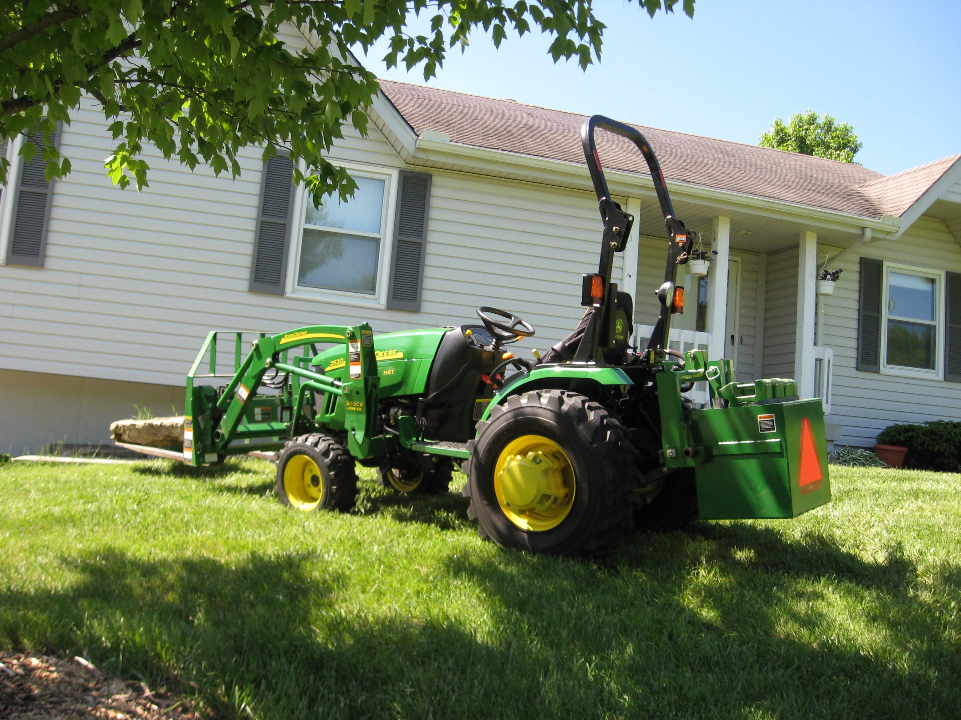

I have a 2520 with 200cx 72 inch RFM, so similar setup to what you propose. When the mower is on the ground, of course, it won't make the front end light. but when you raise it, it will make the front end light.
There are a couple of ways to deal with this. My first thought was a front weight rack, which I have, and works fine when the loader is off. However, most of the time now, I just leave the loader on and drop the bucket off for mowing. This puts plenty of weight on the front end and doesn't seem to be too hard on the lawn.
As for the rear counterbalance weight, you can use the box blade, but it really isn't heavy enough. As mentioned, I have the front weight rack and I sometimes use four of the weights hung on my 60 inch box blade for rear weight when using the loader.
However, I would still recommend getting a ballast box because you can get a lot more weight in there and it takes up less space than either the mower or the box blade. I also have my ballast box set up so I can store/use my front weights in there when needed. This has worked out VERY well for me.
As for using the mower for counterbalance, my RFM weighs a LOT more than my box blade, even with the weights on it, so I often use my RFM as counter weight when not operating in tight quarters.

All the above being said, if all I had was an acre of finish mowing and I wasn't going to be doing anything too heavy-duty with the loader, I'd probably be looking at a 2305/1026R with belly mower. If I didn't have hills and didn't really need the loader, I'd be looking at a ZTR.
Edit: I have the 61 inch bucket and have never regretted it. At least for the 2520, it's not too much for the tractor. I really like being able to get up close to things when grading, etc., and not have the tractor too close. It is also great for moving snow, if that is in your future.
