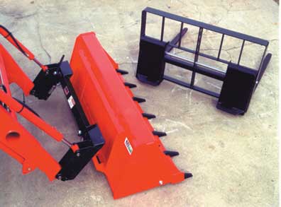

   / About the ATI Tach-All Skid Steer Quick Attach
Neil,
I'm assuming you mean there is no SSL compatible QA for that loader that is made by Kubota. The ATI Tach-All connects to the loader by whatever means, perhaps the Kubota pin, but then the Tach-All is SSL compatible.
I've attached a picture from their web site and you can see the lever set up of the SSL attachment. Their web site states: "Having the Tach-All Quick Attach also allows you to rent readily available skid steer attachments to use with a compact tractor"
#9
Here's another picture from the ATI web site.
