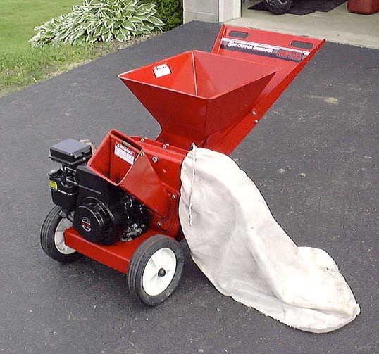

Picked up a MTD 5hp. chipper/ shredder today at a garage sale for $60.00. It states that it will chip up to 3" and the shredder will work on stuff up to 1/2". The guy who owned it was moving down south and everything had to go! It had not been used for 3 years and looks like new. I was wondering if anyone had one and is it any good? Or is there anything I should look out for in using it. I guess I can sell it if it's not up to the task. I sure could have used it a few months ago after the ice storm we had! (lost about 30 trees here at the antique shop) Thanks for the help.

fractal,
That looks just like the one I picked up, with just a few more scratches to it. I will change the oil and fuel tonight and see if it runs. Thanks for the tip in the blades! will check those out as well.
   / ? about MTD 5hp. Chipper/shredders #6
yup, looks like mine also
Mines silver though. It is good for light cleanup, so you got a good deal
Well, I changed the oil and put in fresh fuel, but it won't start. Got it to run on ether, or if I pour gas in the carb. But it won't stay running, its not getting any fuel. I guess sitting for 3 years did in the carb. I hope a rebuild is all it needs. I'll pick up a rubuild kit in the morning. Anything I should be watchful for or any surprizes?
   / ? about MTD 5hp. Chipper/shredders #8
Yup sounds like crud in the carb. Mine has a briggs on it, and I have never rebuilt one of those carbs before, but they should not be that big of a job. Good luck.
   / ? about MTD 5hp. Chipper/shredders #9
Had that problem with my brother's Craftsman (looks like the same machine), but I did it the lazy way; instead of rebuilding the carb, I just bought a new one and put it on. Incidentally, I chipped large quantities of brush and blew the chips directly into the garden, so when I was doing that I opened the chute so it would blow straight out across the garden instead of down; i.e., let it do the spreading at the same time as the chipping/shredding. And one day, it made some really scary racket and I shut it down real quick, took it into the shop and opened it up to find two of the shredder knives missing. I was really surprised to actually find all the pieces in the garden; some of them 50' from where the machine had been sitting. Needless to say, you don't want anything in the way of the discharge chute on any chipper/shredder.
Well, I got it fixed! cost all of a $1.39 for a new fuel pump diapham! /forums/images/graemlins/grin.gif So the total outlay was $61.39 and a few hours of time. Works and runs great. Now I just have to find a use for it! /forums/images/graemlins/tongue.gif Or I could sell it and make a few $$$$ /forums/images/graemlins/grin.gif (I attached a photo for those who want to see!)
