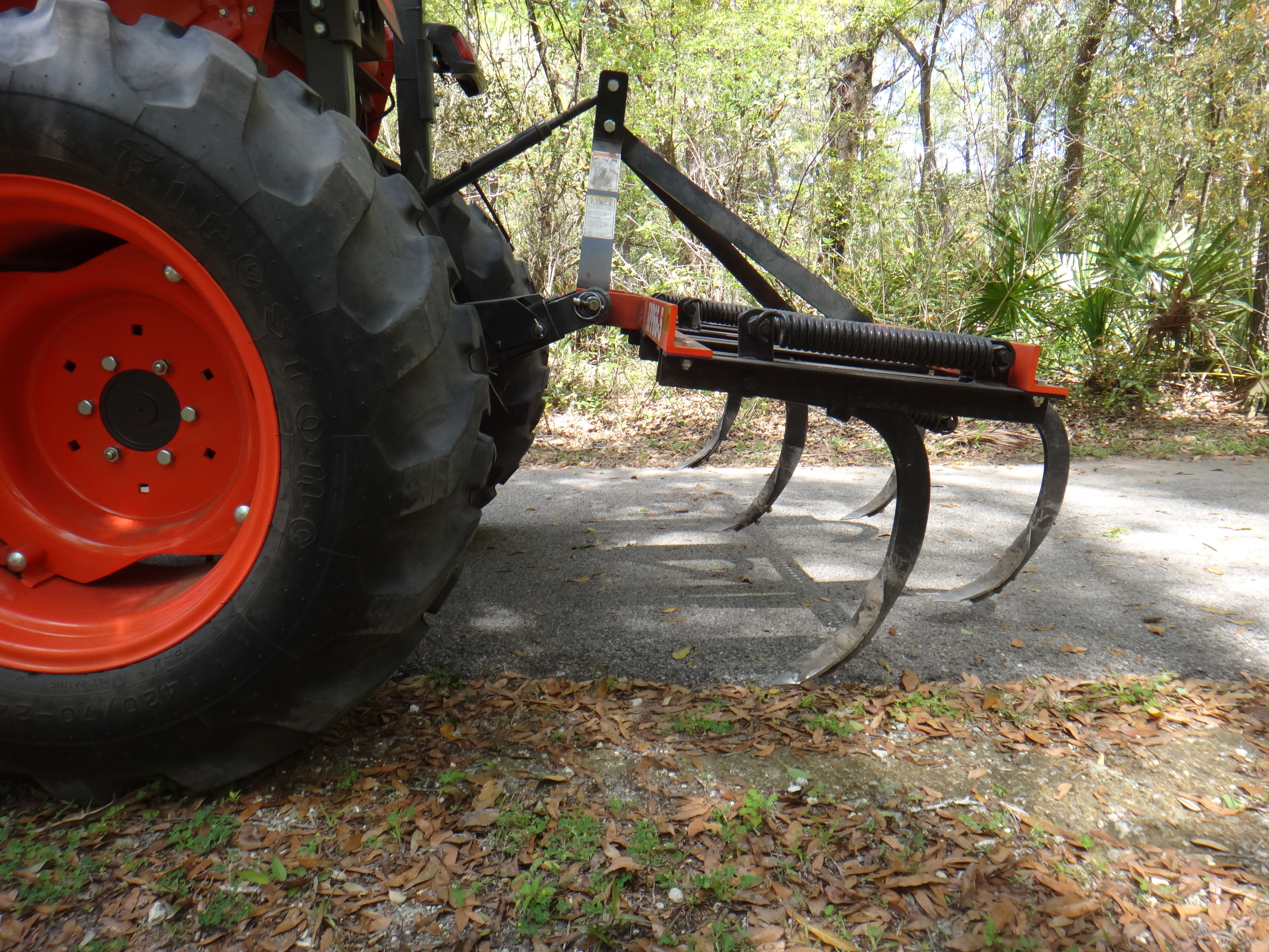

MORE ON TRANSPORT: http://www.tractorbynet.com/forums/...386705-kubota-l3560-tractor-la805-loader.html

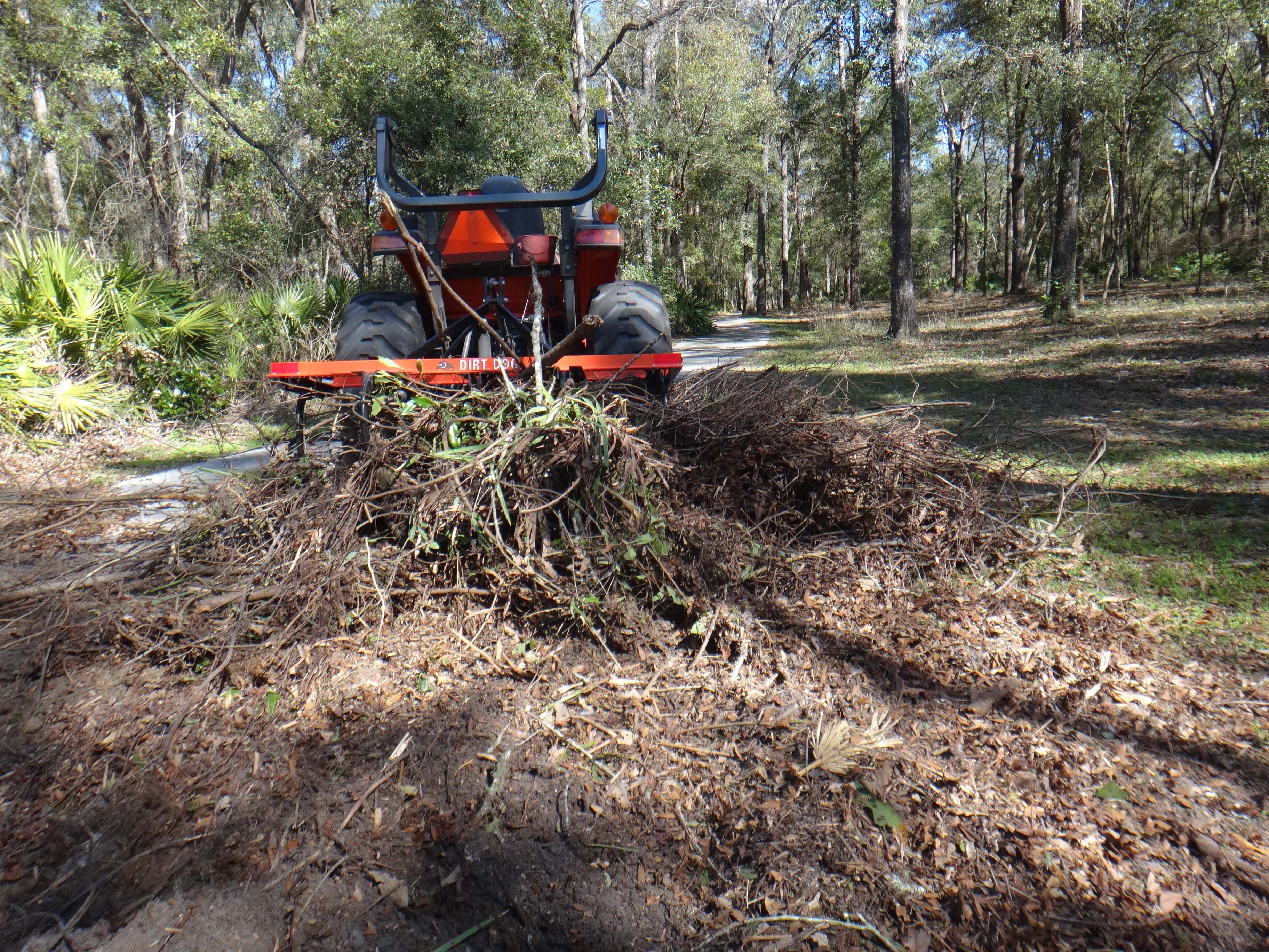

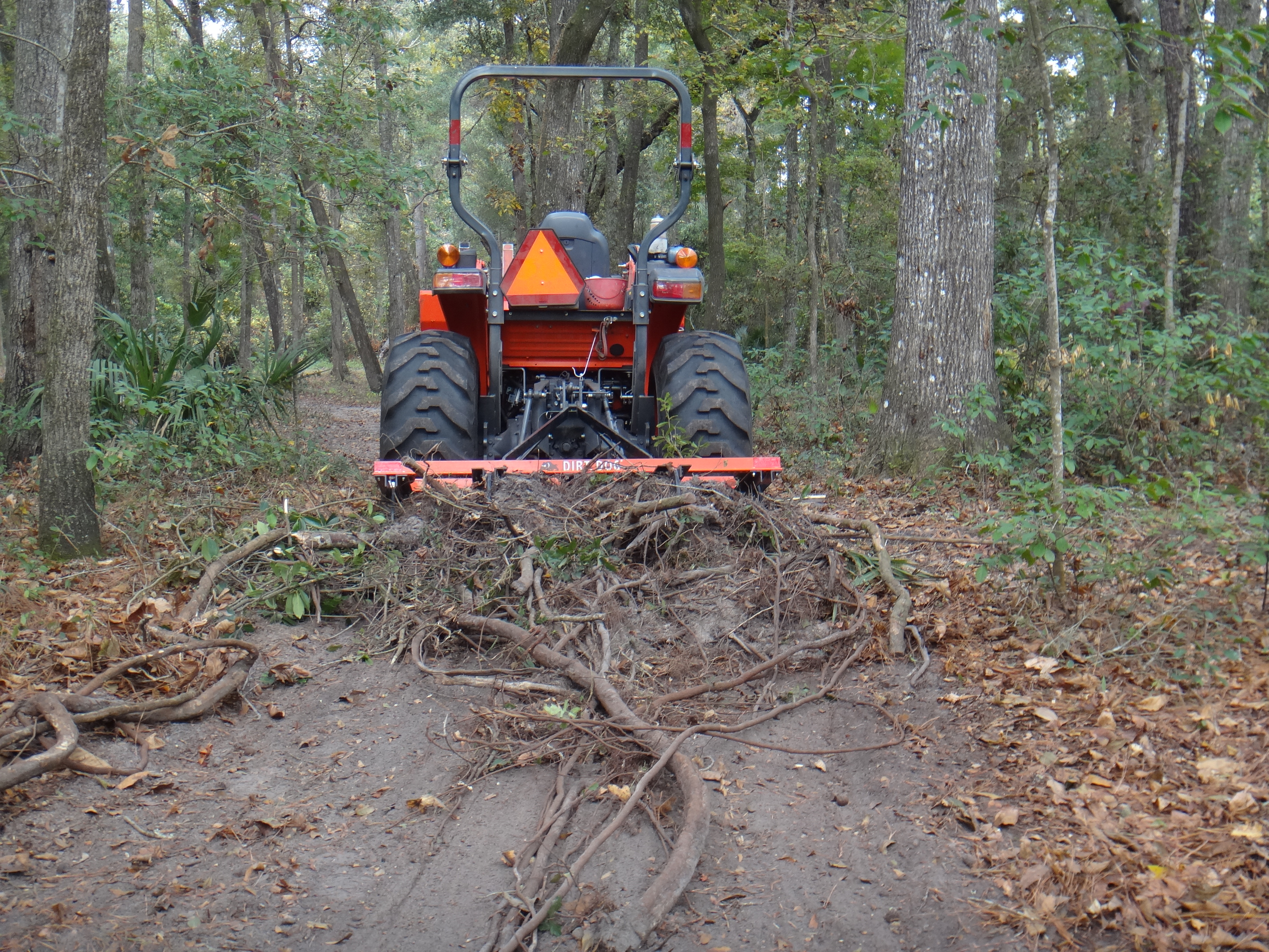

   / Abilities of 2538 hst #9
