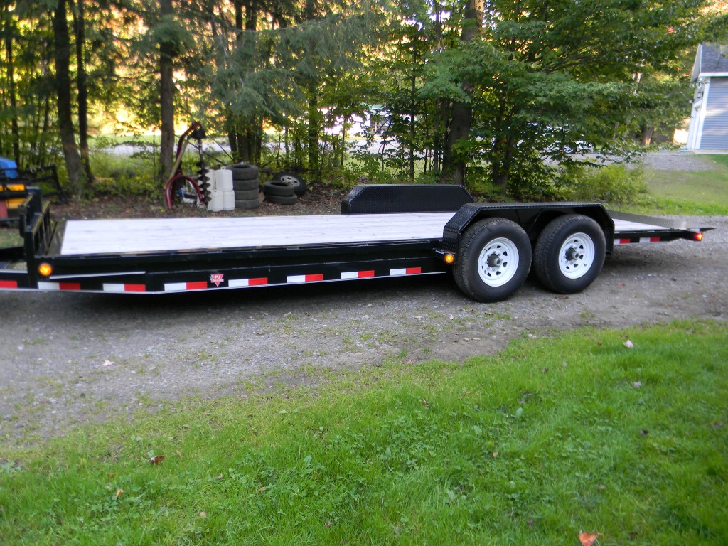

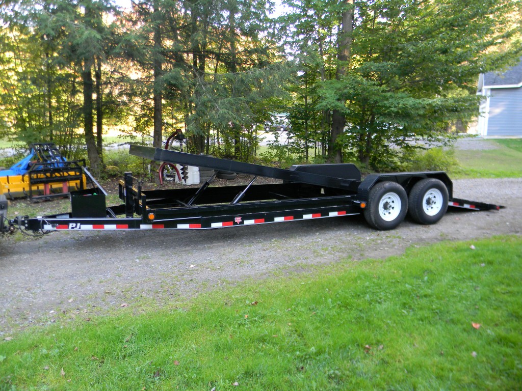

I upgraded from a 20' 7K tilt bed a couple years ago. I tow with a Chevy crew cab, auto, factory brake controller, 2.5" receiver, 4x4, 6.0, and 4.10 gears. I bought a PJ 22' 14K full tilt model TF for low deck height, no ramps, extra length, LED lights, easy loading of low ground clearance vehicles, 82" between the fenders, and power up and down.
PJ Trailers | Powered Full Tilt
It give me a load capacity of just over 10K. I added a 9K winch, and remote control for the power tilt (so I can drive or winch a vehicle on and tilt the bed back down without getting out) and an extra chain box. My combo keeps me under the 26K. My tractor with a couple attachments and loaded tires weighs +or- 6K. and 22' (actual bed incl. tail is 23'9") is plenty long enough.

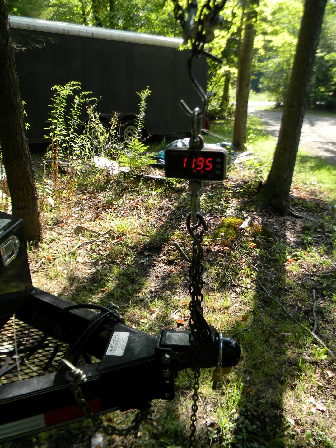

This is not the case with all tilt bed trailers. My PJ full tilt. axles are placed back approx. like the 60/40 rule. I have almost 1200# of tongue weight empty on a trailer that weighs about 3800#. Deck pivots behind the rear axles, not between.

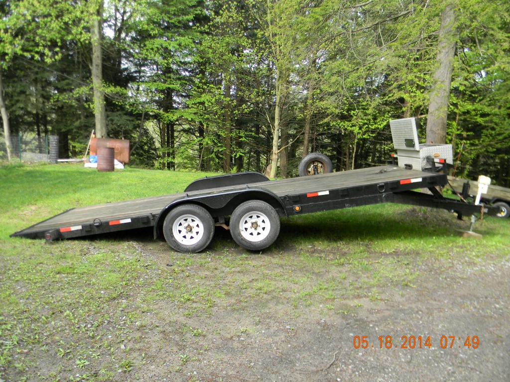

I have also seen many tilt beds that do pivot between the axles. I was just noting mine didn't.
In fact, my previous tilt bed pivot point was actually in the front. I didn't care for the fact it actually raised one axle off the ground when tilted but it also had plenty of tongue weight so it was never a problem.

Seen that style too & not impressed. It seems cheap. A lot of work to pump up that cylinder to tilt as opposed to a properly balanced deck. On mine I can walk to one end or the other & jump, then it will tilt appropriately. I rarely bother with that now when loading as the front wheels tilt it just fine on their own when they touch the end of the deck.
