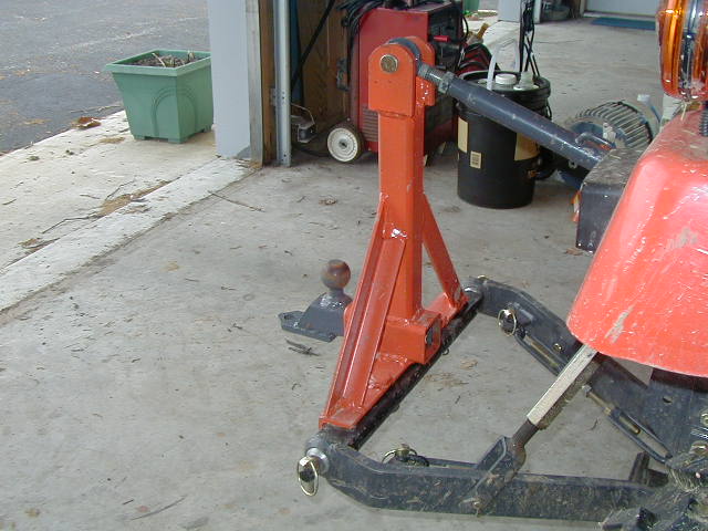

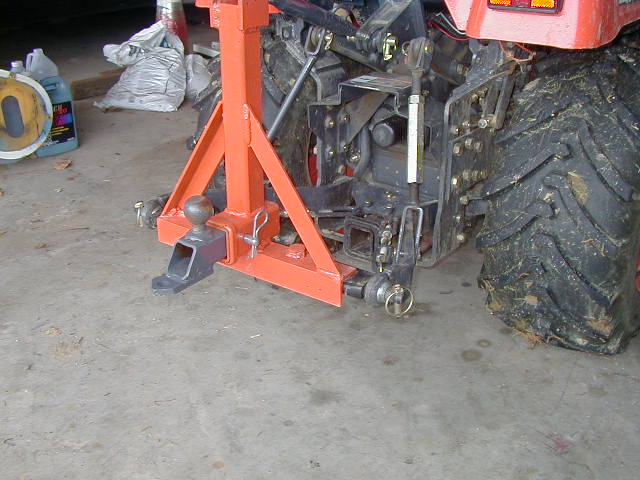

Be careful towing with a draw bar as well. It will spin on you and you might lose whatever you're pulling. You should get a draw bar lock or if you can weld you can make your own. This is a photo of one someone on this board made. If you do a search there is a thread about them. Good luck!
