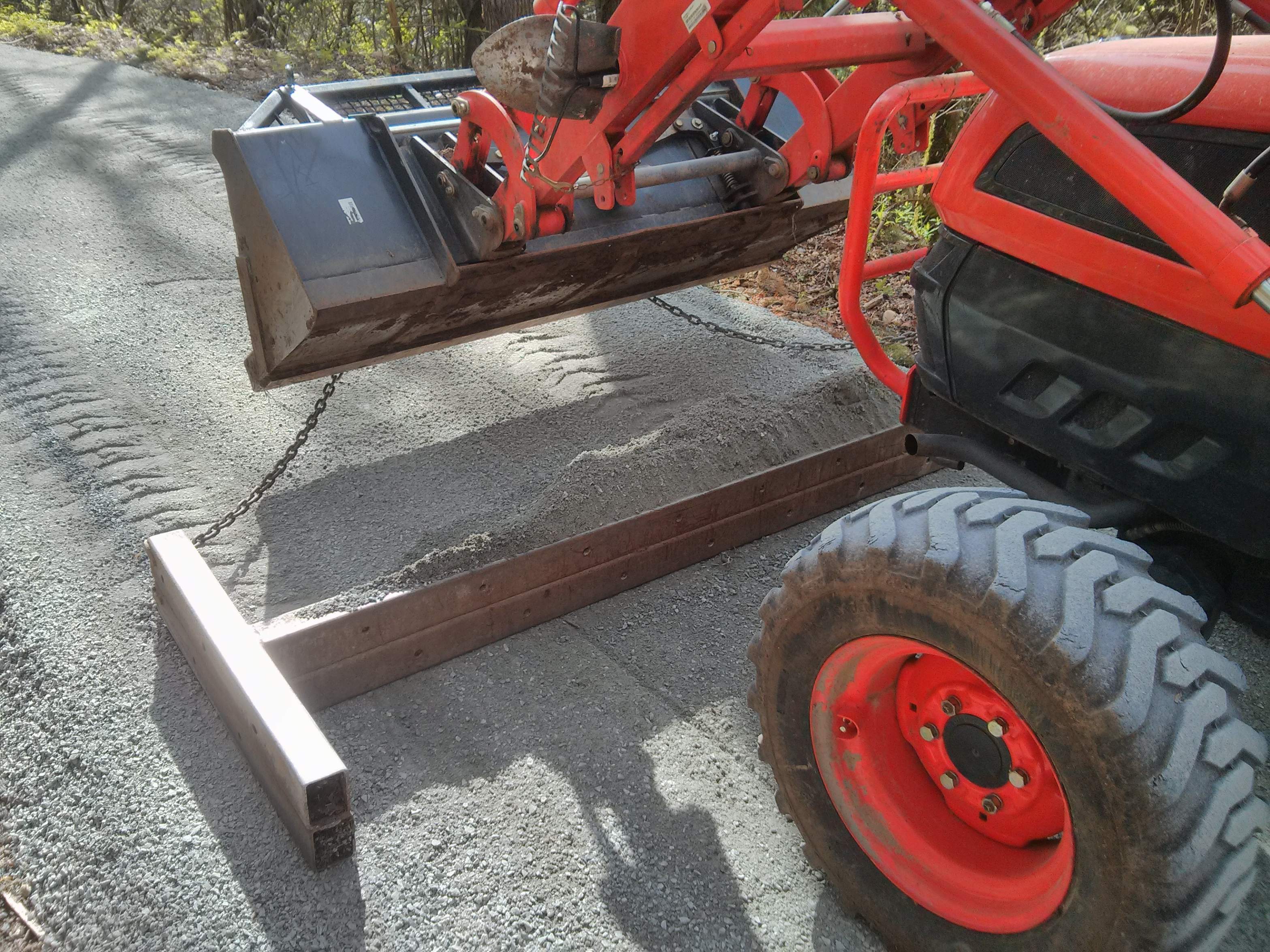

Made from an old steel post (2 pieces of 3"x4" square tube welded together to make 3" x 8"). Can be used with a tractor (behind or in front), excavator, or? Needs loose material to function effectively so I use the box blade/ripper teeth first if the ground is packed. Works either way up, both sides are the same.
Video at https://www.youtube.com/watch?v=cRXeN1wbW0E

Nice - I like it. Simple. I have something similar that started off simple as 4 I beams welded together that I used to drag along with a chain (which is why I call it the dragalong) - it has evolved now & works great but right at the moment I need a lighter drag like yours for a certain job. Was using a railway iron but if I put skids like yours it will work better - I just scored me a lightbulb moment. Cheers

Would like to see a pic of yours. I am thinking of making another one with more "bite" for harder ground. They are so simple to make, might as well have 2 or 3 of them!
