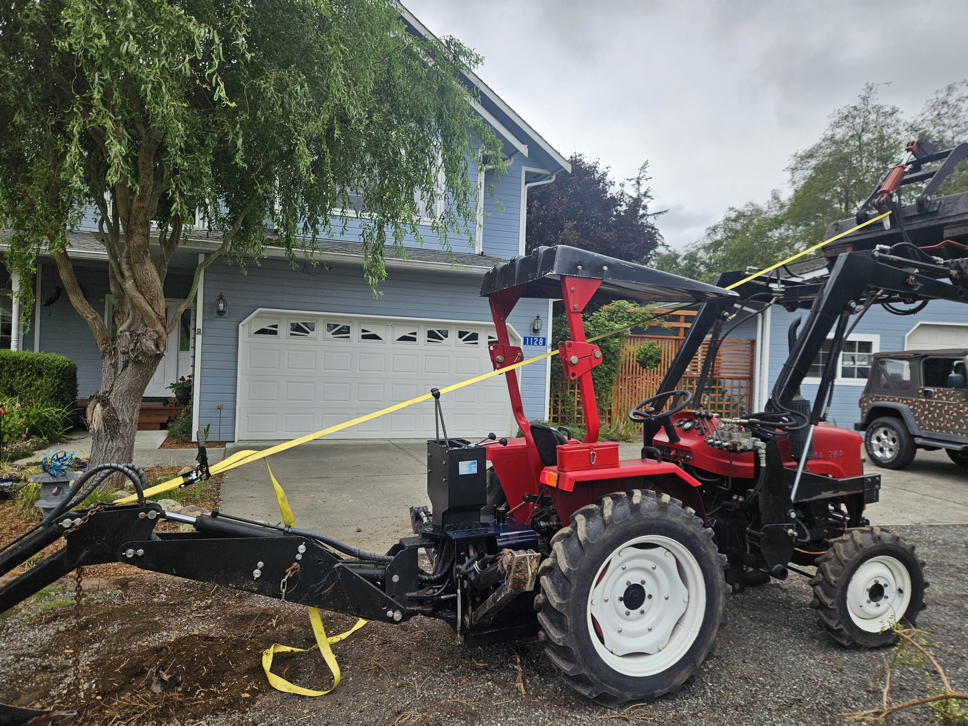

I was digging a hedge out of short rocked wall terrace with the back hoe, of course there was a lot of bouncing and sliding into and onto the wall. Finally admitting that I had done what I could, I tried to leave, but found myself hung up on the rocks by the backhoe mounting flange. 4WD didn't seem to help and the rear tire(s) were spinning. I tried to use the diff lock, but didn't help so I disengaged it---or so I thought, turns out I disengaged the PTO. I was way tired, (end of long day), but I did check the 4WD and reengaged it and got myself free, but now the backhoe was dead---this is the self own ( I disengaged the PTO pump!). I tried to use a rachet strap to pull up the backhoe, but attaching it the roll bar didn't work, nor did attaching it to the loader while it was on the ground. So realized if the loader was full height, I could rachet the backhoe into a stowed position. As I was ratcheting I realized if I lowered the FEL it would pull the backhoe up; two iterations later, done. The next morning, after a good night of sleep, while watching the Keno video of how to remove the backhoe, the fellow mentioned PTO and I realized I had disengaged mine, so feeling both stupid and relieved.

You may have missed the "self own" part, the back hoe died because I essentially turned it off without realizing it---all better now.
