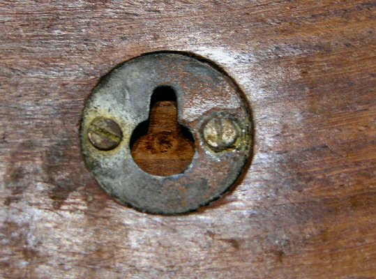

I need to find a source for the whatchamacallit hangers that can be flush mounted in wood (see picture). Can anyone direct me to a source? I have checked Restoration Hardware and carried the part into several local hardware stores with no success so far.

I have used Keyhole Fittings - Rockler Woodworking Tools with success in the past.
   / A question for all you wood workers #9
If this is for a restoration project some sheet brass, a drill press and a jeweler's saw would turn out a copy in a few minutes. Drill some starter holes for the "keyhole", saw it out then use a fly cutter to cut the exterior. You would need the beam type of fly cutter so you can set the bit to cut toward the inside since that is the face you want clean.
