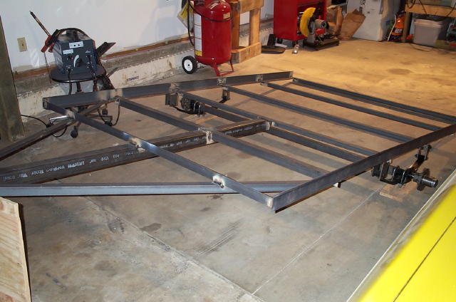

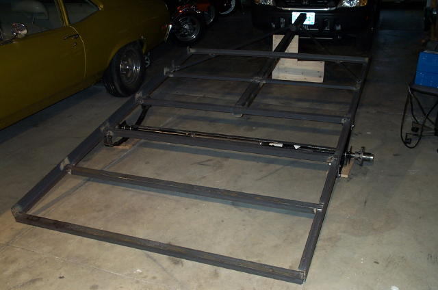

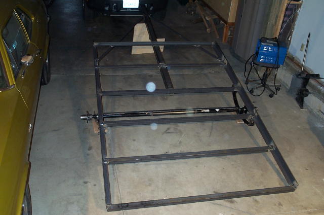

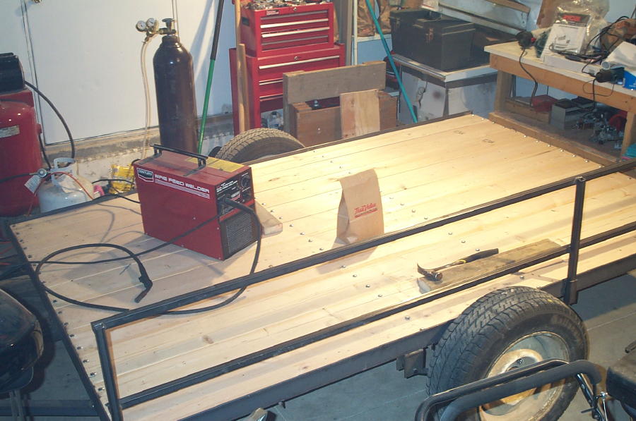

Hey all. New to the forums, been watching for some time, and enjoy following the discussions and watching projects progress. Here are some pictures of a trailer I built a few winters ago; wanted to add something, quit lurking about.
The rails are 2x3x1/4 angle iron, and the cross-members are 2x2x1/4 - I like to build things heavy (the finished product weighs in at just under 600 lbs.) The cross-members were notched and the rails are inserted into the notches.
The axle/hubs/springs were a package from NorthernTool, the axle was widened ~24 inches to accomodate the 6x9 ft deck, then boxed in with channel stock. The entire project was welded with a cheap AC welder (don't even remember the brand) that has since been replaced with a Hobart TIGMATE.
Tim

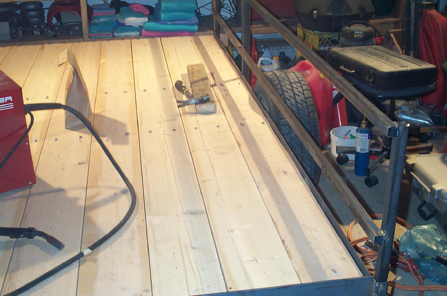

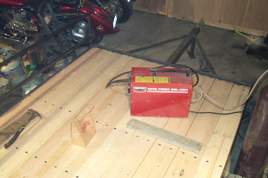

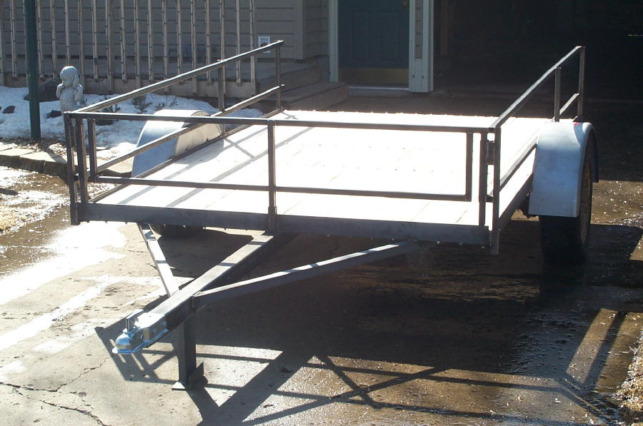

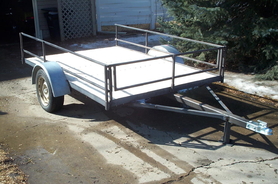

Here are a few pictures as the deck was being installed and the sides were framed up. The sides are all quick release, and are covered with expanded steel. I forgot about the Century wirefeed I had, not a bad welder for $75 (used) but the lack of infinate heat stunk.
Tim

   / A project from a few years ago #3
Welcome to TBN. Your trailer looks great. Did you cut all that 2 X 2 with the chop saw that I saw in the picture? When I was putting together a BH dolly I got so tired burning up chop saw blades that I finally broke down and invested in a horizontal band saw which makes short work of cutting. Hope to see more of your projects in the near future.
Thanks for the kind words.
Yeah, all the bits were cut using the chopsaw in the background, which ended up taking a dive on me in the middle of a small project about a year ago. Cheap hardware just doesn't hold up.

   / A project from a few years ago #6
Nice looking and I bet it's seen a lot of use already.
Looking at yours reminded me of a little ATV trailer I just built. I looked around at tilt trailers and made this one tilt. With that main yoke you have you were just a couple welds away from making a tilt bed. You can save that for the next one!! :)
Yeah, the trailer's been to Stugis for the bike rally week 3 times, over a dozen trips out of town and hundreds accross town moving friends, and firewood.
I have been considering converting to a tilt trailer, especially after 13 trips to the tree dump over the last 5 days. I've been asked if I'd sell it, so I could part with it and start anew too...
