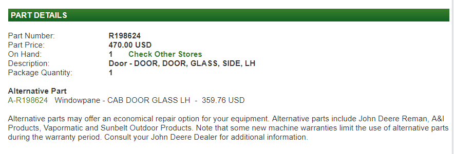

Ok - I own it! Pulled a real dork move and shattered the glass door on my 5093e cab. Had something to do with operating the tractor with the door open...
Moving on, pretty sure only the glass is broken, the handle, latch and hinges seem ok, so I'm looking for glass. I think I have the right number from the JD online parts system (R198624), but I see an A-R198624 that pops up when I google search, and of course it is cheaper. The JD system does not contain the A version.
Below is a search result that shows my problem (there are others, but this site illustrates the point the best):
Search results - GLOBALPARTSZONE.COM - GLOBALPARTSZONE.COM
There is the A-R198624 at $280, the JD part at $425, and the aftermarket at $322.

A- part numbers are A&I part numbers and are order-able from all JD dealerships (JD owns A&I) and any other b2b or b2c dealer. However depending on dealers commitment based on pre-season order level ordering in 1 door can sometimes cost more than the oem as the freight can be a little crazy. Weatherstripping is re-usable it's just a matter of being worth your time to dig out all of the glass. There is generally a metal strip inside that can be crimped back down to keep it on the glass or it can be glued on with some good adhesive. Good luck, bet you don't do that again

Some time on the phone turned up info that agrees with the above - jd owns A&I. I didn’t get any signals there was a quality issue so I ordered the A&I part.
FWIW my local jd dealer wanted the same for the jd part ($425) and almost the same ($400) for the A&I.

For future reference the A&I parts with the "A" prefix & prices are shown on JD parts website
