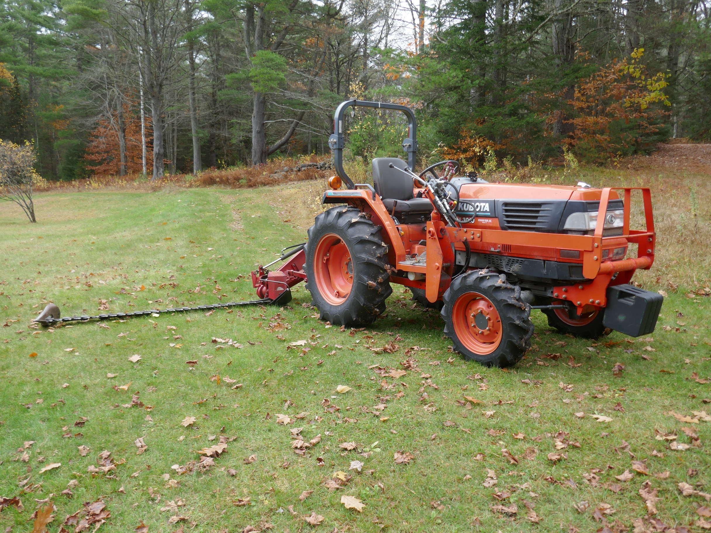

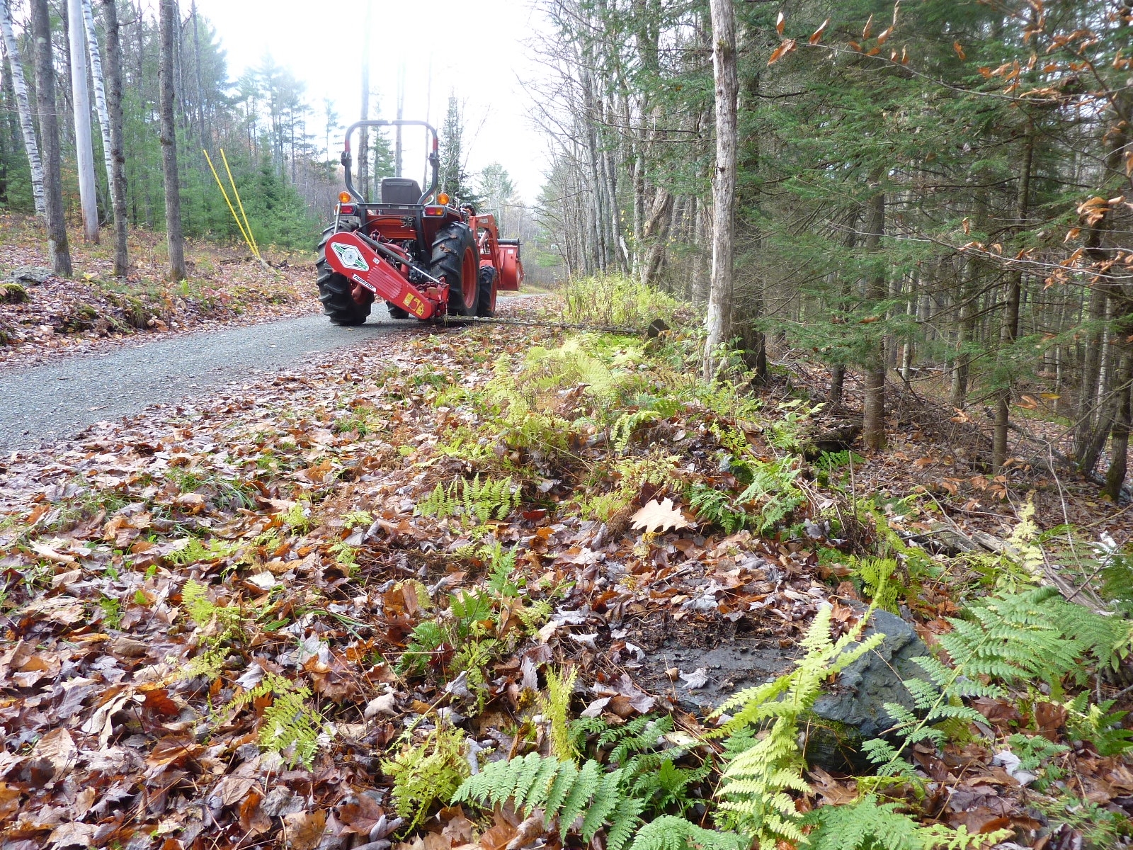

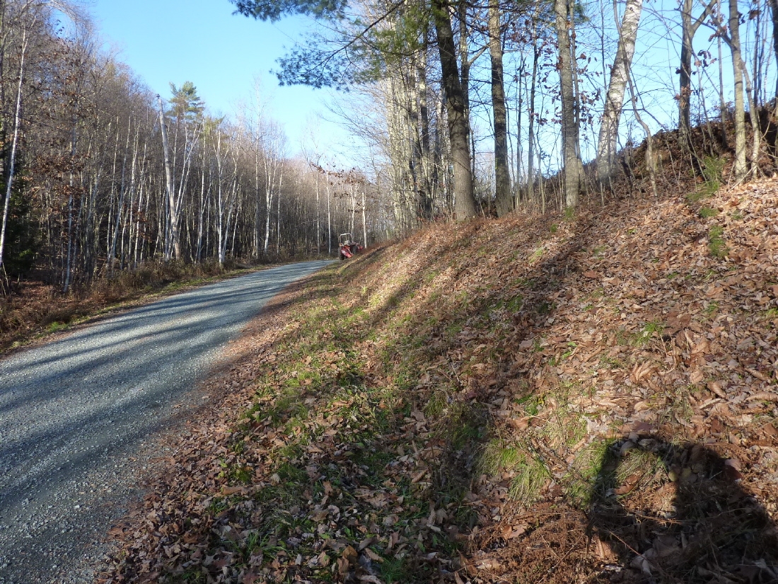

I've been running it here for 24 years. It is a First Choice/Superior 7 footer made in Italy. Friday I saw we were going to have a stretch of decent weather so I put the sickle bar on the L3010 to do the late season mowing, I only mow the roadsides and three small rough fields once a year - in the fall. It takes me 3 or 4 days the way I work and mounting the mower is a bit of a chore so I like to do all the mowing at once. I remove the loader and mount the suitcase weights, grease the mower and drive shaft - there are 15 zerks, then I have to take off the TnT cylinders and put on the manual top link and side links. This is because there is a counter balance type chain that puts pressure on the top link. It also eliminates hydraulic drift in the TnT setup which is not a problem when doing dirt work because fine adjustments are being made all the time. But for running the sickle bar I want the initial adjustment to be permanent.

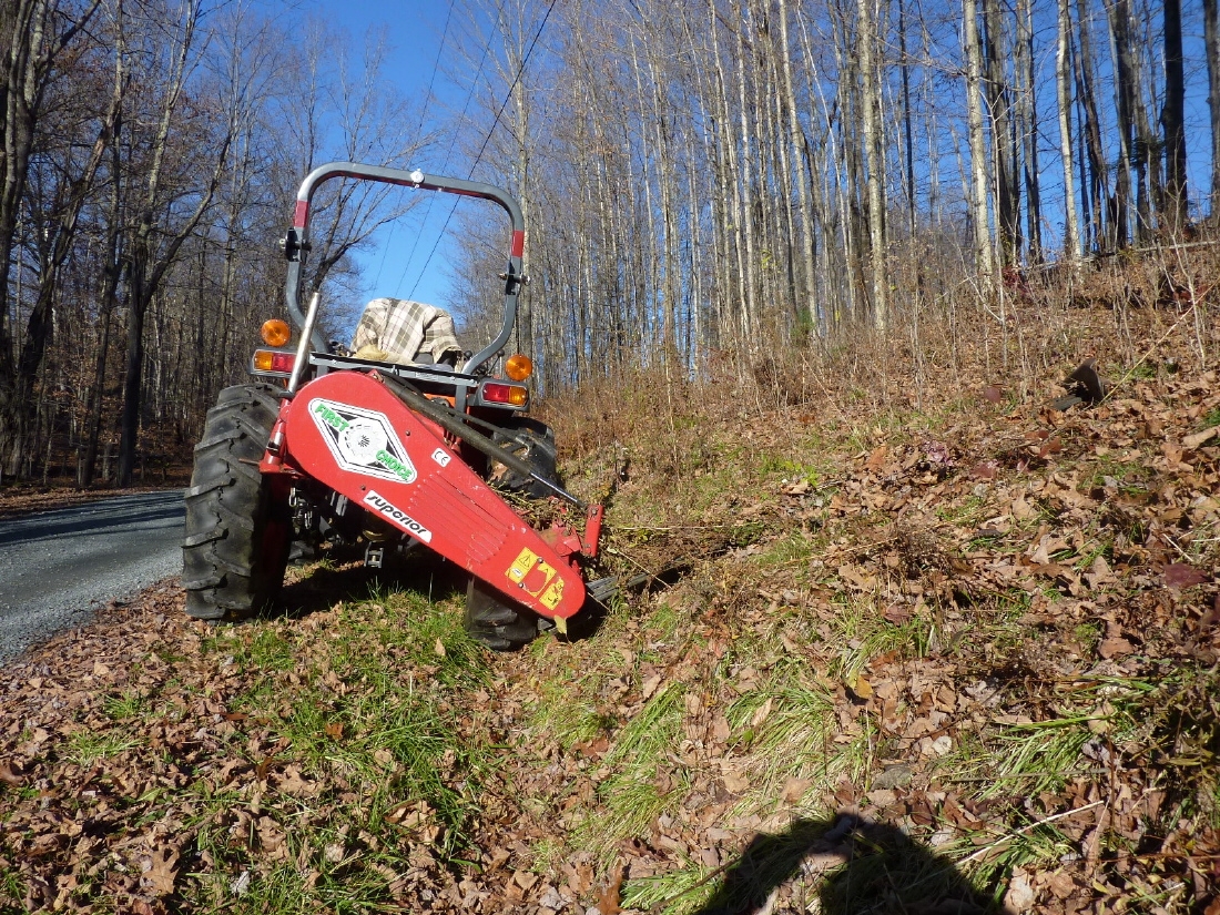

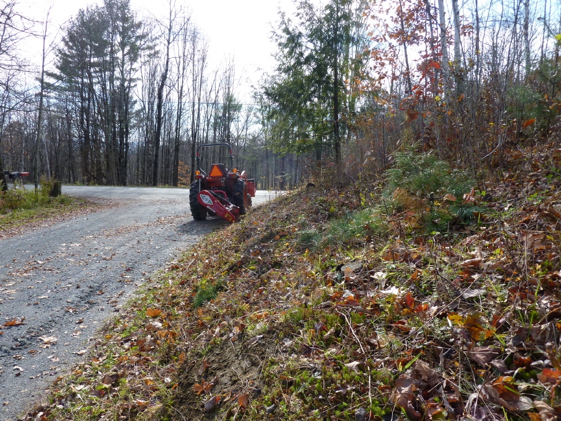

I can mow down sloping banks,
up sloping banks,

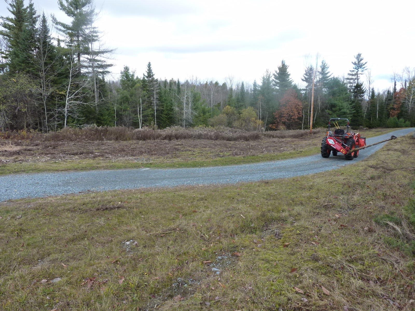

flat on the ground

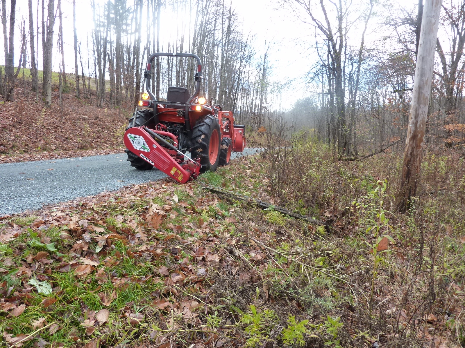

or above the ground. Here I'm cutting along the top of a rough stone wall. The bar is off the ground.

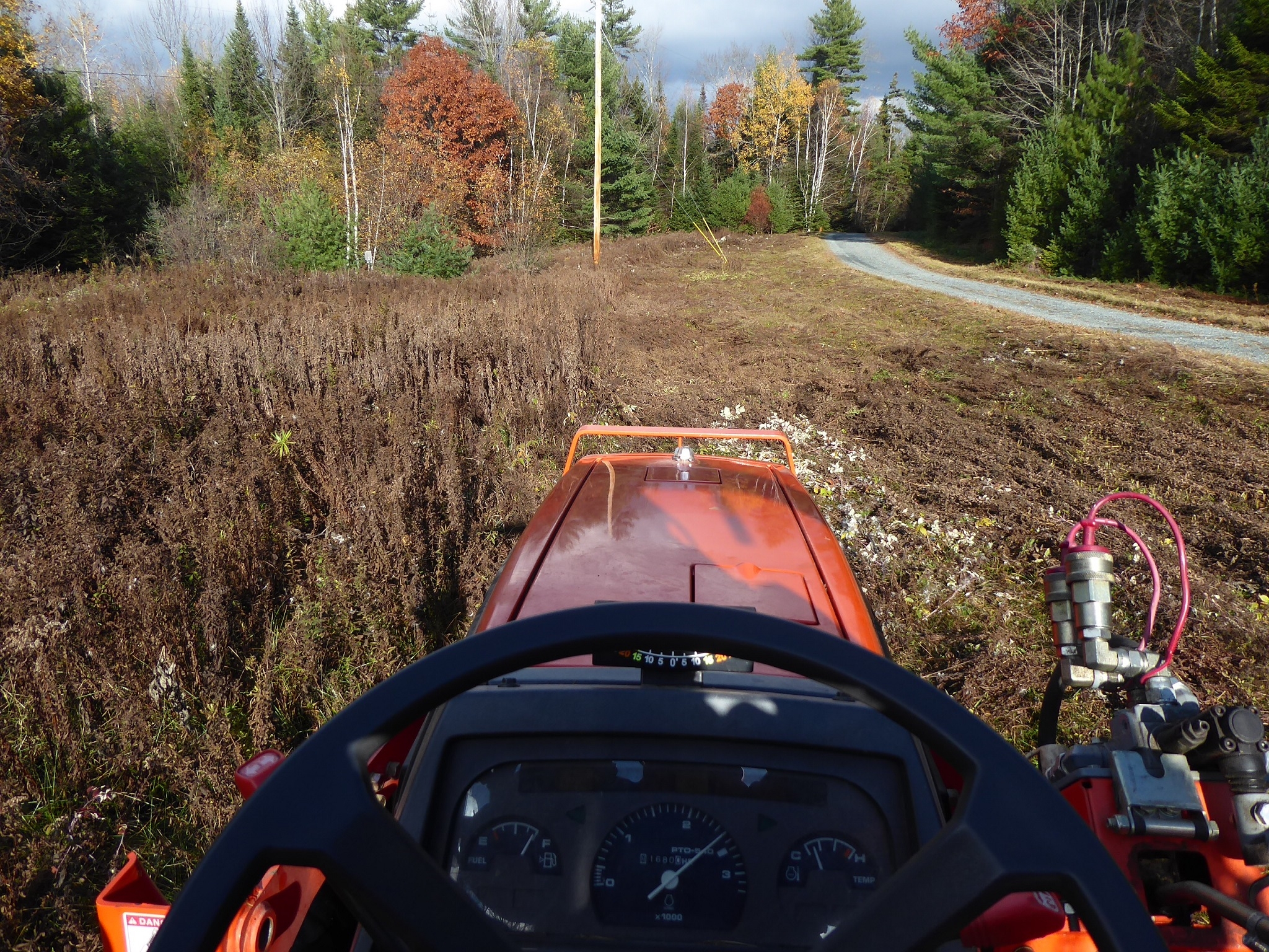

From the drivers seat
