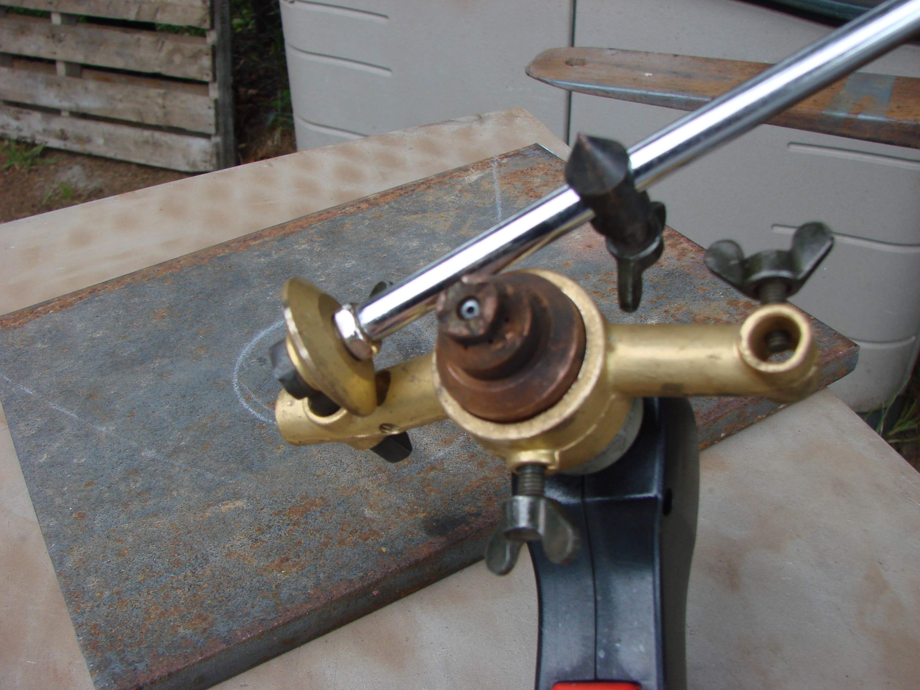

Had a few guys asking me how I cut the hols in my plate with the plasma. Well yesterday I had to cut a 3" hole in some 1/2 " plate. the smaller the hole the harder it is for my circle cutter because it don't have that short adjustment on it but I frigged with it enough to get it to work.
A few years back I made a lazy Suzy for my cabinet blaster to lay the heavy parts on it while blasting. To cut the cycle I take that Lazy Suzy and turn it upside down as seen in the photo's. I lay an old brake rotor on it and lay the plate on the rotor. I center punch the plate and ground the plasma clamp to the Lazy Suzy. I place the plasma torch/circle cutter on the plate and pull the trigger. As soon as it burns through I use my other hand and turn the flat bar while the plasma torch is not moving. As you can see it cuts a pretty descent hole. The rest of the plate was sheared on the Ironworker.
I know you all like pictures so here's a few to look at ;)

The last pic shows the completed bracket.

Dont move the torch move the work. I like it. Great work as always.

Where might we find one of those circle guides? I get tired of searching for the right dia. cap to tape to the work.

This one I got was purchased at Princess Auto. I think it only cost around $20. but was meant for an O&A torch but I machined out the center to fit the plasma torch. You should have no trouble getting one at your local welding supply dealer.

Man if he can't find one all he got to do is say the word and I'll get one for him. I was looking at them the other day at Princess Auto. $19.99 for the kit. There was only about 25 of them on display :laughing:
I pulled out the center part of mine and machined it to fit my plasma torch.
