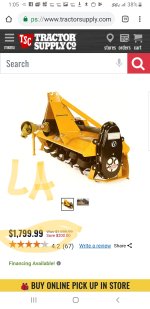

I borrowed a friend's tiller yesterday (Easter Sunday) to till up my garden only to find that it was broken, so I decided to purchase my own. I remembered seeing an email from Tractor Supply saying their County Line tillers were 10% off and the sale ends today. But today I had to leave early on a business trip to Houma LA so I was bummed about missing the sale. Until I realized they have TSC here. So I went in with the intention to purchase the County Line 6ft tiller, just pay for it, and pick it up at my local store in TX.
Strange thing #1: Apparently their pricing in LA (at least this part) is way different than in my area in TX, and I'm not talking about taxes. The county Line 6ft tiller in my local store is $2,200. Here it's $2,000. He said if I wanted to pay for it here and pick it up back home, I had to pay the back home price. So I decided to purchase it here in LA and haul it around in the back of the truck for the rest of the week. Combined with the 10% discount, I was going to pay $420 less.
Strange thing #2: right before paying he said "we're in the middle of switching over from County Line to Tarter. All we have right now in 6ft is the new Tarter. It's the same exact unit as county line but it's black. Do you mind?" I said absolutely not; I don't like yellow anyway, and every TSC has yellow County Line stuff in the lot with the paint flaking off. Hopefully the black stuff is better.
So I bought it and sure enough it says "TARTER" in big letters, no county line. For everyone who speculated county line was rebranded Tarter, I think this serves as confirmation. And if you want to save a few hundred bucks, wait for the next sale and drive to the TSC in Gray, LA. For some reason significantly cheaper.
P.s. the website still shows County Line, but look what's in the truck.
P.p.s. if you do go to the location in Gray LA and the guy about to load your tiller looks like an idiot who is probably high, trust your gut. Insist someone else load it. He did a number on the bed liner.

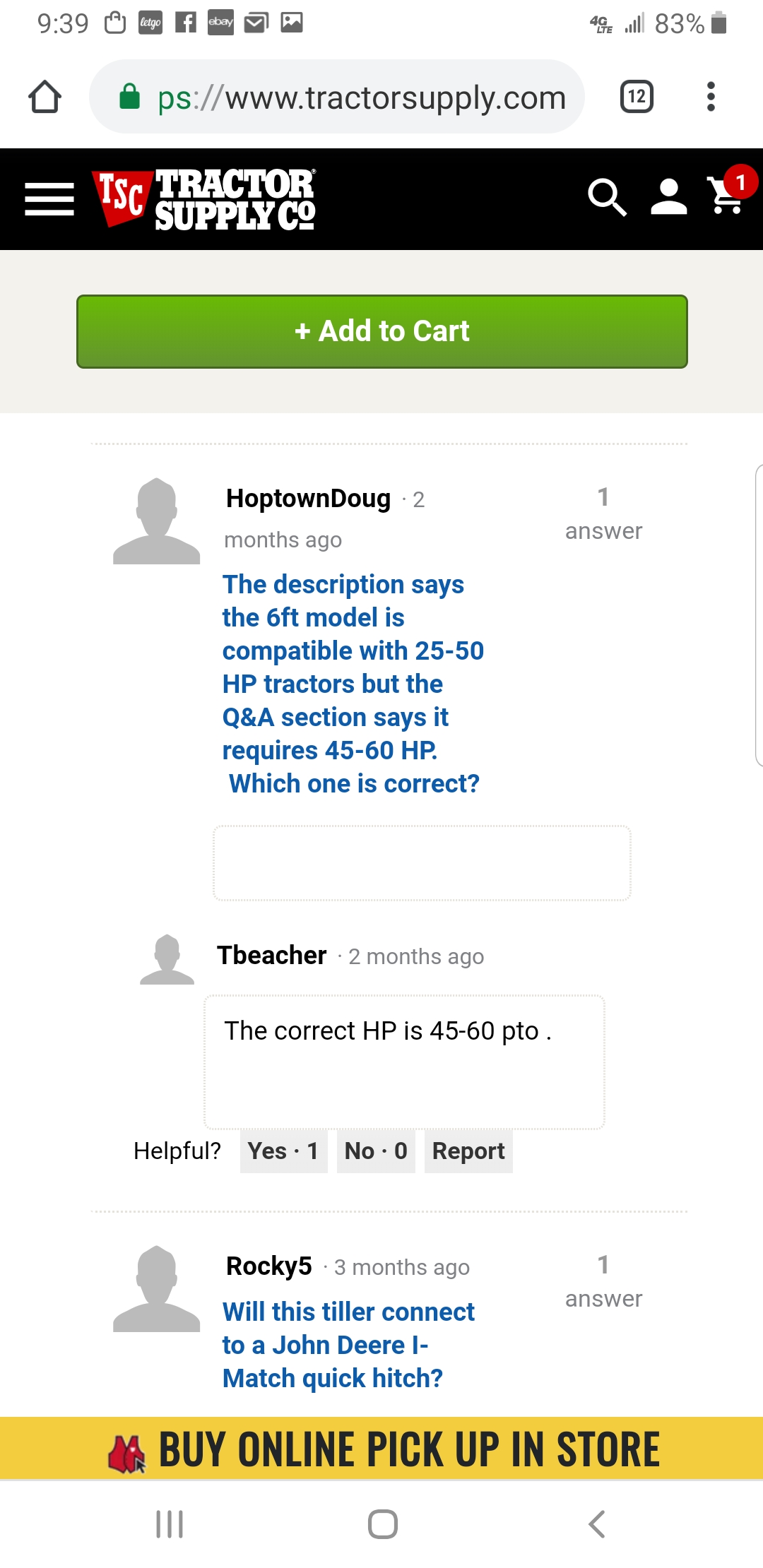

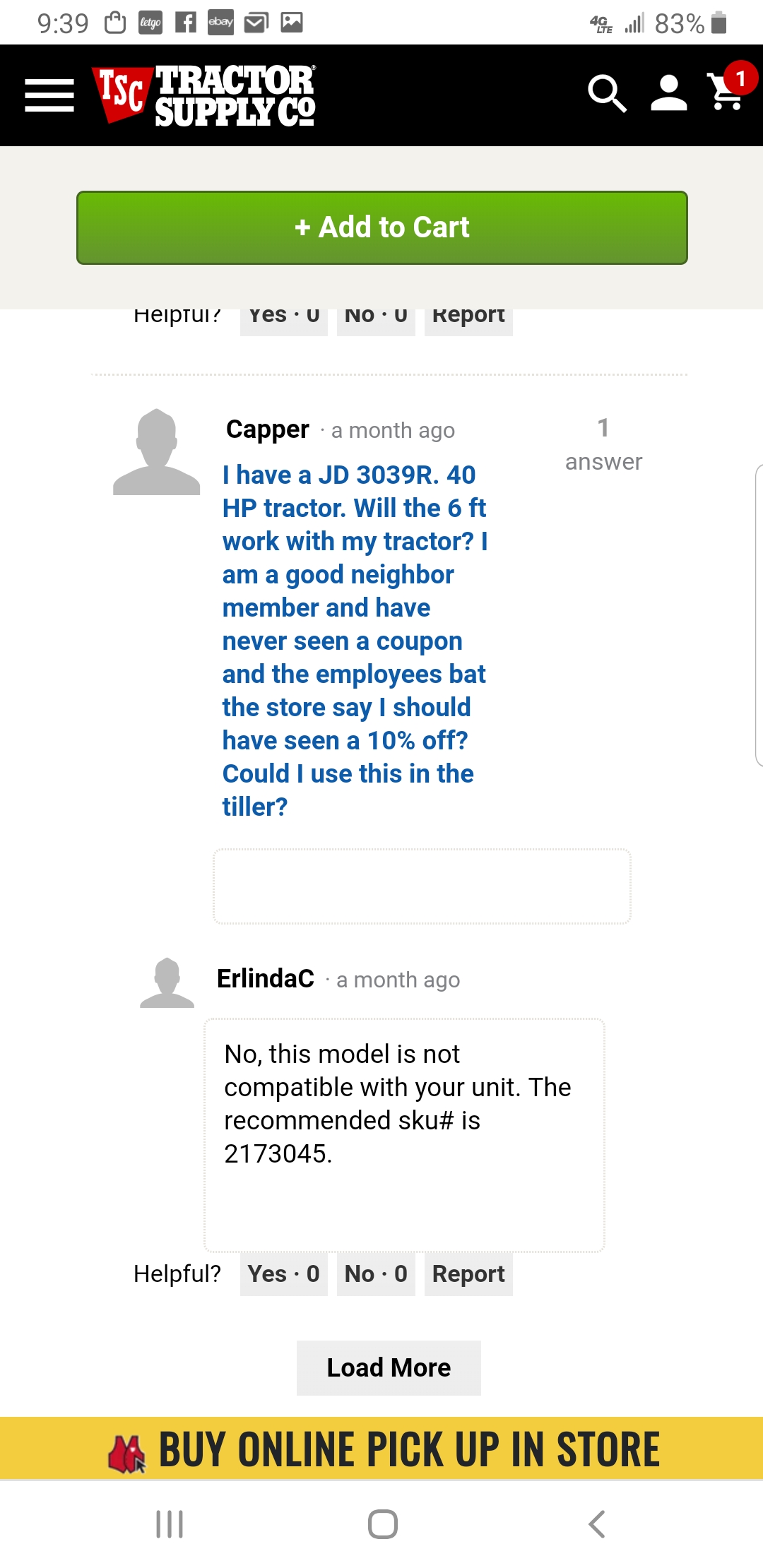

4. The specs on the TSC website say it's good for 25-50hp tractors but down in the q&a section the product reps on the TSC website say that is in error (but they don't fix it). They are saying it's only good for 45-60hp tractors, and directing people with 40hp tractors to the 4ft tiller.
I didn't see this until after I bought it drove it home to Texas, and was worried that my 40HP LS would have problems. My concerns were unwarranted. The 40hp tractor didn't even know the tiller was back there. Like it literally didn't even burn any more fuel than does just sitting there idling not doing any work. Didn't bog down one little bit. No change in motor sound or RPM when lowering it down into the ground.
View attachment 602409View attachment 602410
A 4' tiller on a 40HP tractor? They must be confused.
We run a 5' tiller on our B7500 and it runs it fairly well (could go faster with a few more HP, but it gets the job done), IIRC, it is 19HP at the engine and 16HP at the PTO.
The general rule of thumb is at least 5HP at the engine per foot, so a 6' tiller should be on at least a 30HP tractor.
