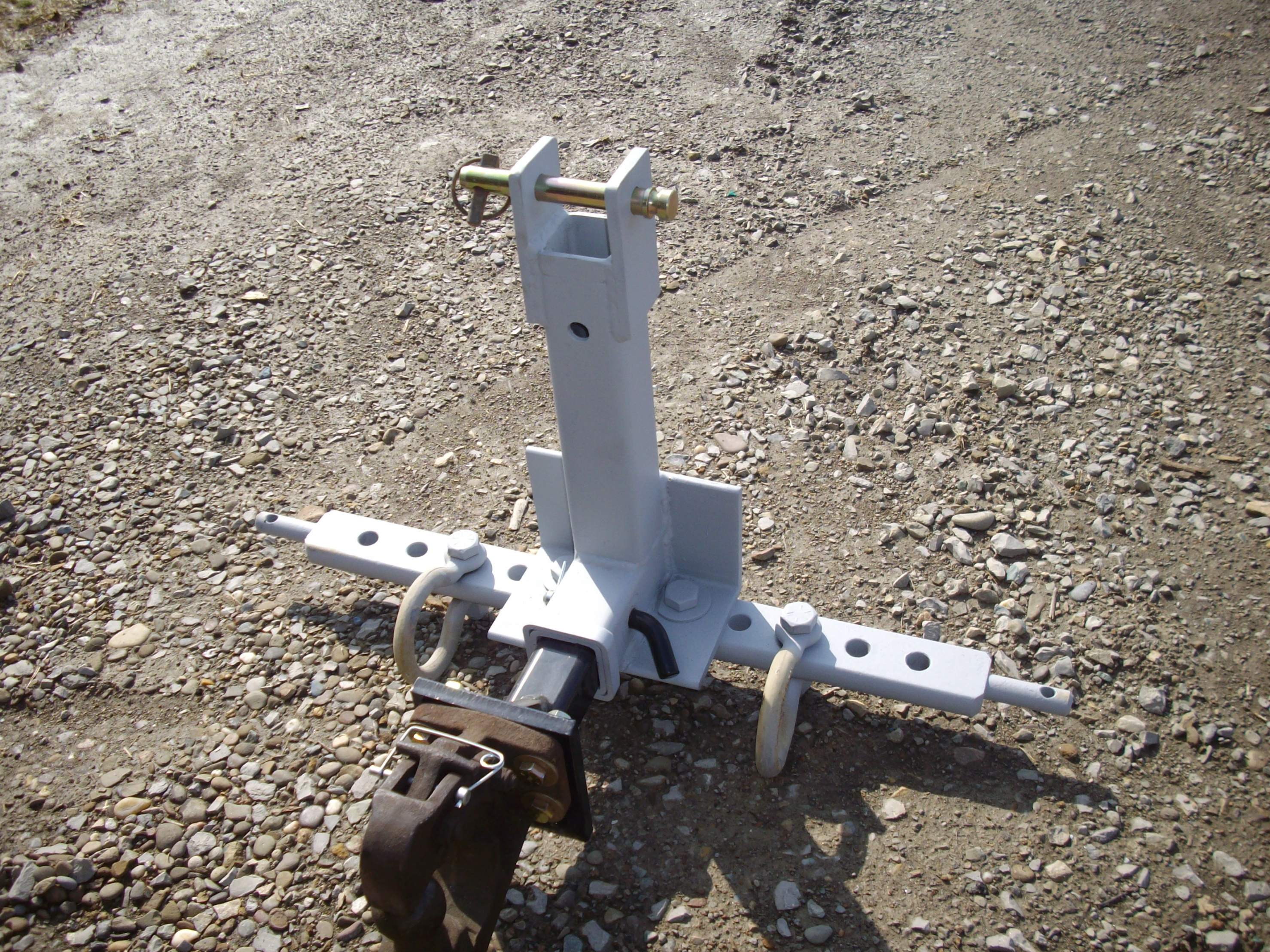

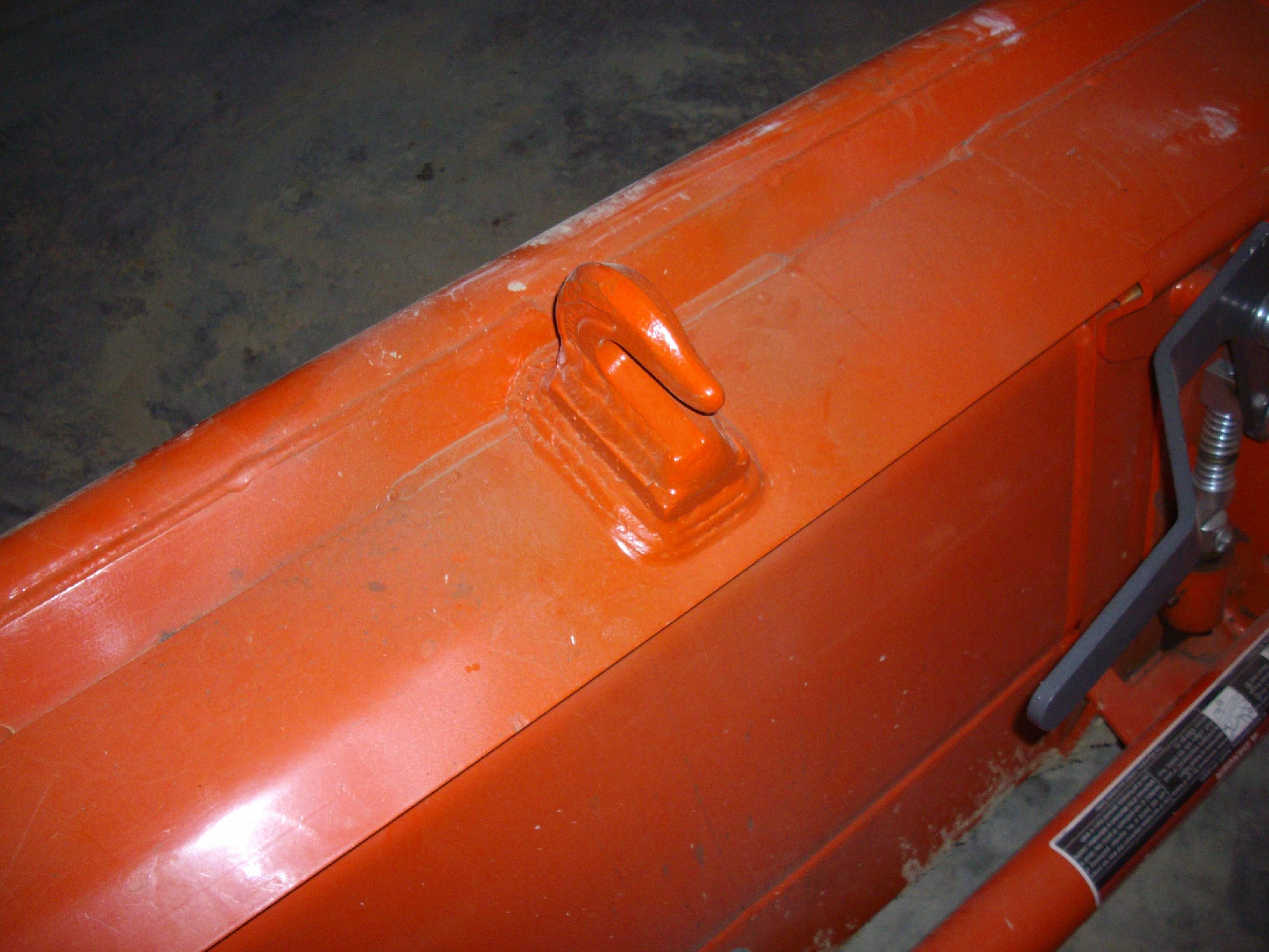

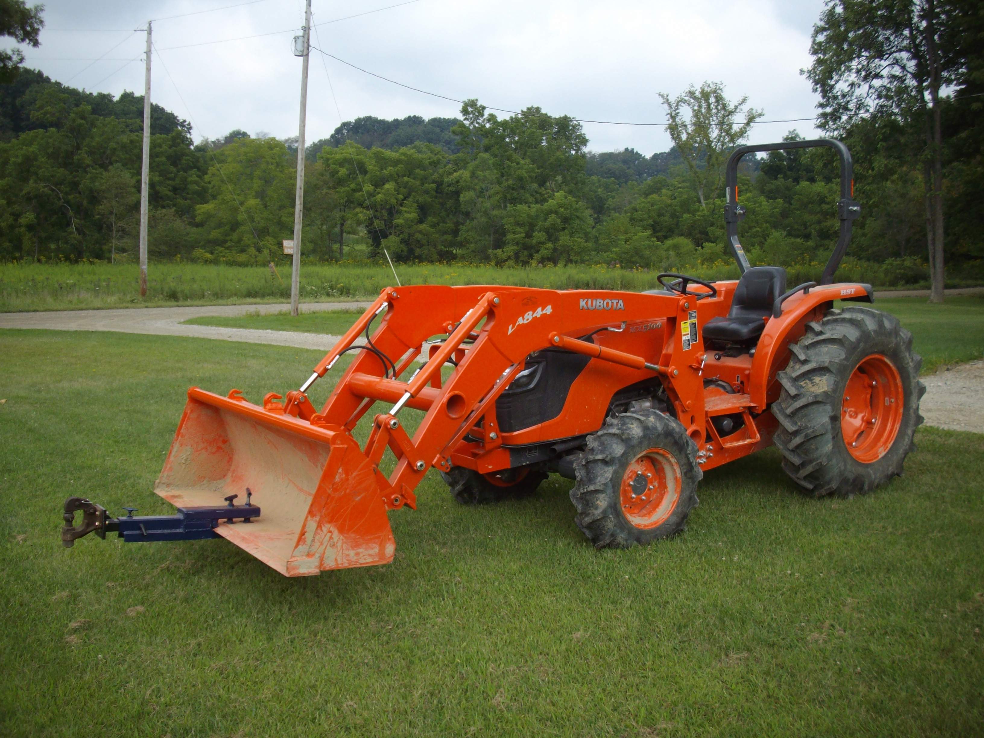

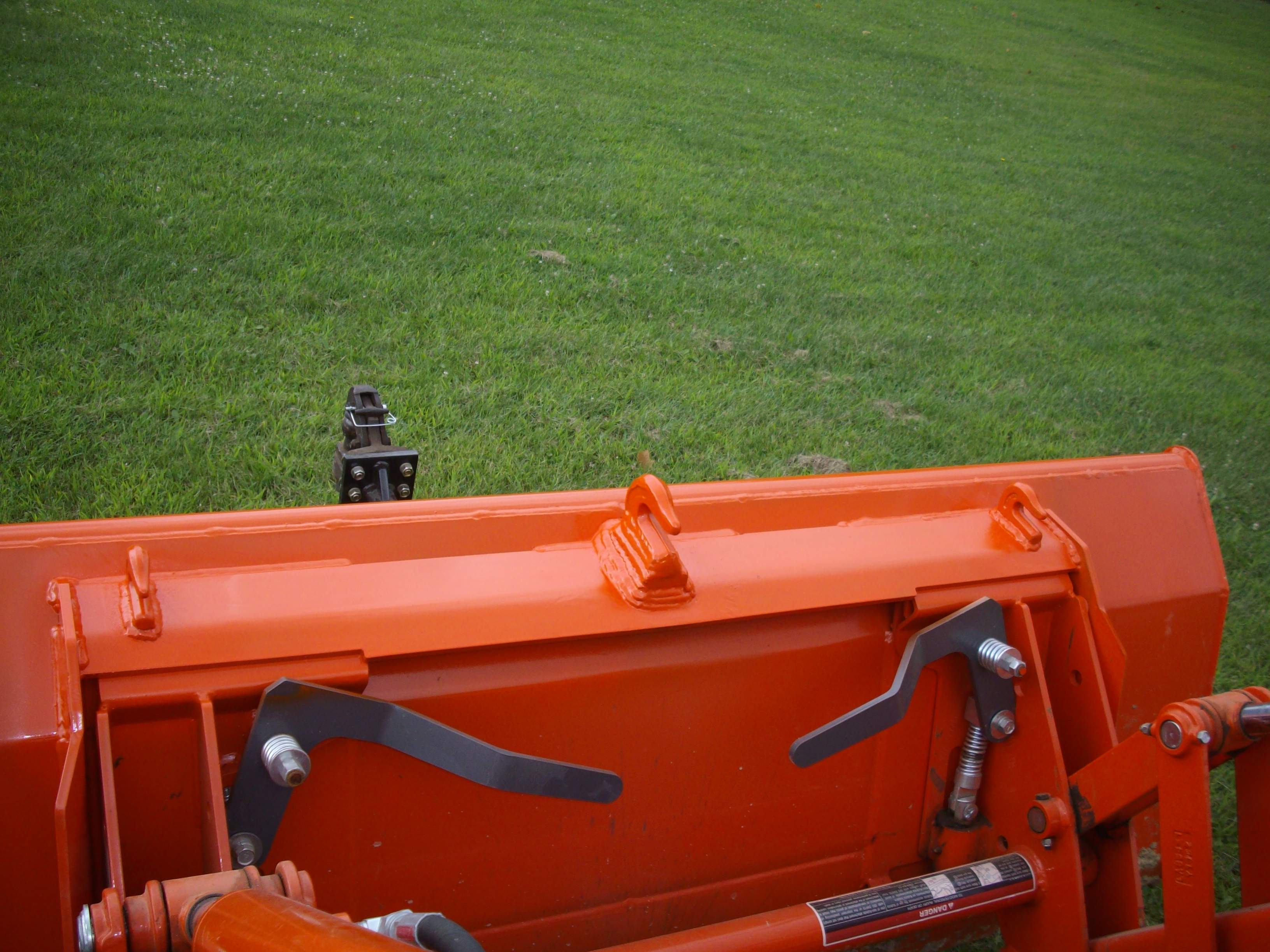

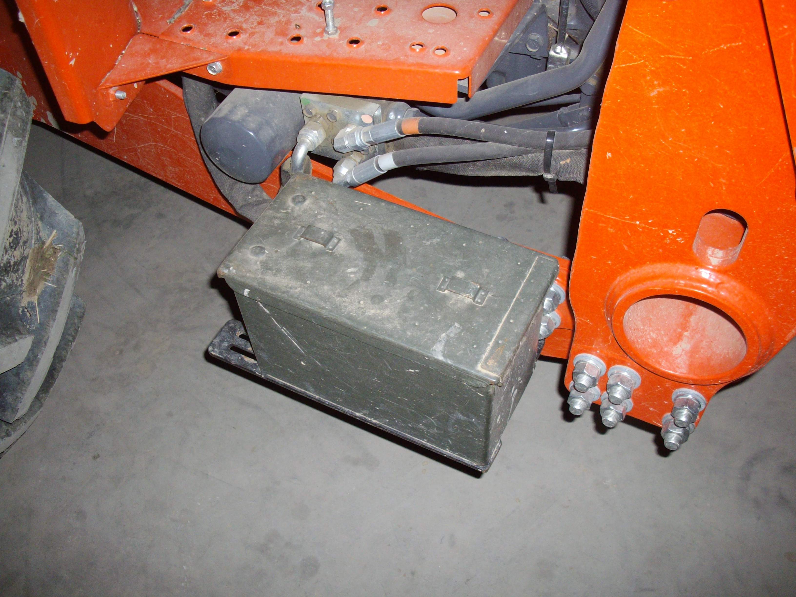

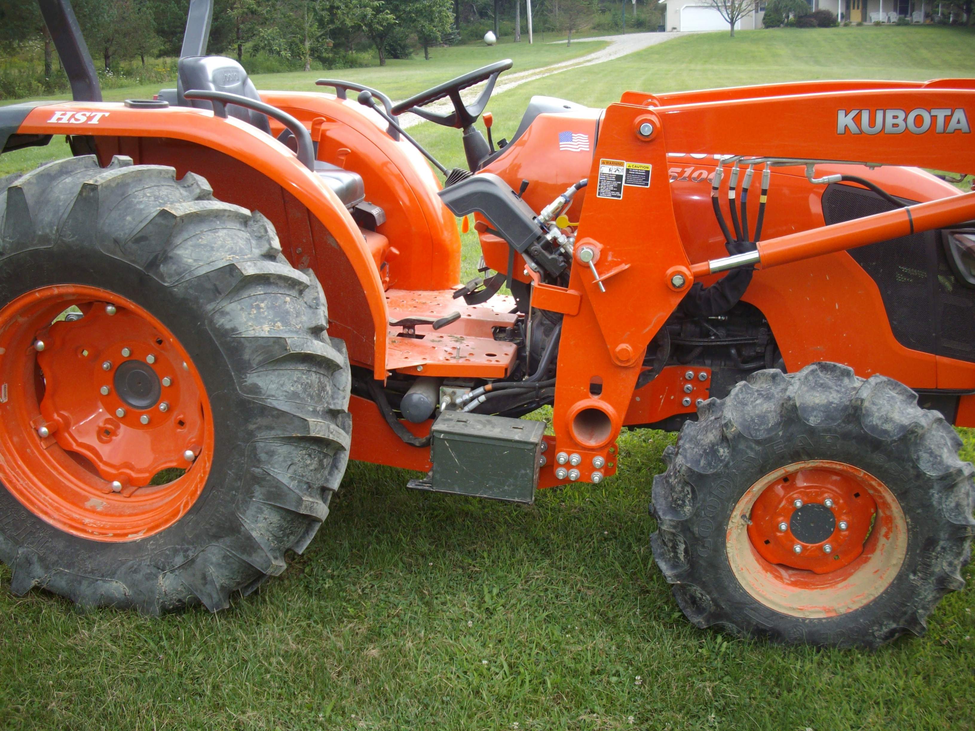

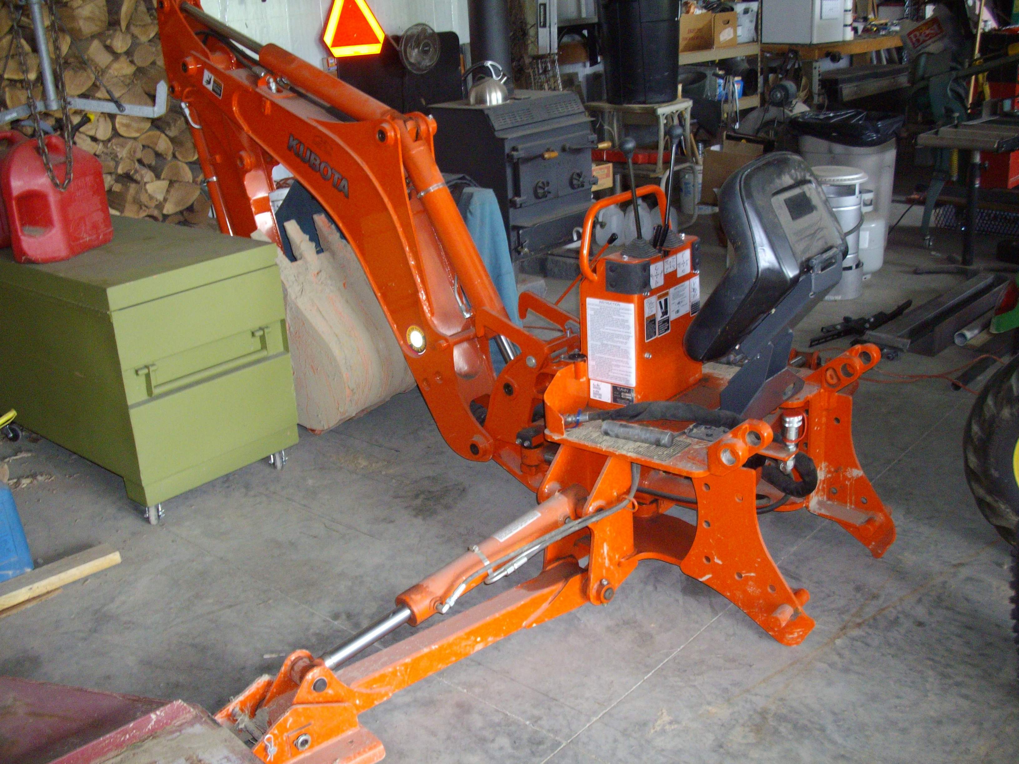

Ammo can tool box, 3 point trailer hitch, bucket hooks, clamp on pallet forks, clamp on trailer hitch.

Could you post a better pic of how you mounted the ammo can? I just got one from work, like to see how you mounted yours. Mounting mine on the fender might be my only option.
I would be afraid of bending the cutting edge of the bucket with the pintle hitch sticking out so far. Will put a lot of leverage on it.
   / A few projects for the MX5100
The ammo can is mounted to a bracket bolted onto the frame. The bracket is from another piece of equipment.
The hitch is only supporting a max of 200 lbs. of tongue weight....I use it to move my trailers around.

That 3pt trailer hitch fabbed from a drawbar is clever. Is the square-tube riser all custom, or did you re-purpose a commercially available hitch accessory?
The vertical sqare tube is a longer hitch tube..
Two pieces of hitch tube, 5" piece of angle iron and some 2" flat steel.
