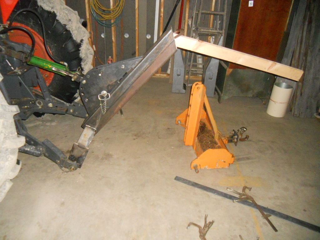

Well today I got the right fittings to "plumb it" to the tractor rear aux. I have 2 motors and both of them spun each direction and the tractor valve even let me "feather" the speed. Didn't end up with a puddle of oil and no crazy hyd noise so that's a good start. One motor has a higher rpm than the other. That surprised me, the bigger, actually bigger around, was faster than the smaller dia. but longer one. Like I said, I'm only learning about motors. What I'm trying to cobb together a small (in capacity) winch that will hopefully have a 4000# pull or so. I guess my best bet without knowing the motor specs is to just assemble it on a suitable pc. of steel and play with the sprocket combinations and put it under load before I attach anything to my "log getter" that I'm building. This is a not so great (early) picture of what I have going on.
