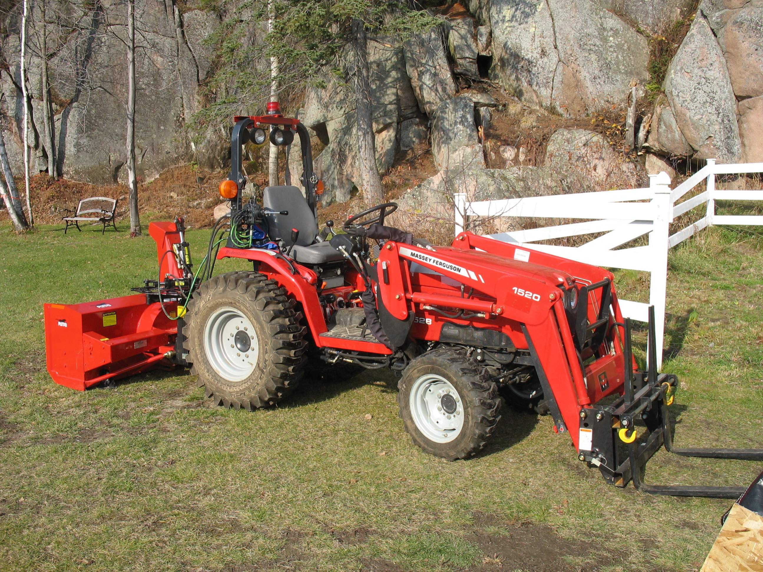

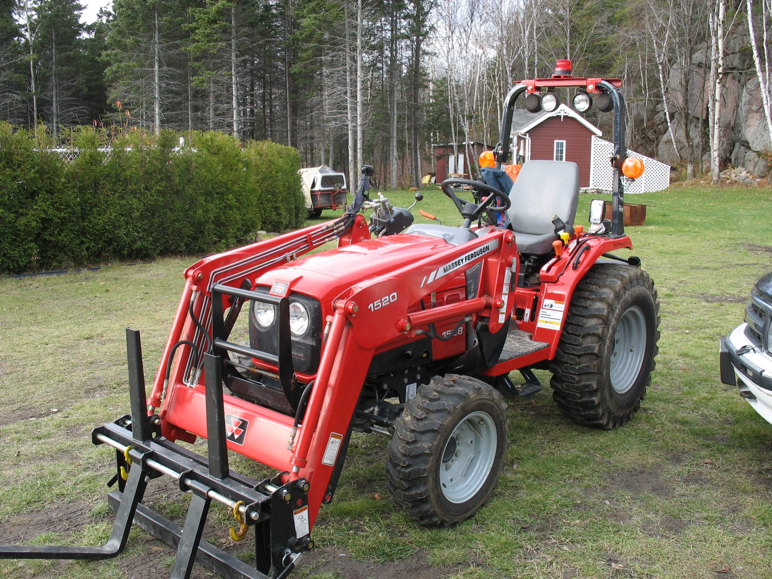

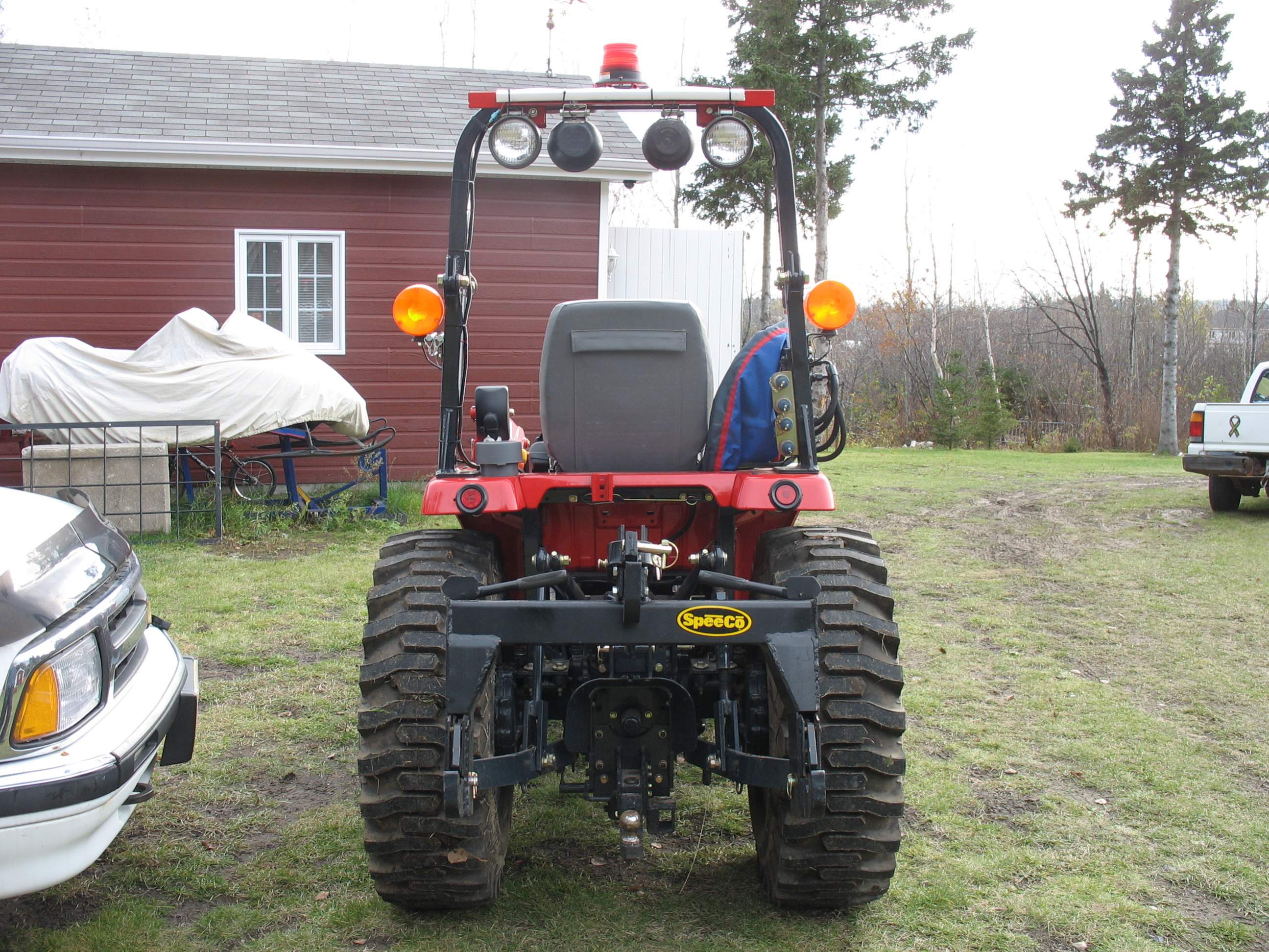

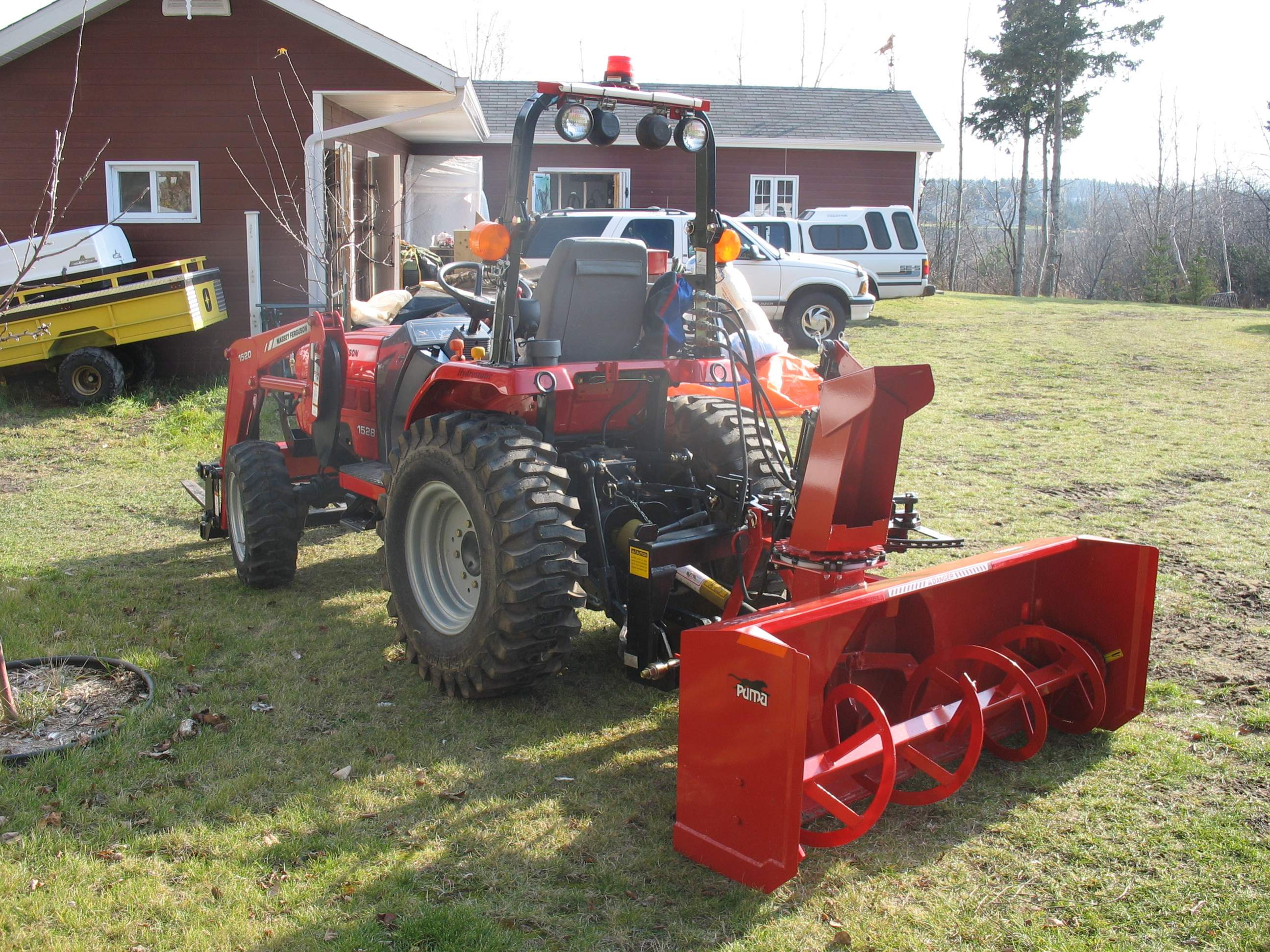

Hey all, finally got around to getting the pics of the few mods I've done so far,
a couple of rear facing worklights, 2 fronts, a strobe, a custom mount, a fuse box, switches, a horn, removable mirror (attached to hydro lines), magnetic mount work light, 12V auxilery outlet, hooks on pallet forks (yellow), changed out the big original lights for some nice fitting LED's, reflective tape on the snowblower, quick hith, and have to install 12V power with quick connects to the rear to mount the winch (10 000lbs champion) and weld up the mount (receiver)....
So coming along slowly!!

Nice forks! Who makes that set-up? What sort of LED headlights did you use; how do they work? Lower amp draw?
   / A few mods done to the Massey...finally!
Thanx irvingj. Oops yeah I didn`t change out the head lights, it was the taillights, my massey came with some big round didn't fit with the tractor at all tailights, so I got a set of marker lights from Princess auto. The forks came from the massey dealer.

Nice ! Is your aux. valve a joystick for up/down, left/right on the blower? Do you have any better pics of it?
   / A few mods done to the Massey...finally! #5
I think you need a little dog with a bouncing head sitting behind the seat. Seriously, looks great. Is that where they usually put the rear remotes or did you tell them where you wanted them? Or did you put them in yourself?
   / A few mods done to the Massey...finally! #6
Sounds like you've been busy. Nice set up and great lookin tractor. :cool:
Thx all for the encouragement. Yes the aux hydro for rear is a joystick type, it was installed at the dealer, If I remeber right it was close to 700$ cheaper than the originals, of course not as clean looking than originals but I needed the money to buy a few implements! I'll try to get better pics of them! Actually they never told me that they would be going there when they delivered the tractor the guy told me that it was the first time he ever saw that type of set up on a cut! I must say thoug that there is a probleme with the remotes, they are supposed to come and fix it soon.............I hope, they've known of the problem for over two months now and I have called them three times but still no show, the problem is that you can only just barely move the joy stick for them to work, if you move it to much it don't work and also the movement is very slow, he thought that it might need another return line or something like that, all I hope that it is not damaging my system right now, cause I do have to use the tractor!!
For the power supply to the lights question, all I did was run a 8ga wire from the battery to a 6 fuse, fuse box and put each accessory on it's own fuse.
