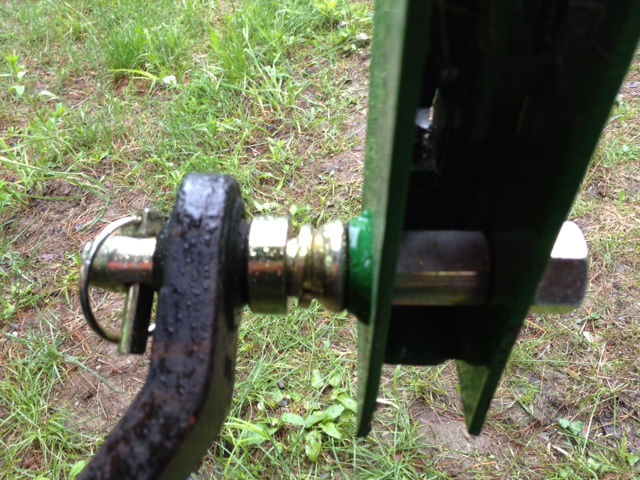

3 1/2" offset to imatch helps makes rc2060 track the way I like

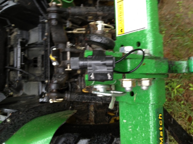

Laser pointer on Imatch projects dot on inside front of canopy, really useful for setting 3 point back to the same place when running cutter - I look back less.

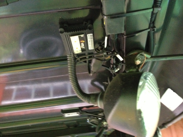

4 HID lights on canopy - plastic housings from sloan express, replaced bulbs with HID, connected through relay to main light switch - stock headlights are disabled as they seem only to shine on my bucket and blind me.
Well, umm... with a laser pointed right at you, I wouldn't want to look back at all. Doesn't that concern you???? Just doesn't seem safe for your eyes.
