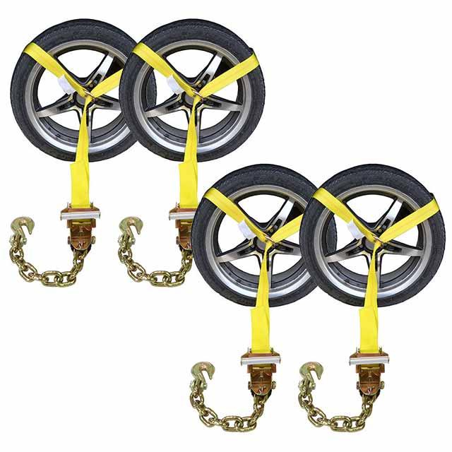

1) I found these "Wheel Nets" that are essentialy ratchet straps that go around the top 1/3 of the tires and ratchet to stake pockets or other suitable outside tiedown spots on the trailer. Has anyone used these to haul their CUT? Why would they not work? They have a load capacity of 3,333 lbs each, so four would give me 13,332 lbs of working load capacity.
Edit: These straps are 10' long, with a ring on one end that the loose end loops through, which would then allow it to adjust to any size tire, as long as you have enough strap to get to the ratchet/tiedown point. So the same strap could be used for both the smaller front tire and the substantially larger rear tire. The strap then goes into the ratchet, which on the ones I bought have 18" of 5/16" (I think?) chain and grab hook to secure to the trailer.

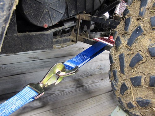

2) In the same vane, I also found these axle straps. Wrap them around the axles (in my case the rear of the tractor has been the real problem area for finding a suitable tiedown solution) and use ratchet straps or chains to secure the car or machine to the trailer. They have the same 3,333 lbs load limit, for a total capacity of 13,332 lbs.

I think those wheel nets are for a specific size tire. So be sure to check for that.
I don't like wrapping straps around anything. They can chafe and cut with vibration. I'd use chains/hooks at the attachment points.
Can't help you with the Ford hooks..... I'm a Chevy guy! :p
   / A couple of "strange" towing/tie down questions
Thanks for the input. I went back and edited my original post to include this, but the straps are 10 feet long with a welded loop on one end that you run the loose end of the strap through. So it can be infinitely adjustable as long as you have enough strap to get back to the ratchet/tiedown point. And the axle straps have reinforced jacket to help with the rubbing issue, but I am with you on the chaffing issue. At the same time, I did not want to run a chain around my axle to scratch the heck out of it, either, though.

those wheel nets would be fine; they are a staple of the car hauling industry. straps are made to be wrapped around things and not disintegrate at the worst times. mine have a protective fabric sleeve over most of the length of the strap that protects the actual strap while it is wrapped around something
   / A couple of "strange" towing/tie down questions #9
I took an old fire hose and made some protective sleeves to go on my straps.

One thought. Axle straps often won稚 work on cars or trucks some times there are brake lines or something that would get crushed.
