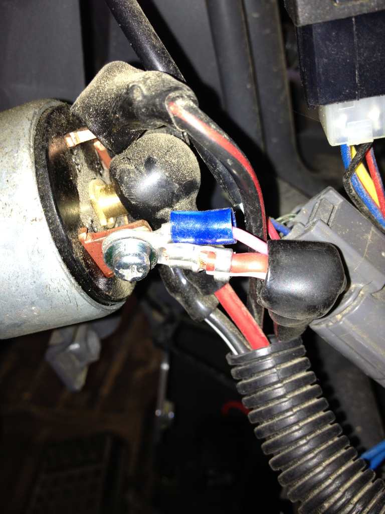

I've been planning out some mods for a while now and have finally started and have a few installed. Front and rear work lights, a 12 volt power outlet, some gauges, a permanent plug for my sprayer and on and on. Anyway all these things require power and I don't like to tap all that off the battery with inline fuses and such, so I bought a painless wiring fuse block, it is weatherproof with 4 ignition hot circuits and 3 constant hot circuits. Getting it installed wasn't too bad once the plastic cowling/trim was pulled from around the steering column. I mounted it about the same height as the factory fuse block but on the other side of the steering column, a small amount of trimming was required to the plastic trim to get it to fit around the relay on the fuse block.
To power the relay a ignition hot source is needed, since the key is so close I tapped on there. I ended up changing it after this picture and put the two wires together in one ring terminal but I forgot to take a picture.

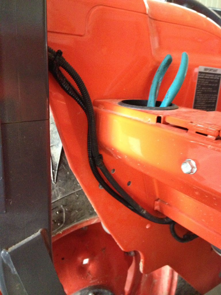

The wiring from the front lights is ran through the ROPS and then along factory wiring to the switches. This picture with the seat removed shows how I ran the wiring along factory wiring.

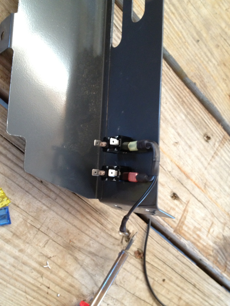

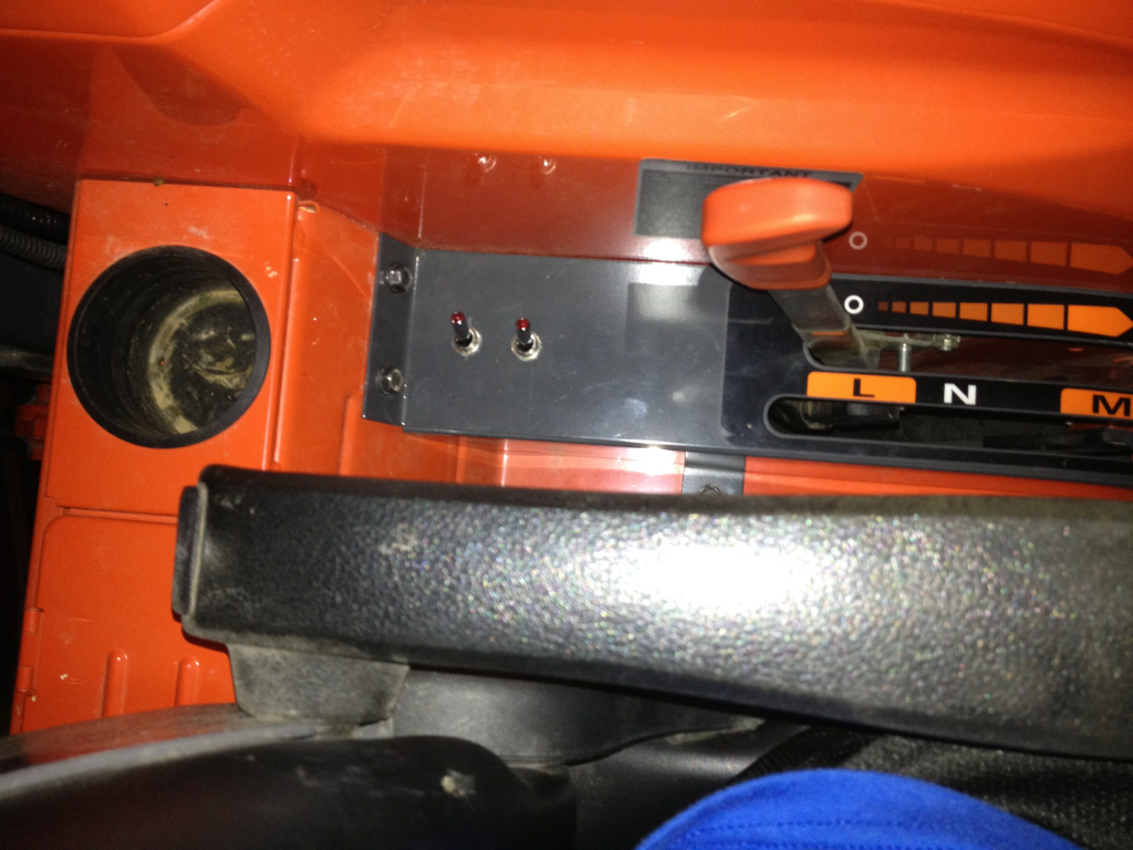

I wanted to get a factory looking switch that matched the switch for the hazard lights but i couldn't find anything, so i went with toggle switches mounted by the range and cruise levers. I need to take a picture of the switches installed tomorrow also, but this picture shows the under side of the switches as I was wiring them.

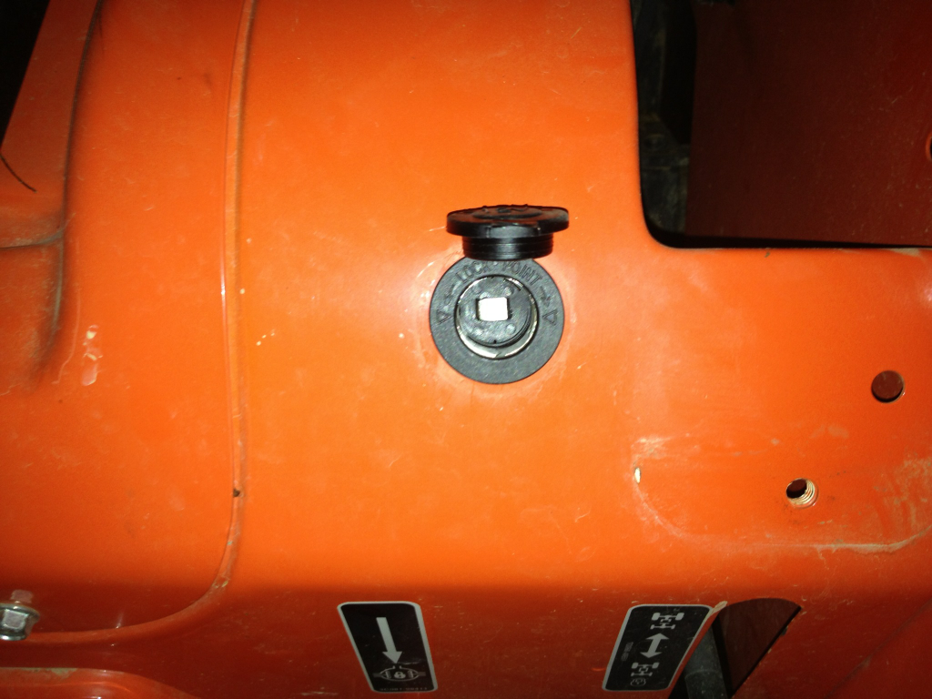

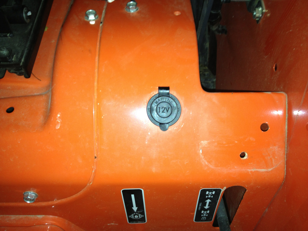

Trying to find a good place for the 12 volt plug was tough since I wanted it near the fender but didn't want it to look out of place. Just to the left of the seat is a rubber grommet plugging a hole about 1" diameter, it just happens that it is the perfect size for the 12 volt plug. So this is where it's at for now, once I get my phone mount and get it set up and the phone charger connect we'll see if it will work but for now I am happy with it.

Here are a couple pictures that show the rear lights and the switches.
