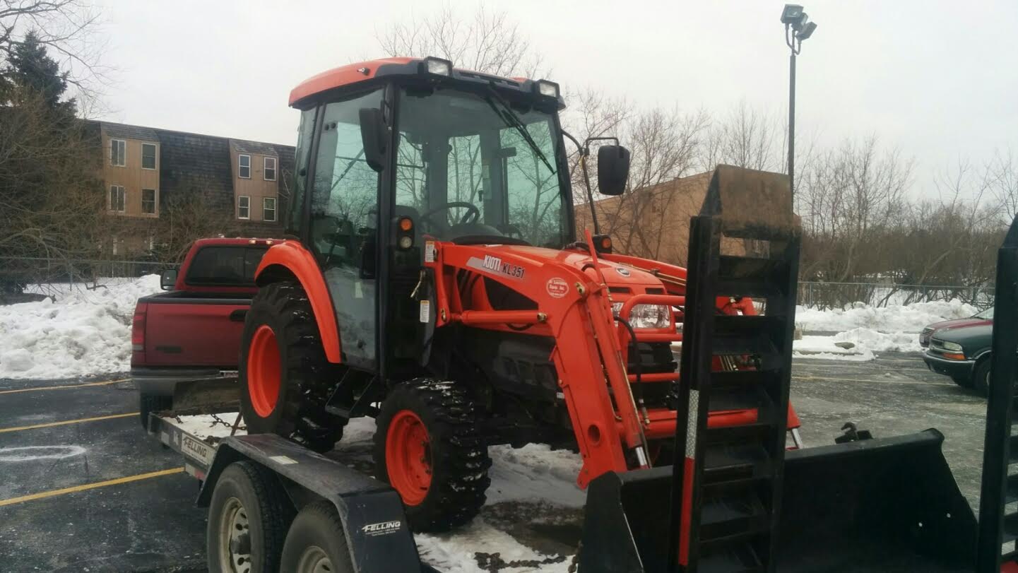

Thanks everyone for your help, picked up the tractor this morning, started and runs fine, and DOES have AC as suspected. Looking forward to playing with our new toy, although unfortunately will have to order an operators manual as it was missing, and I can't see to find much online. Very happy with what we got considering the price was half the price of a Deere/Kubota of the same caliber in these parts. Thanks again!dk35se.jpg

By the picture, nice looking tractor and gently used. I hope you enjoy the new toy and have many flawless hours. I hope they could advise on the routine service done so you know where to take over. At @400-450 hours, but that depends on how service was done by them, it should have engine oil and filter, both hydro and hydraulic filters with oil, fuel filter, check and change if needed air filter, front axle oil change, along with the normal grease, check loader mounting bolts.
   / A/C standard with DK35SE factory cab?
Thanks for the advice, there is thankfully a sticker on the steering column noting the last service ~30 hours ago, have a call in to that dealer to get more specifics as to what they did, but based on the tag it looks like the 400hr hydro service has been completed. Thanks again everyone, can't wait for the snow to fall now that we have a better way to deal with it!
