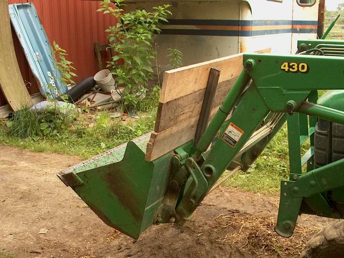

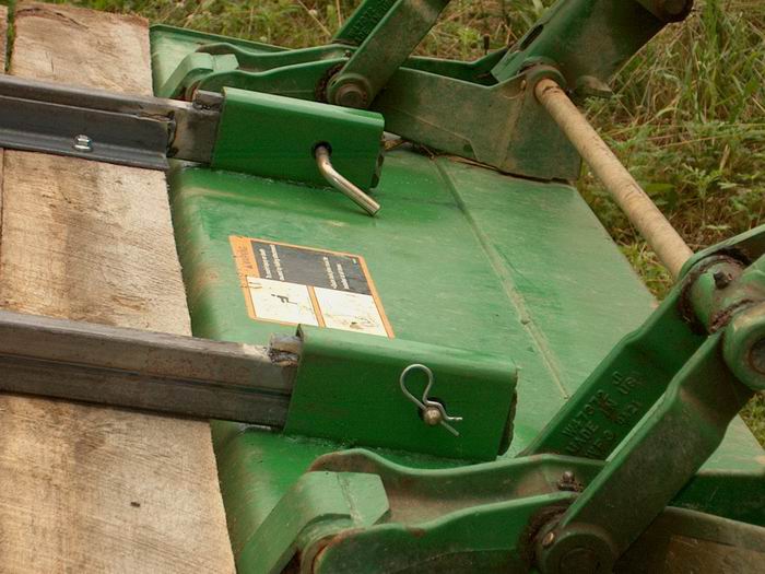

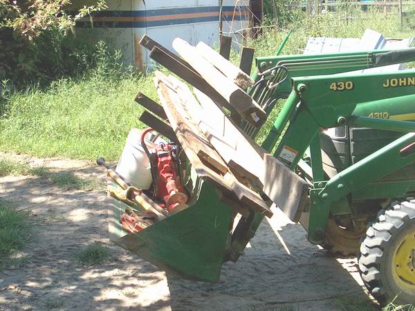

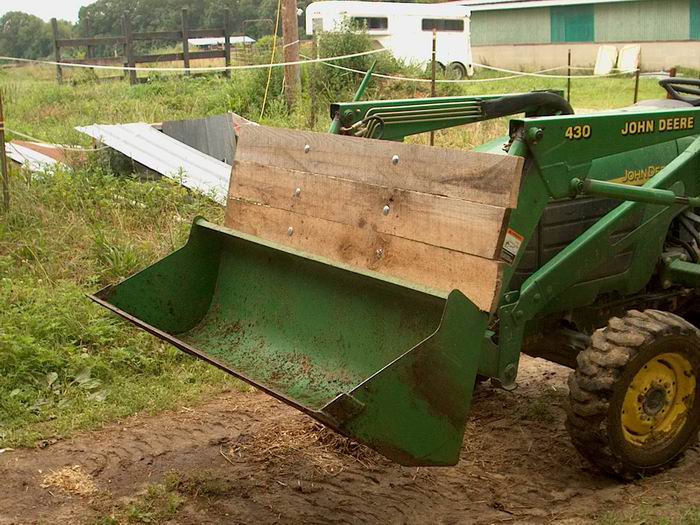

this is my solution

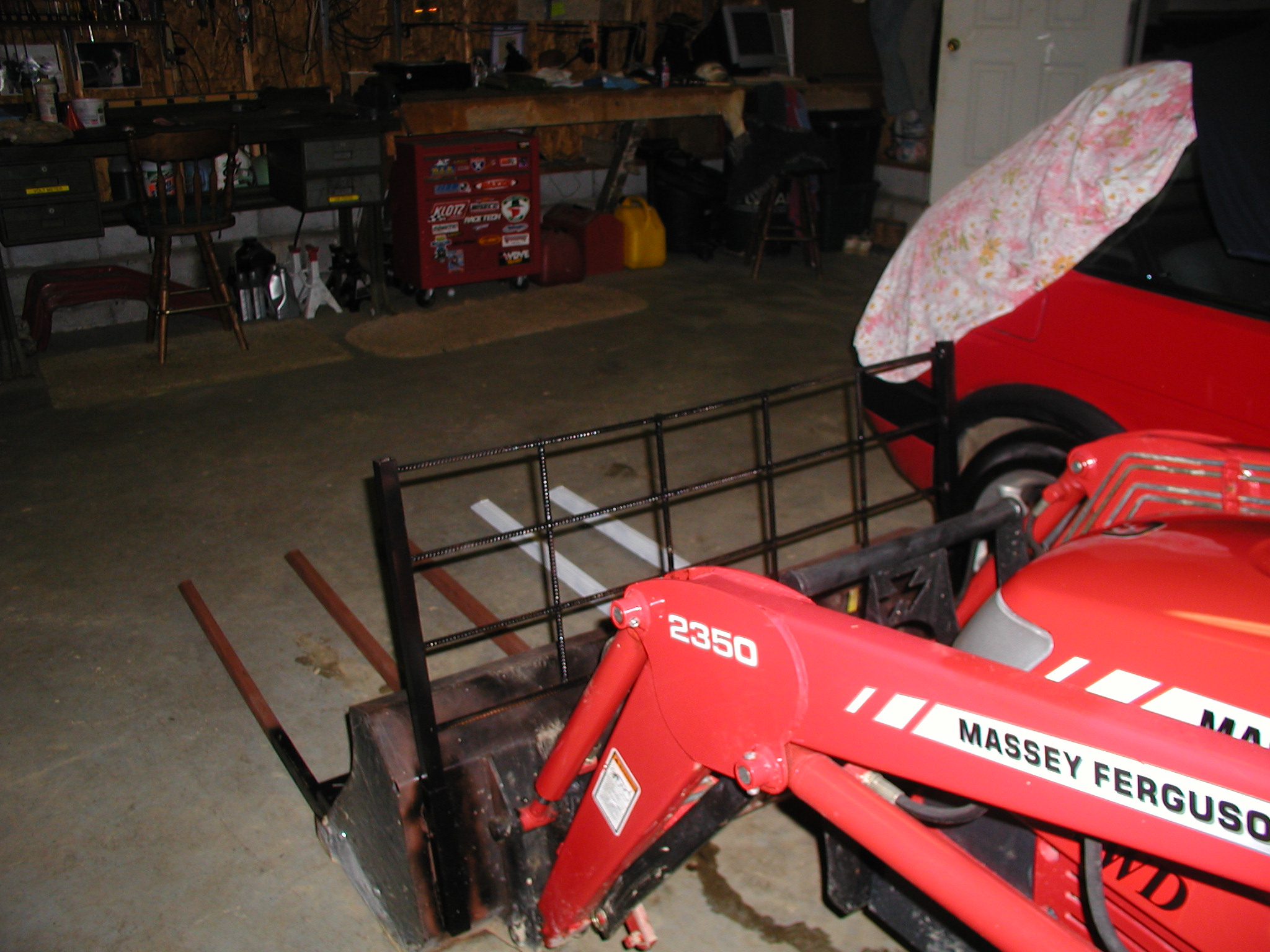

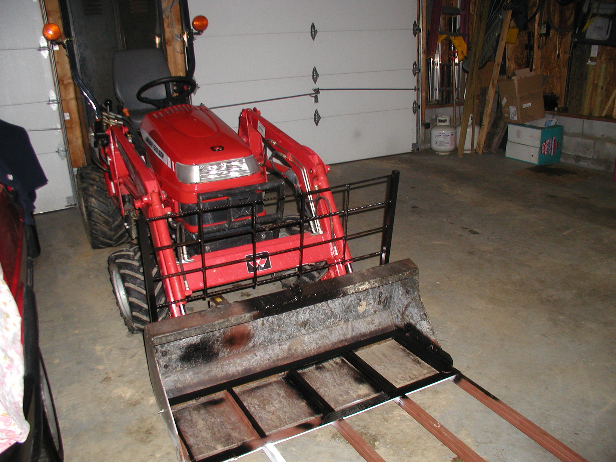

Wyld Bill,
Here is what I just finished finished building last weekend. (Backstop & Brushforks) Still need to finish painting (ran out of paint).
The backstop ends are 1" square tube that slide into 1 1/4" square tube that I welded to the back of the bucket. I drilled a hole and used a bolt to hold it on. Its light enough and easy to remove. I originaly designed it to keep firewood from crashing down on the hood. If I need protection from smaller stuff I guess I can attach some chicken fence to it.
Ray
