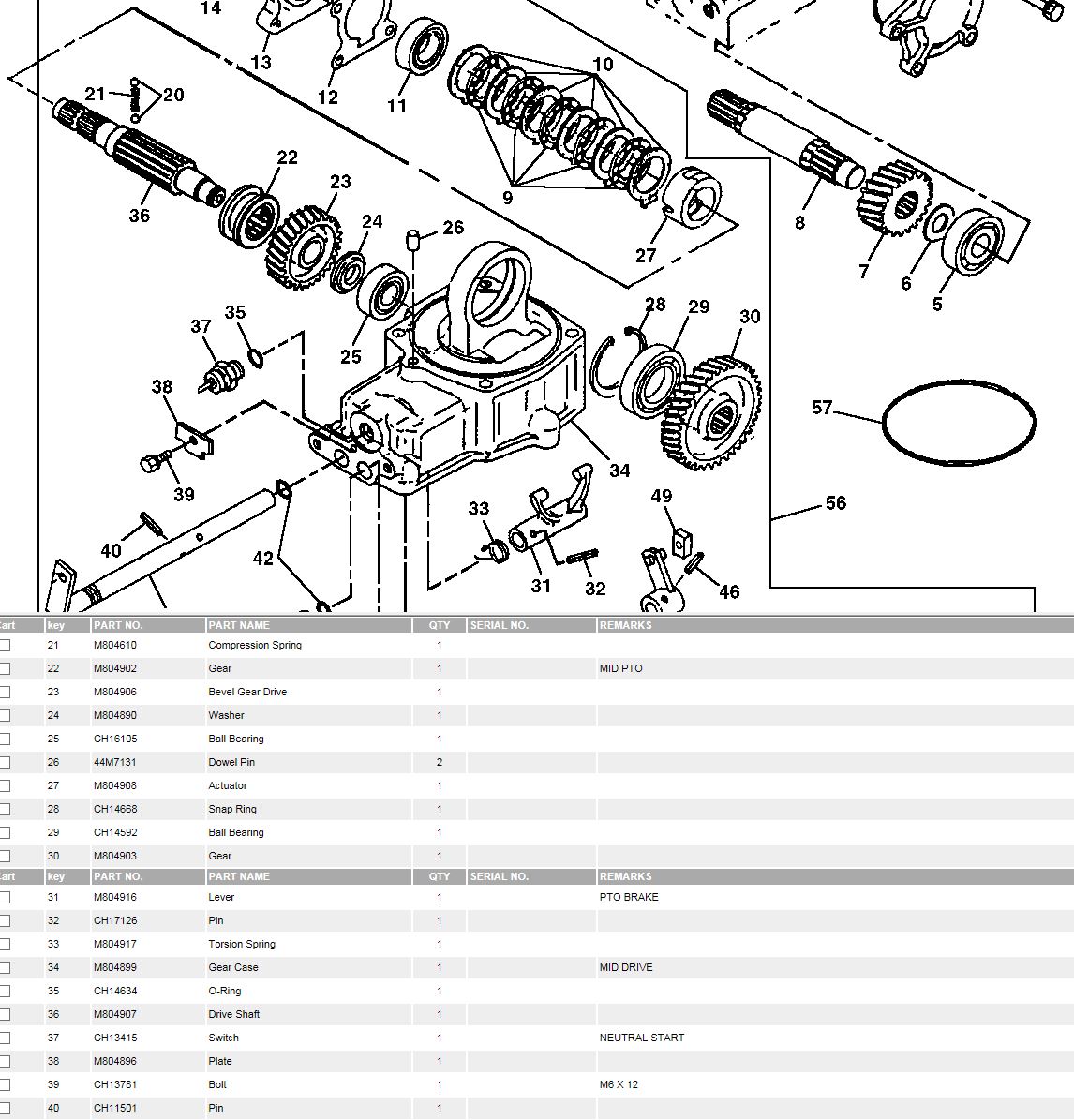

Hi Gang,
I ordered a service manual but it has not arrived yet and I need a part number. I am installing a mid PTO and my kit came without the safety cutoff switch. Would it be possible for someone to tell me what the john Deere part number is? I am not confident my dealer will be able to find it for me and I would like to go in prepared tomorrow morning. Thanks in advance!
Joe
   / 970 mid PTO safety cutoff switch part number needed #2
CH13415 Neutral Start Switch. Look on johndeere.com go to residential, parts, search for parts and type in 970 for the model. Then you can look at all the stuff your tractor has in it or needs later.

Or zz, have him go directly to jdparts.com. Seems shorter than finding the same through the maze at johndeere.com.
jdparts.com is free registration.
