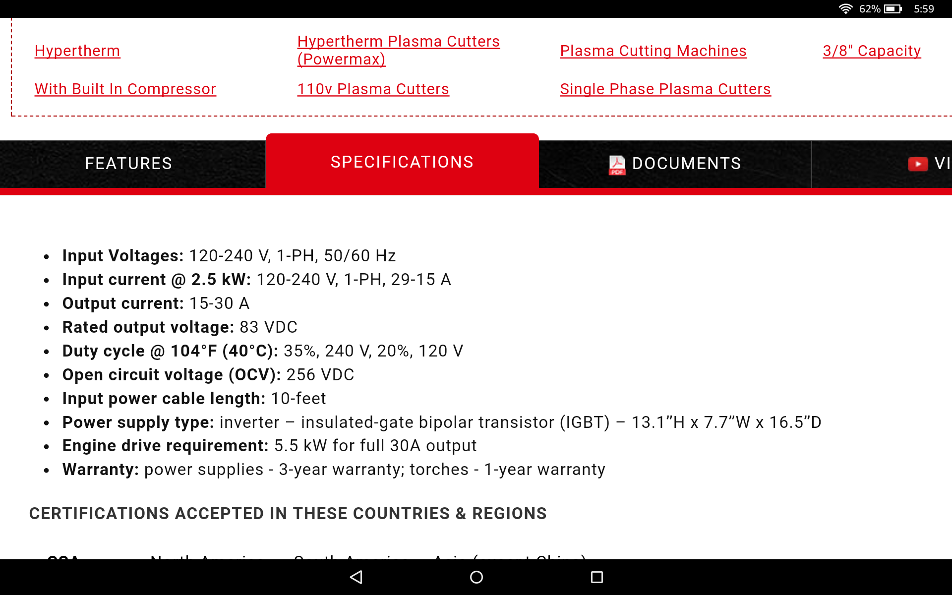

Will the bobcat 225 run a 30air.
It runs my hobart 180 well. Trying to do alittle research before i buy. I have 220 in my shop but want the plaz portable.
Thanks for any advice.

My 225 bobcat was made in 05 or so. I run my hypertherm powermax 600 on it a lot. It pulls everything the bobcat has but it's never tripped a breaker.

I Googled the machine, says it draws about 3,500 watts.
Specs for engine drive use says recommended 5,500 watts to get max output.

I run a Hypertherm 30XP and a stand alone compressor off a bobcat 225 all the time at it works fine. I had a helper cutting with the plasma cutter and I was trying to run a grinder and that exceeded the generator limit.
