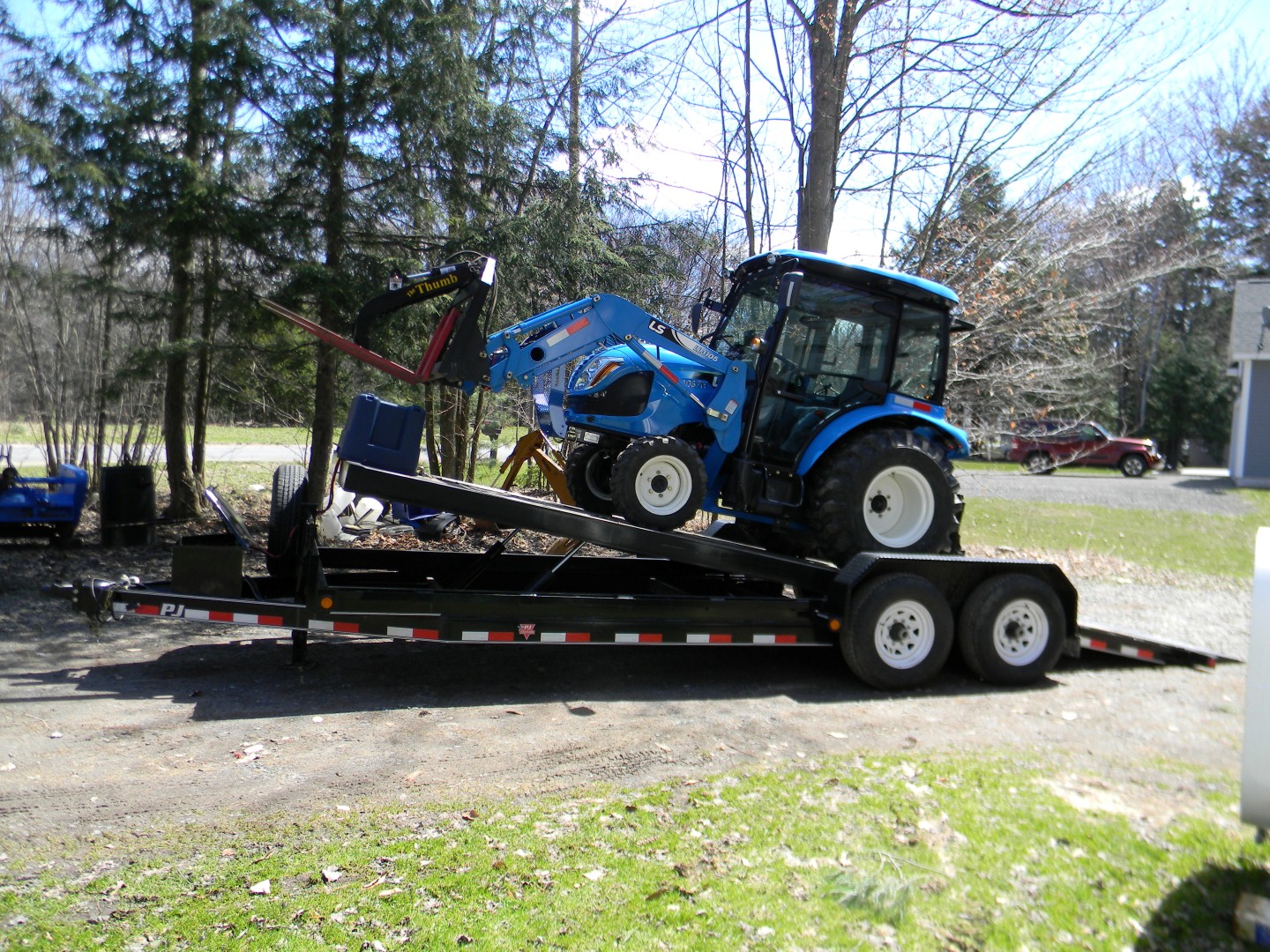

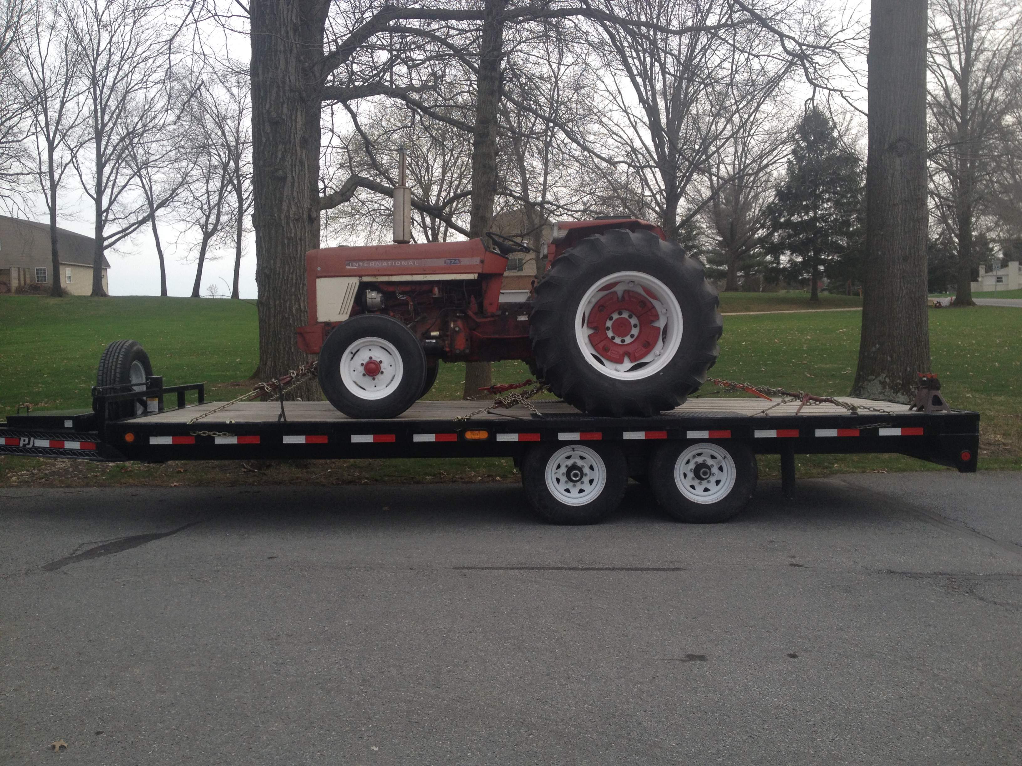

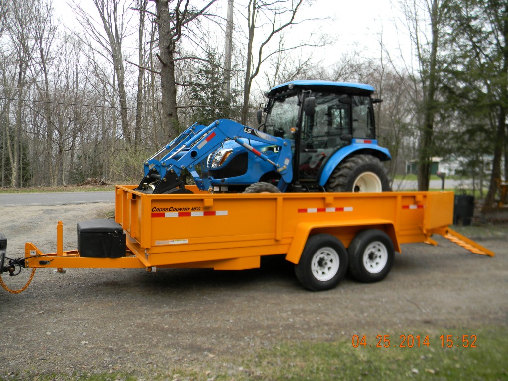

I have the PJ 22' BP full tilt rated at 14K. Weighs about 3800 lb. empty.
They have tilt decks in BP and goose neck with stationary section in front and are available with 3 - 7K axles. Also available are deck over tilts.
My 14K dump trailer is also 16' made by Cross Country Trailer.
