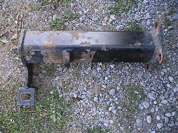

Hello - I found myself a nice 430 loader, but my local dealer informed the attachment brackets to make it work are over $1100.00....ouch.:(..I have looked at the parts diagram and the brackets seem pretty basic.
One of my friends is a structural welder and says it would be pretty easy to replicate the brackets if he could get some good pictures and accurate dimesions....sssooooo.....is there anyone with a 420 or 430 loader on their 955/855 who is able to provide me the pics and dimensions?

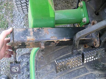

I have a set of brackets that came with my tractor when i bought it used. It just had a 300x loader installed before I got it but came with the mounts from the old loader (maybe a 420). The tractor is a 2001 4300. I will look for a pic of the mounts and post it. If you can check to see if they will fit your application. You never know who might have what you need!
/ 955 - Looking to add a 430 loader #3
here are some pics of the brackets

Thank you. Looking at JDparts.com, the 4300 uses a different mounting system then my 955 for the 420/430 loaders. Unfortunately, I may have to suck it up and buy atleast one side from JD and use it to make the other. Thanks again...
/ 955 - Looking to add a 430 loader #5
Do you think it is just the mounting flange where it bolts to the tractor? It would be very easy to cut off and weld on a new flange with the correct bolt pattern. You can have these for free if you think they would be of use to you. I am in Ontario but run a car hauler truck into OH, MI, PA, NY quite frequently if that helps. Also know other truck drivers that may be helpfull.:thumbsup:
You might be onto something, i need to add a tube (not bolted on a 955), but I might be able to wrk with that. I live in southern New Hampshire....do your trucking friends come my way?
Thanks again!
