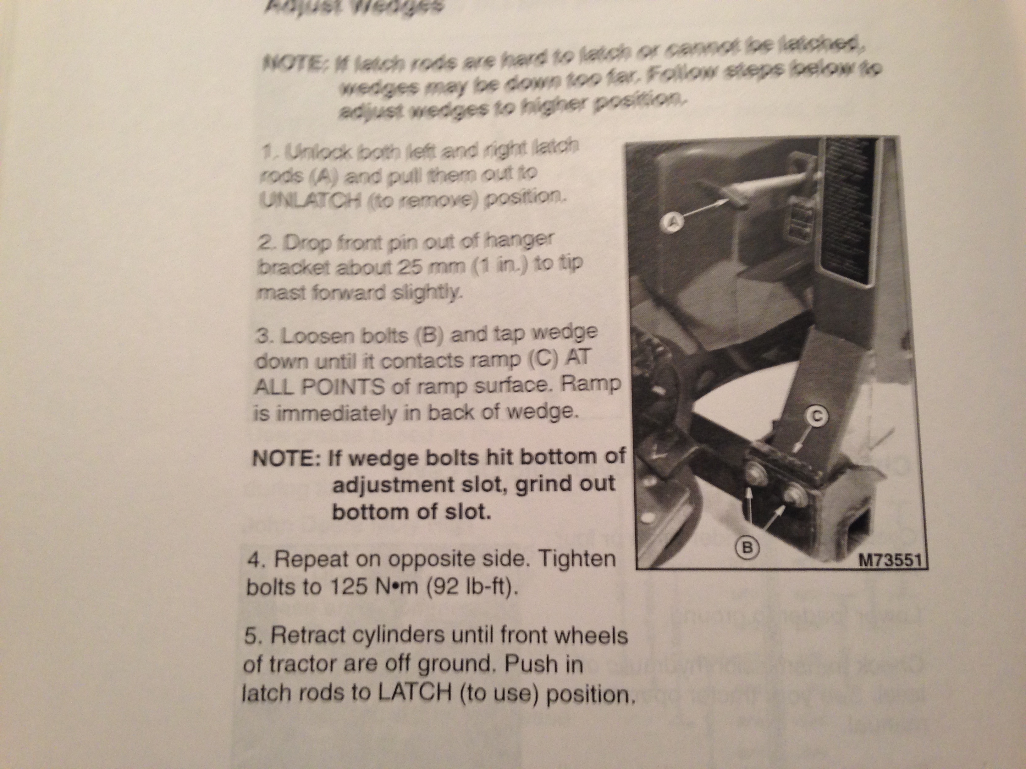

I attempted to lower the wedge on the mounting bracket, because it was as high as it could go, and lowering it made the problem far worse!!!
Any ideas on what I should do or check? Thanks,

Did you read Adjust Wedges on page 30 of your manual OM120877 - Operator's Manual 60, 70 & 70A Loaders?
   / 955 Deere 70A loader wedge.... left loader arm popping out of wedge
I wish. I don't have the Loader manual. Would you post a picture of the instructions for me?
   / 955 Deere 70A loader wedge.... left loader arm popping out of wedge #5
Here you go...
Well, I had to take out the Dewalt Sawzall, a 1/2" drill bit and nearly take the loader off to get access for the sawzall. After i measured, I cut a little extra. Then I got everything flat, and pounded the wedge in as far as it would go.
OH MY GOODNESS. This feels like a new tractor with this loader tight. Thanks Rara Avis for the picture. Have a happy Fourth of July.
