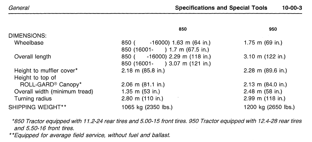

Can anyone give me the height of a 950 John Deere WITH ROPS ?.
The tractor will need to be loaded in a box type trailer. I need the height from the ground to the top of the ROPS.
THE TRACTOR is a 1986 w/ mfwd, has 12. 2. 28" Ag. tires. I'm not sure how high the trailer door is, as the trailer is not available at the moment, but think it should be just
under 7 foot.

Attachment is from the 950 service manual. Says 84 inches, but also that the muffler is 89.6 inches. That could be the bigger problem.

THANKS FOR THE DIMENSIONS:
The trailer became available and it has a door opening of 79" . According to the dimensions you
provided the tractor is 84" , with a difference of 5 " ..
If I let out the air in all the tires it should barely make it, I hope . The muffler pipe is not a problem it has
a clamp which will allow it to be taken off.
Thanks for the information.
