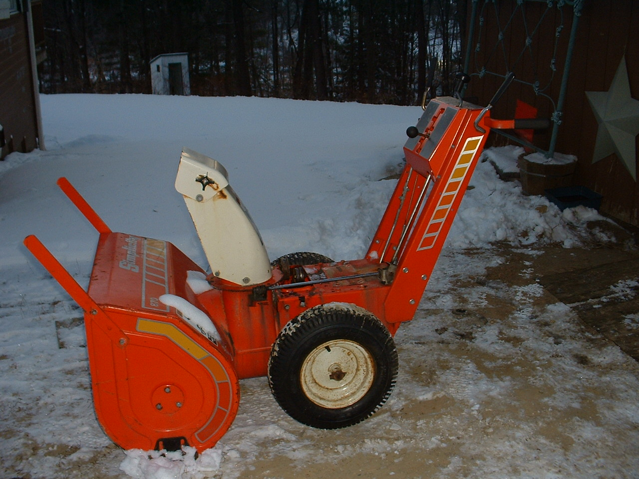

Hi everbody, I recently got my hands on a very nice early 80's Simplicity 870 snowblower with a Techumseh HM-80 in need of a little TLC. I have already repaired/adjusted everything needing attention on the chassis and then started on the motor. I rebuilt/cleaned the carb with new needles and gaskets, cleaned the fuel tank, replaced the fuel line and installed a fuel filter, changed the plug,etc., etc. and of course it still wont run as it should. If I have both the main and the idle jets backed way out it will run at very rough high idle but backfires through the carb or the muffler depending on how the needles are adjusted-I am out of ideas here and could use some help.....Thanks in advance, Rick

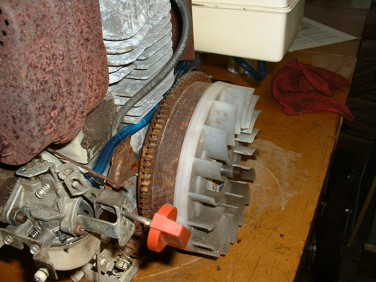

Thanks to all for the quick responses. I removed the motor from the snowblower, brought it into the shop where I removed the recoil and the shroud with the intention of popping off the flywheel to work on the points and condenser. Apparently Tecumseh uses a plastic fan assy. that I am not at all familiar with - do I remove this plastic piece to access the holes for the puller? How does this come off without damaging it? It would appear that it just snaps into a groove machined the outer edge of the flywheel, no? Again all help is appreciated, Thanks, Rick

   / 9 Horse Tecumseh kicking my a$# #6
If all else fails take 2 large screwdrivers and put pressure on each side of the flywheel. Put the large nut back on and smack it with a large rubber or plastic hammer. ( Or as my English friend says "address it smartly").
In my experience the flywheel will pop loose.
Little update...Got the flywheel off, purchased replacement points and condensor, was turning the crank through by hand (with the plug out) and it felt as though it was binding for like an eighth of a revolution so now must investigate this......awesome. Its a series 3 carb and you can see it pretty well in an above pic. I was informed about that miniscule passage and believe I have that cleaned out too...Rick
