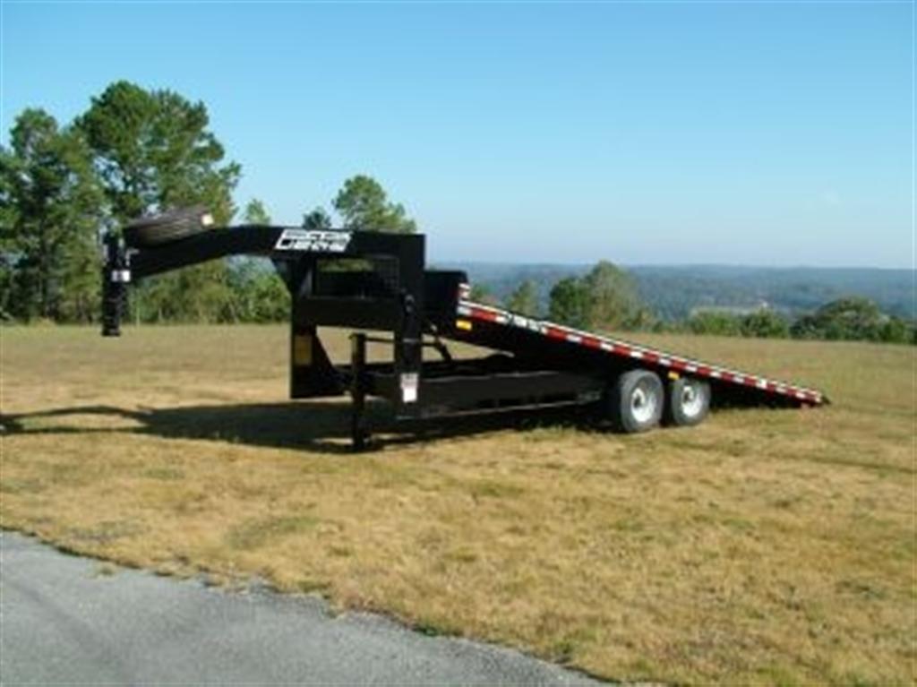

Anyone have experience with this trailer tire on an equipment trailer? I am looking for a GN tilt trailer and saw it on a 8 hole rim, not a mobile home rim.

Looks like the axles are too far forward to pull good.

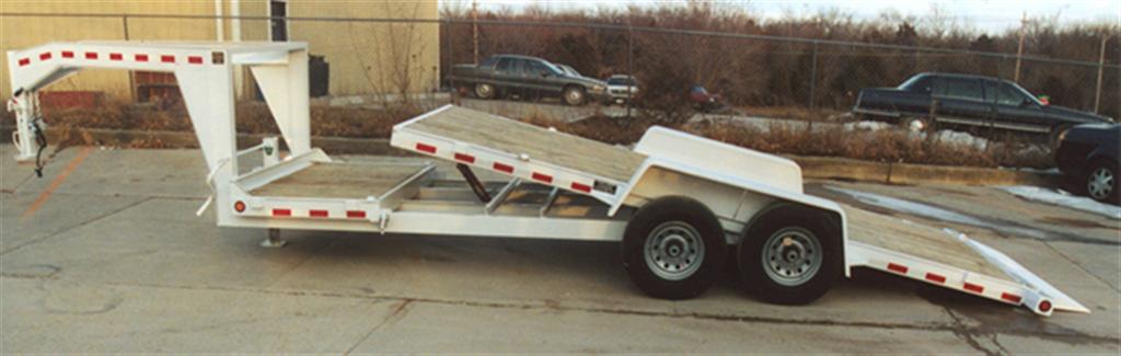

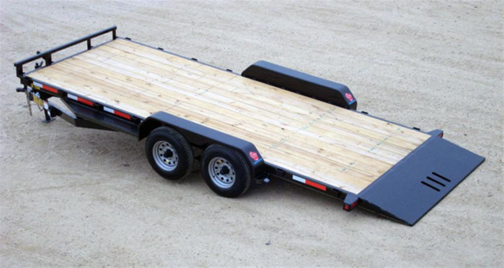

Chris
I think all the tilt trailers have too much deck behind the axles. It would be very easy to load them tail heavy.
