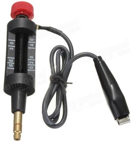

Please pull one of the spark plugs and verify you are getting blue/white sparkies or invest in spark tester shown below that will also provide spark intensity.

Do you have a link showing where that tester can be purchased ? All I can find is the pen type that show if there is a spark, or not. I would prefer one that actually shows how strong the spark is like you posted, but cann,t find it.

Auto craft tester at advance auto parts for 8.99, came up when i googled it.
